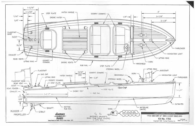

            An image I lifted from the web.
