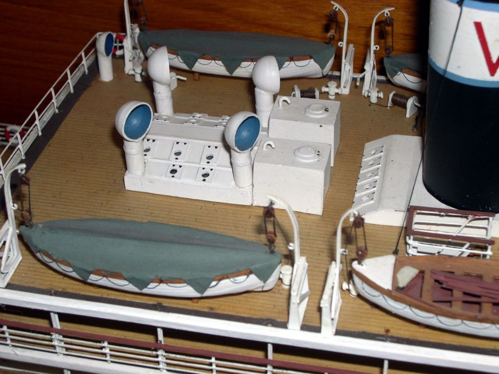

                #24022
                  Hello Ian, Rick and Tony
                  The pictures that used to show the paper planking clearly, have since been wiped off!
                  But, here`s one that shows what I mean……
                  Not bad?……..Bob

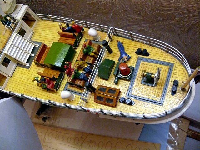

                    #24026
                      Here`s card decking on my Jeanie Deans
                      #24027
                        Very neat Bob, much neater than mine. Just goes to prove that you don’t HAVE to lay the planks individually to get a decent effect.

                            #24038
                              Here`s Jeanie Deans planking.
                              I used this method for the first time on this model…….Couldn`t face the real stuff!

                                  A couple of years ago the old green shed was knocked down which seemed a shame but you can understand that it wasn’t very suitable for a modern business- just sad for nostalgic old buffers like me! As a footnote, although, it’s lovely to see these old boats still in use, we hired a small wooden gaffer  a few years ago and when it rained it leaked like a sieve- not many people understand that this is the nature of the beast and are prepared to put up with it.
                                  Bob, the planking on Jeanie Deans looks tremendous- what’s happened to the chap in the blue boiler suit !? Thanks for putting these photos on- I will have to have a serious think next time I do a deck.

                                  #24059
                                    Thank you for your very kind words…..
                                    The man lying down is mending the winch mechanism.
                                    The figures are Scalex crew!

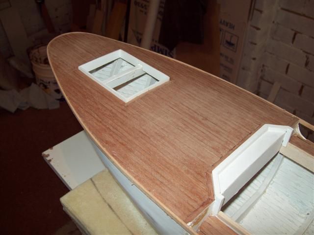

                                            Hi,  I know that is’s a bit late for this post, but I’ve just finished planking the deck of Matilda.
                                            There about 150 bits of veneer stuck down, including the for’d hatch. Next is sanding and varnishing.
                                            The satisfaction is enormous. Next time I might try the paper system.

                                                A very nice deck and one you can be justifiably proud of.  I was reading a book by  Richard Webb recently where he describes a method of painting each edge of the plank before laying  and then sealing it. I think this would be worth trying at some stage- I am in the process of planking a deck and the card method brings all sorts of problems especially around the bits where they are joggled into the margin planks. I worked out that the card I used is probably a bit overscale but I like it!
                                                Like your boat by the way, what is it?

                                                    Thanks Ian, I drew down one edge of each plank with a black felt tip pen to give the caulking effect, at this stage it seems to work.
                                                    It’s  scratch built off a plan I found on the net. I believe the style is a “Mistral” , quite a 1950’s ish gentlemans cruiser.
