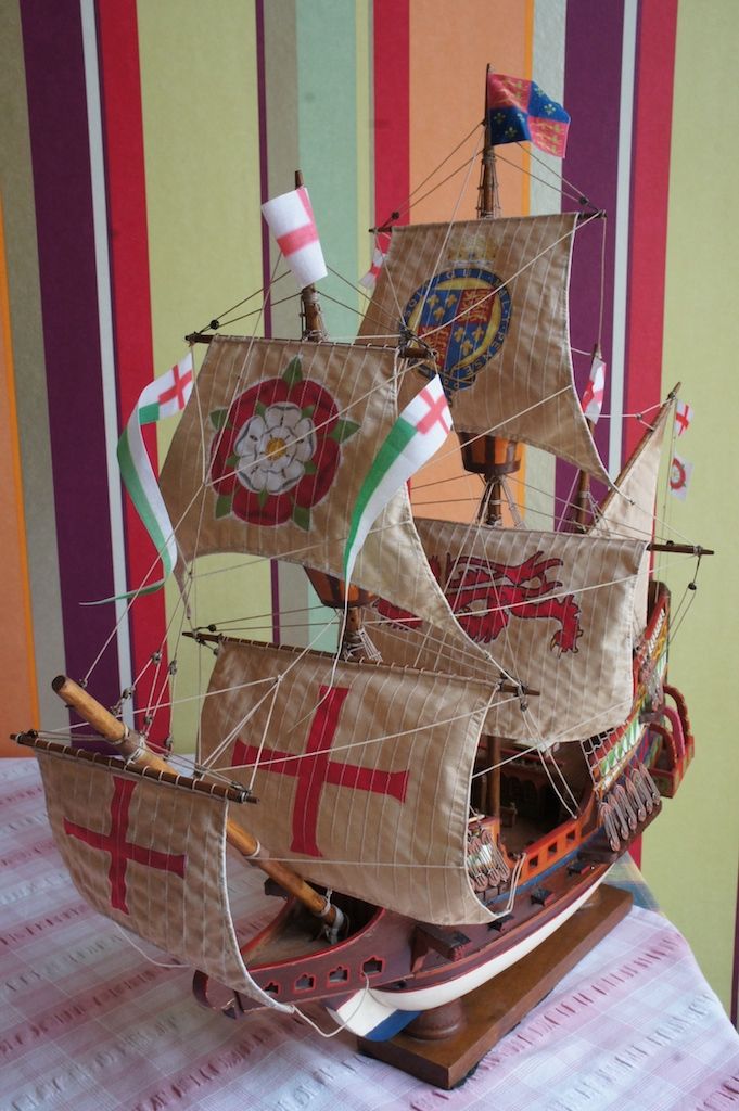

        Here's an example, this is the finished restoration of someones pride and joy passed down from grandparents, all the sails, flags and buntings are copied from the original material that survived, plus a few I added after some research into flags of the period.
        This is the Ark Royal of 1587.

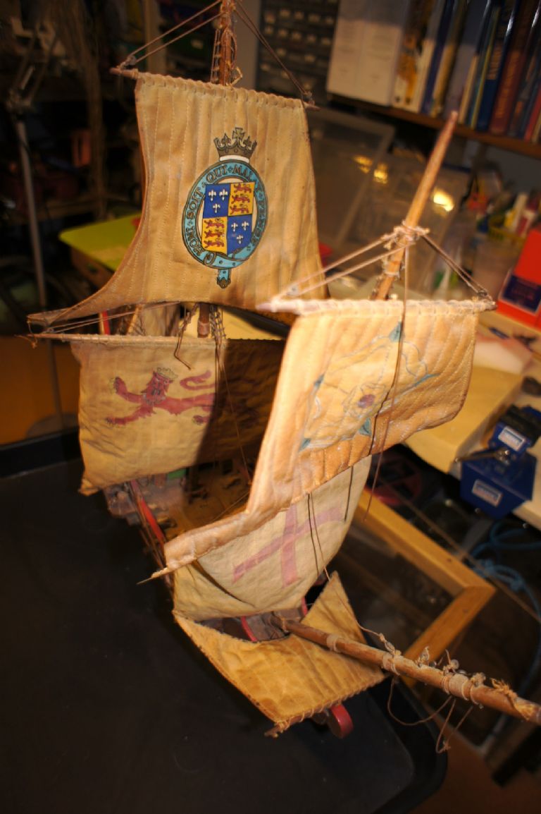

        The sails are printed using a standard inkjet printer onto a material called lawn cotton. I merely had to trace and source suitable images to use for the sails. Here's the original ones as received.

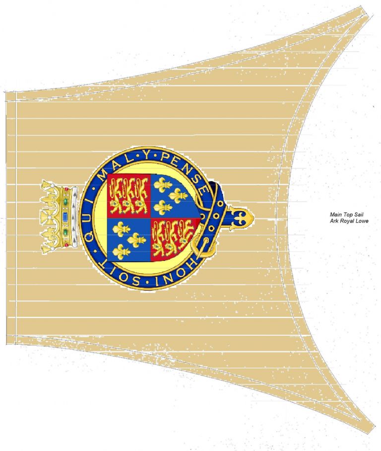

        Here's one of the sails ready to print.
        This is A4 sized. The cotton is peeled from a paper backing sheet after the ink has dried. The surrounds of the sails are sealed with dilute PVA then cut. Hems or tabs are formed and scale size cord is folded within the tab simulating a bolt rope. On these sails, the scale being 1/48 I also used my sewing machine to stitch each seam on each sail, this really assist the shaping.

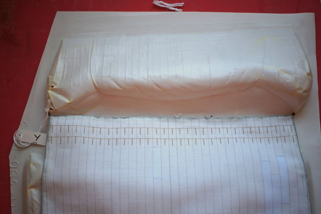

        Here's a finished sail below it's vacuum formed counter part, I think the cotton one is far better. I've even been able to make it appear that repairs have been made to the sail in places.
        Thermopylae sails 2

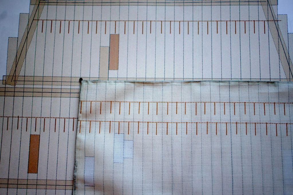

        And here's another sail on a paper printout of a few more sails, 29 in all to make.

          Very colourful and are just what was wanted!
          They look lovely on the model
          Well done, Kimmo
