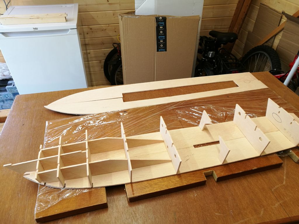

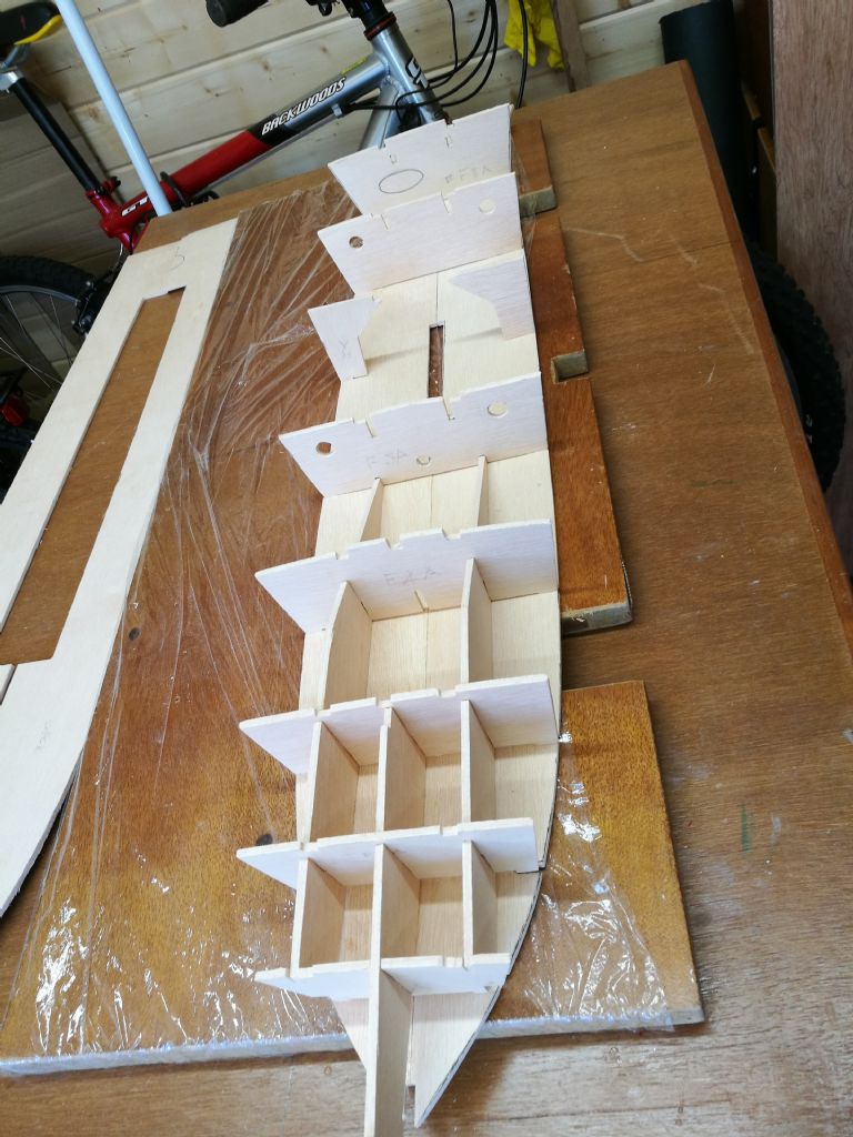

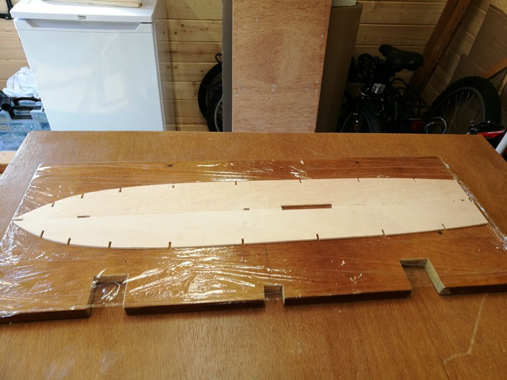

        Made a start on an Eezebilt OSA 1 Missile Boat, whilst in lockdown and a change from gardening.
        Tim
        OSA 1
        OSA 1
        OSA 1
        #86584
          Is this a kit, Tim?
          It looks quite large too
          #86589
            @timcooper90034
            It's an Eezebilt plan printed off the website on my home printer. So cut the plan up to make templates.It's 32" long and I am using 3mm lite ply for the framework, then 2mm for the hull sides. Not decided what to use for the super structure.

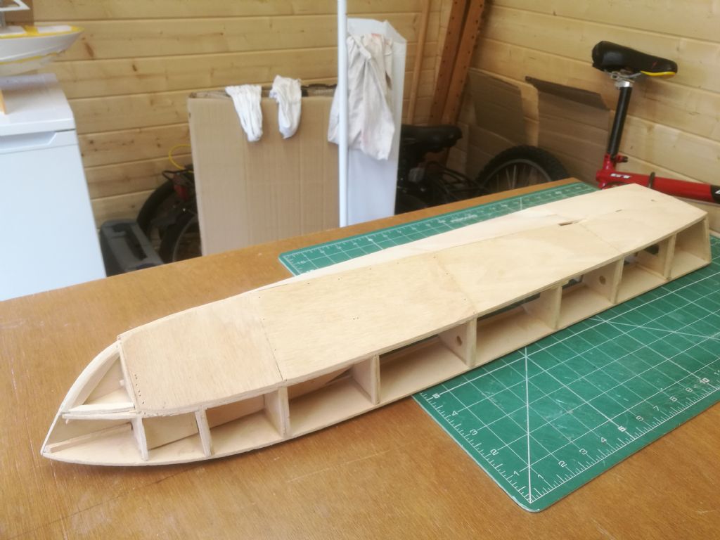

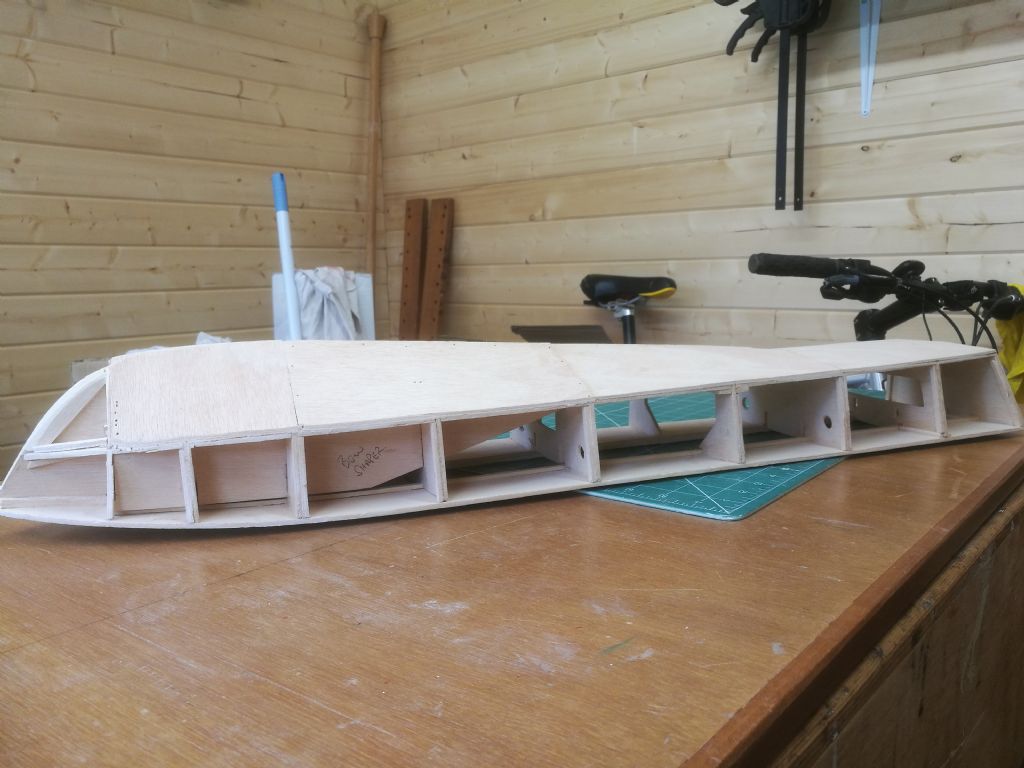

                                                    @timcooper90034
                                                     Progress has been made with skinning of the hull bottom. Still need to finish the bow area. Not sure if I can persuade the 2mm liteply to accept the curve at the front? I may order some balsa block for the bow, as used on Fairey Huntsman. Will fit the prop shaft and motor before starting the sides.
                                                    Tim
                                                    OSA 1
                                                    OSA 1
                                                    Edited By Tim Cooper on 15/05/2020 13:31:17
                                                    #87965
                                                      Hi Tim,
                                                      Do you have sheet balsa you could laminate the bow blocks from, it would save you ordering some ??
                                                      The other disadvantage of the balsa framework is it will distort if you stress it when putting the bottom skin and you end up with a distorted deck line ??
