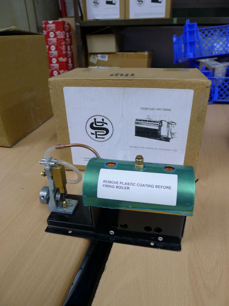

            The Unit Steam Engine and Unit Boiler are both manufactured by Tony Green Steam Models in Lincolnshire. The idea of the engine is that you can bolt together as many units as you wish to create a multi cylinder engine.
            The boilers are also worthy of note in so far as they hinge up to ignite so you do not have the challenge of sliding a lit tray of fuel into the model, which is a huge improvement.

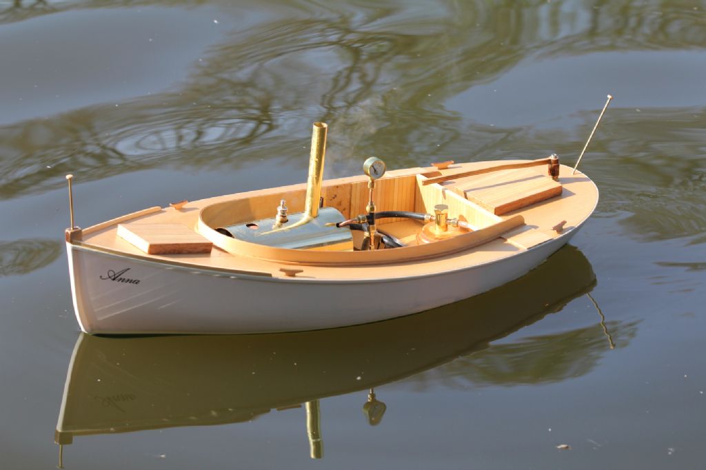

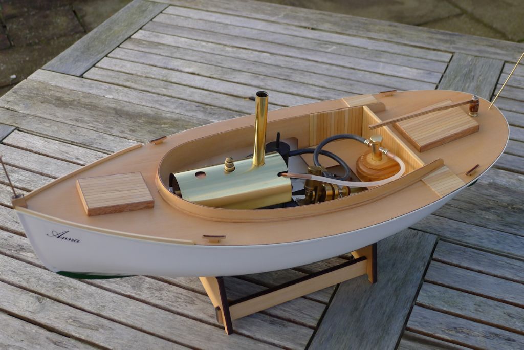

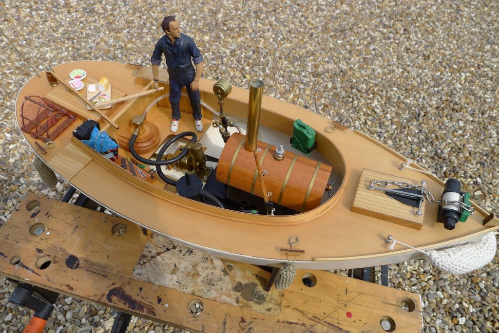

            #98521

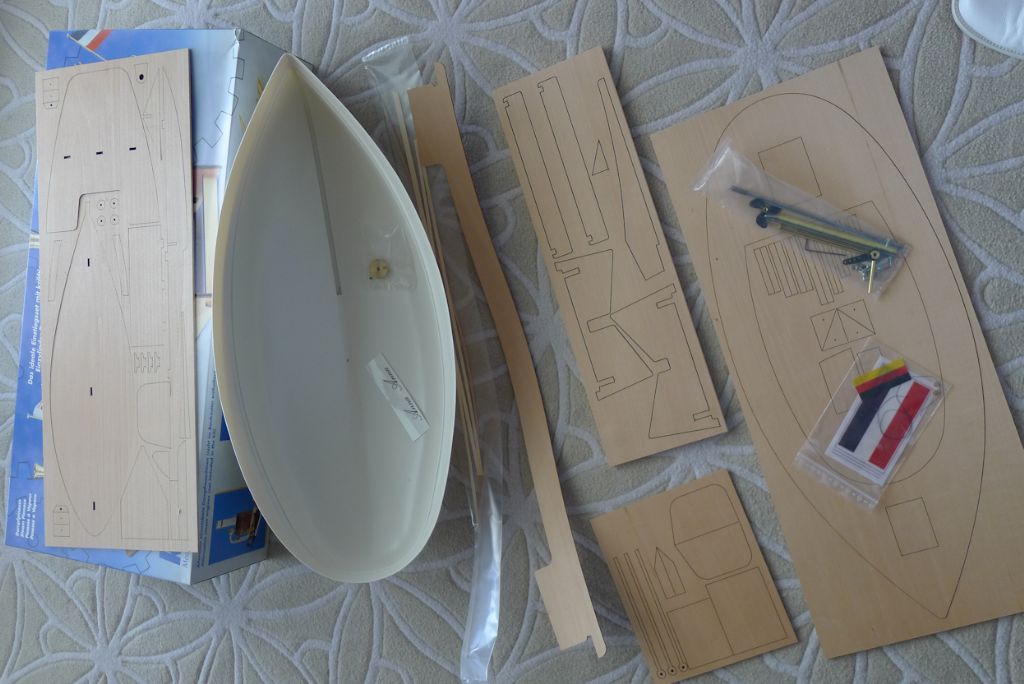

              The build article for the Krick Anna was in the May '17 to Nov '17 editions of the magazine. If you cannot get back copies and you would like to read the articles then let me know.
              I would recommend a kit as a first build, as everything has been done for you as regards design and there will be information out there as regards help and advice but as long as it is a simple build and an open hull for easy access to the plant it should not provide too much of a problem.
              Anyway just a couple of pictures, which you may find interesting, including a shot of a Tony Green Unit Marine Plant.
              Even with a kit there can still be some pitfalls but they should be minimal. The whole idea of this project was to demonstrate that a steam powered model could be put together for a reasonable cost with the total for this including all parts in the model came to less than £400.00. The engine is not controllable, neither would a Unit engine unless you are making it multi cylinder, but you can steer it around the pond with a radio and simply bring it in before you know the steam is going to run out.
