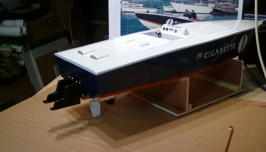

              img_20200210_200258.jpgHi All,
              This another part of the build I wasn't looking forward to ! the name is such a feature, being sign painted on the full-size boat, thought I'd have a go 😀 photograph enlarged on the copier and the print spray mounted onto card to make a stencil for the lettering, cut out with a scalpel and drawn on the hull with a pencil and filled in with a fine brush & Humbrol enamel. The letters need to be shadedimg_20200210_200516.jpg red on one side, but I think I got away with it 😯 ?

                Hi. Ray, you certainly have 'got away with it' what a suberb job, if there were any mistakes the camera would have shown them up, and what a beutiful boat and a such a quick build.

                  Only downside is the name's on the other side as well 😀 deja vu !! Bit of a change from Veronica & Gertrude, still the boy's and I will enjoy it 😈

                    Yes, very effective.
                    Being that sort of chap I would have moved the out-drives further apart, so they could be used asrudders, coz it appeals to me!

                      Well I would send you the drawing, but it's far too conventional a boat for you to build 😀I
                      The other reason for the close centres is to keep the props below the water with a deep vee hull.
