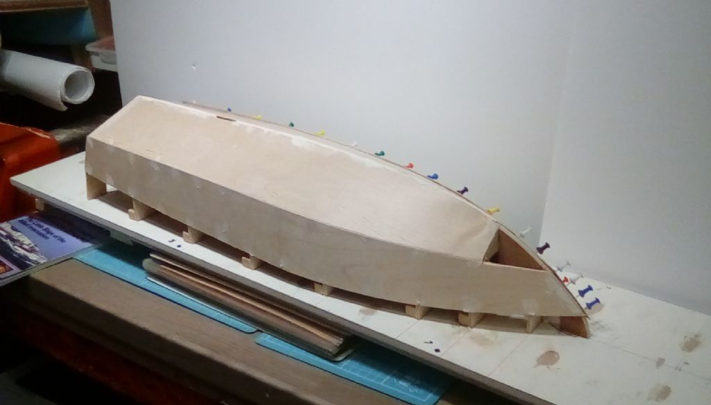

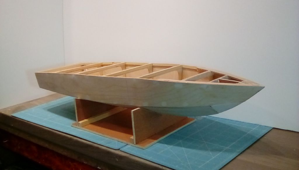

      With a whole 8 days off work over Christmas, this is my latest scale build for my grandson's as they like fast boats, can you guess what it is ?? update & reveal on new years day .img_20191228_210840.jpg

                  Could it be one of DM's designs? Two words – starts with a F ends in a y , starts with a H ends with a n.
                  Received my December Issue just before Christmas – nice plan you produced Ray …………
                  Cant be a WM as that's not a deep V ,,,,,,,,,,,

                      Could it be a Lesro Arrow?

                        Scale model hopefully my interpetation of a classic design, On the right track 😀

                          Should be pretty smokey, whatever it is!

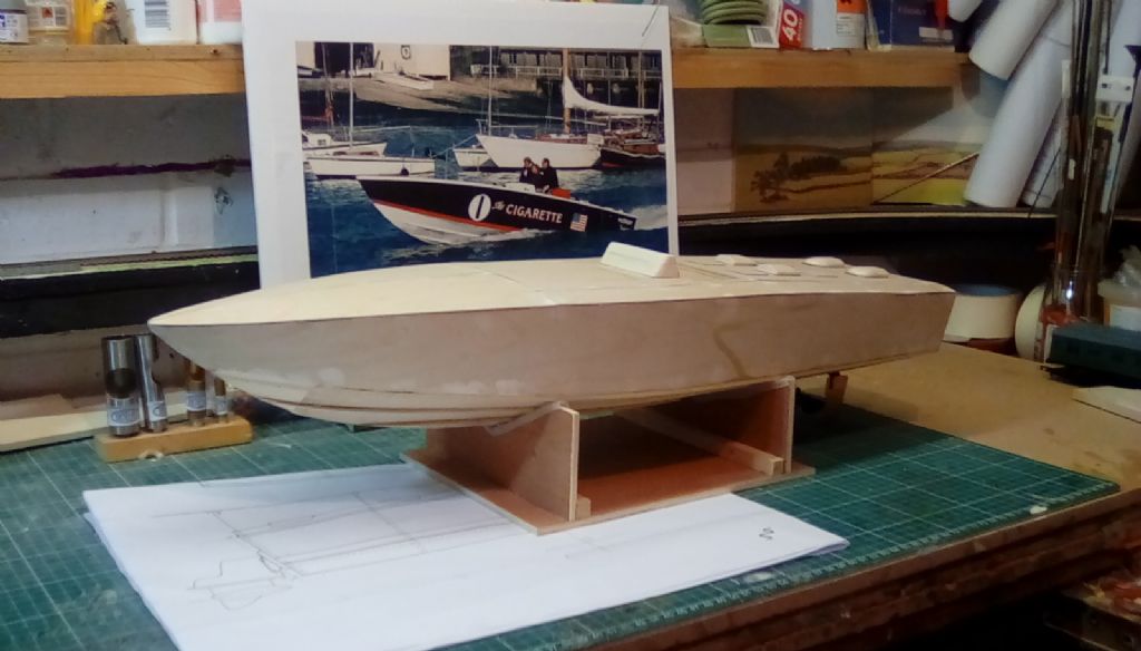

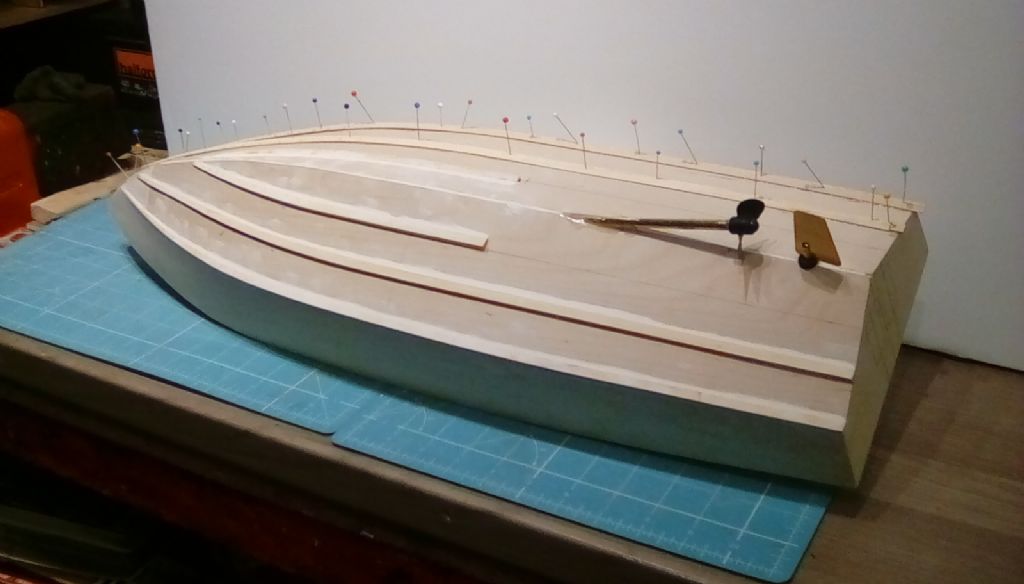

                                  Just a quick update on the Cigarette, worst job complete not perfect but they will do the job I hope 😀

                                    Hi Ray
                                    All looks good BUT do consider putting a triangular support between the prop tube and keel. Any small imbalance in the driveline can create one helluva whip in that tube. I didn't believe a hollow tube of that diameter could wobble that much until I shoved the power of a brushless motor down it. After all, you won't see it once the model is in the water.
                                    #85270
                                      Thanks Dave,
                                      That's good advice, I will put some ply in to support the tube It's only going to have a re-cycled brushed 600 at this stage, but at only 26" long it should go fast alright

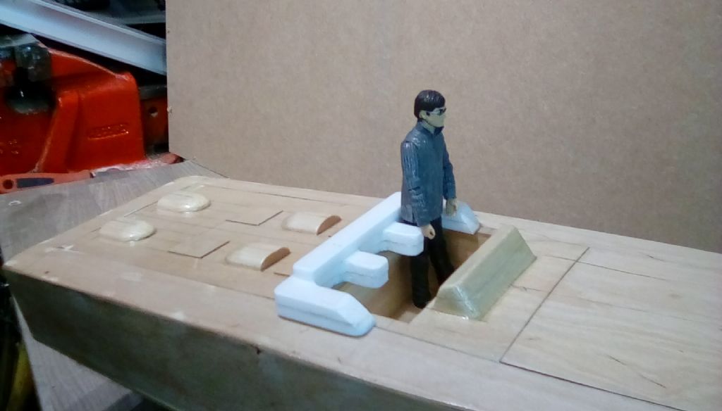

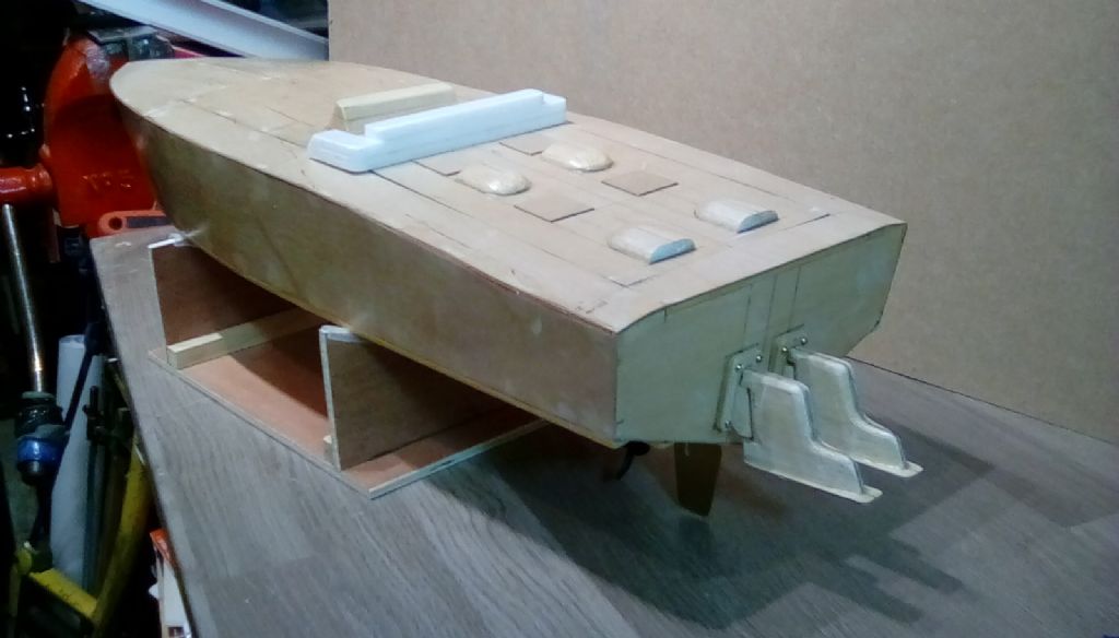

                                          img_20200125_194240.jpgHi all,
                                          As the Mercury outdrives are such a feature, I have fabricated a couple of dummy legs, minus props & skegs. Painting next, looking for 3 crew/drivers, Harry Potter slightly too tall 😮

                                              Tasty, Raymond – very tasty… Bruder 1/14 scale figures might be just the chaps for the helm etc.
                                              #85525
                                                Hi Dave,
                                                They look just the job 😀 will be worth the investment, but I still search the charity shops for bargains 😎
