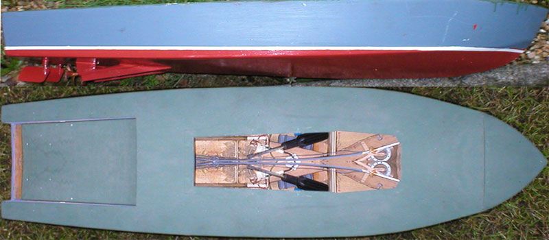

      Returning to the model boat world after a 30 odd year hiatus. Maybe it was something to do with marriage and kids, I dunno but…
      I've recently re-acquired a boat – well just a hull really – that I built about 35 years ago and I'd like to get it going again.It's been sitting on a shelf in my garage for about 5 years taunting me and I'd like to do something with it.
      It started life as a cabin cruiser, then it was converted to an ASR boat , then it sank and then it sort of died a death for many years.
      It's 34" long and 9 and a bit " wide. twin props, twin rudders and as I recall, it worked very well…. until it sank.
      I'd very much like to resurrect it in its ASR mode but I need help with what sort of motors, speed controllers, batteries, etc. In fact more or less everything electrical that would be needed to get it doing what it was built to do.
      I am completely out of touch with modern developments and as I said, I built this boat about 35 years ago and a lot has happened since then, hence I've forgotten all I knew about this sort of thing.

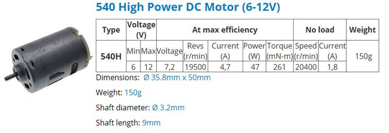

            From what I can gather, the general one size fits all motor would be the 540. Would this be correct? If so I'd need two of them so any ideas as to what sort of battery/batteries I'd need?

              Hi Andrew, there must be more posts on here about 540 motors than any other type. Strictly speaking, the 540 is just the physical size, there are many, probably over 100 permutations of motor in this can size. For reference, most model boaters would use a 540 from a company called MFA, or an electrically identical motor from another trusted supplier.
              Now for my personal view, 2 motors in one hull won't make it go much faster than 1 motor, but they will use twice as much power ( amps) there are other benefits, like acceleration and it looks better too. If you wish to go ahead with two, rather than convert the hull to 1 drive ( not difficult) be prepared to double the cost of batteries and speed controller etc. I would closely examine the condition of the shafts and bearings before doing anything. If they are anything but perfect, ditch them because the problems will come back to bite you later, probably after you've finished repainting.

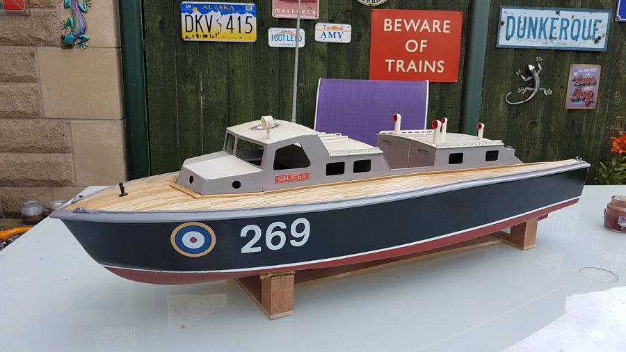

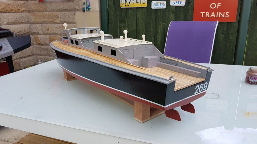

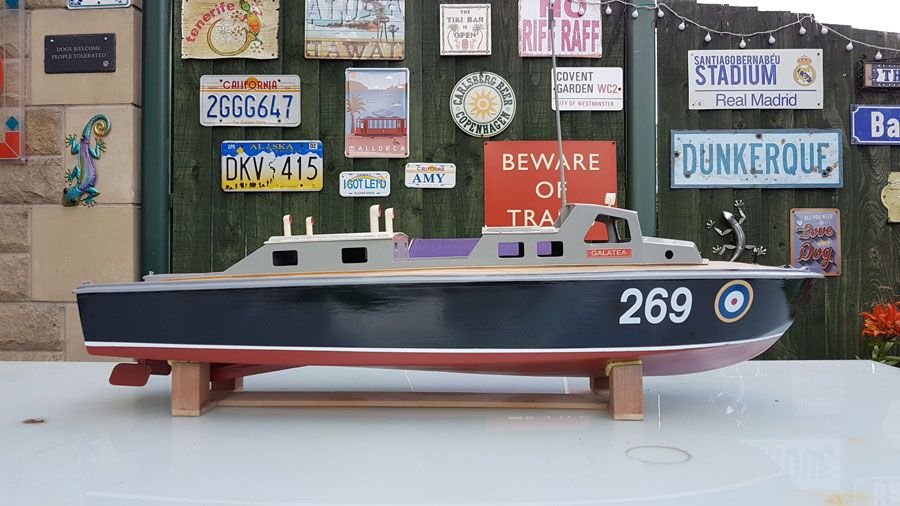

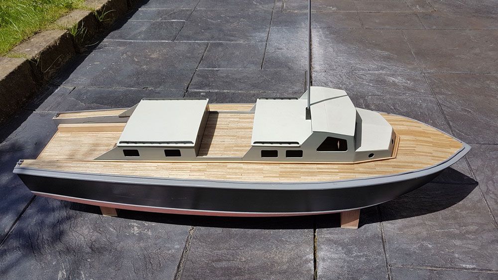

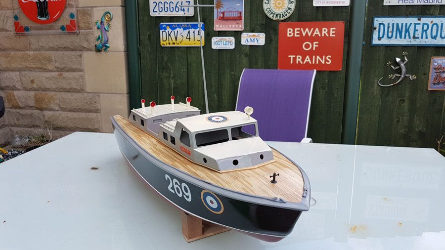

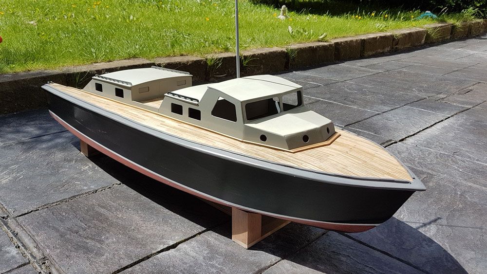

                                          So. Decent light and some spare time so pics as promised. I've still got loads to do but it's coming along nicely.

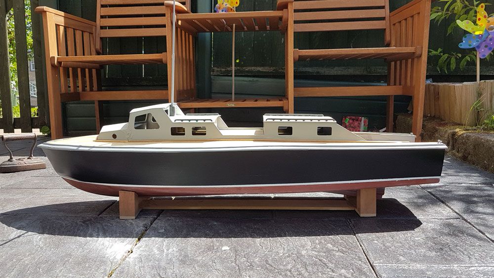

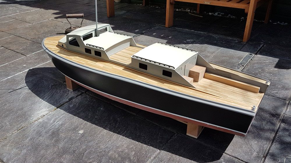

                                                    In the meantime, I'm still waiting for my motors to arrive so I've been playing.
                                                    It's not meant to be an exact replica of any particular boat, just going wherever my mind takes me.
