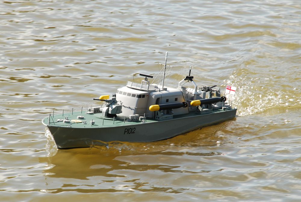

      #6003
      Aridlands
        @aridlands
        Vosper Perkasa P150 kit

              #31830
              Howard
                @howard79726
                Al,
                Thanks very much for the responses; from the photo your model seems to run very nicely (I’m curious about what appears to be clinging to the starboard rear torpedo) and I’m sure
                your choice of kit was a good one.
                However, keep an eye on this thread and I’ll post a pic of my completed model, hopefully running nicely, in a few weeks.
                Also, your indication of a running weight gives me a useful guide – thank you!
                #31838
                Aridlands
                  @aridlands
                  Hi Howard,
                  Well spotted! The thing tied to the torpedo is an LCD “PowerPanel” display for the onboard Eagle Tree data logger. This was installed for test purposes as I could see the speed as measured by the onboard GPS, the prop RPM as well as the main battery voltage and current. In my high resolution copy of the photo I can see the following:
                  Battery voltage: 7.92 Volts
                  Battery current: 8.4 Amps
                  Propeller revs: 4437 RPM
                  Speed: 8.4 mph
                  So since watts = Amps x Volts the motor power is 66 Watts. So this is 22 watts per kg of weight. This is about the minimum it needs to plane.
                  The motor is a robbe unit with a gearbox.
                  The model has a single prop shaft (this help keep the weight down and is “simpler” to install and wire up). The prop is an old 4 blade brass one with a diameter of about 42mm.
                  I’ve now got the Jeti Duplex system so now have a display attached to the transmitter that tells me these things.
                  The model now has a brushless motor fitted and is much faster (about 11 mph) at the same motor power.
                  Cheers,
                  Al
