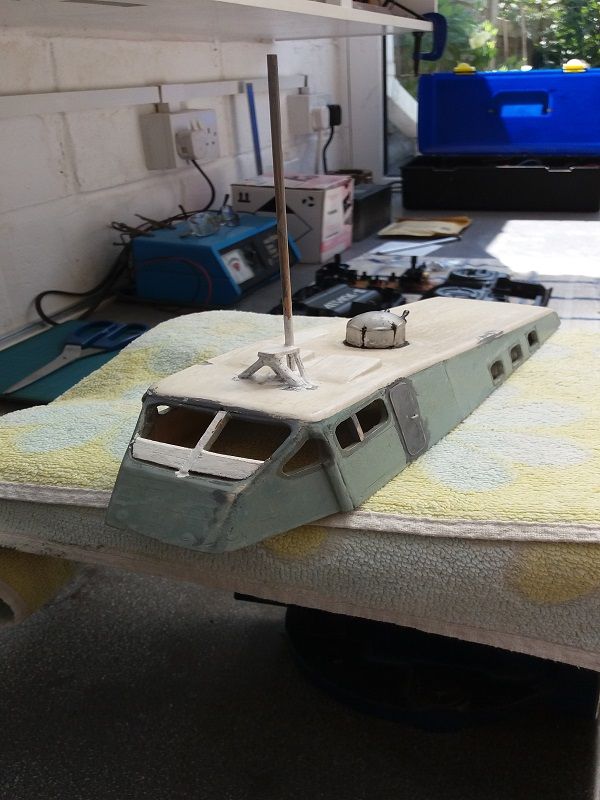

              Dave Cooper 6
                @davecooper6

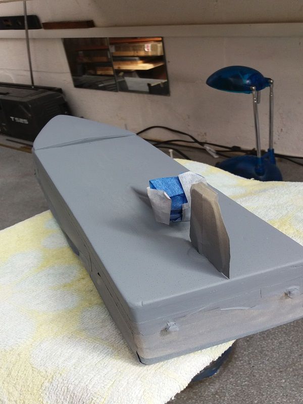

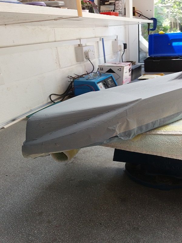

                Sorry about the photo sizing folks – I tried many times to get it right !
                Bow undercut : shows a profile (loosely) as used on RAF craft. Runs aft to the step.
                Bow step : shows the shallow 'v' shape of the step which is about 1/3 back from the bow. (Not yet tried in practice just an idea at this stage).

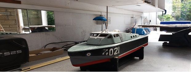

                Superstructure : in the early stages of the refurb'. Not sure about mast height yet – they were quite tall though. Turret to be replaced, guns (loosely) twin Bofors. Wheelhouse scale is roughly 1/48 judging by some German artillery figures I have !
                Any ideas where I can source a suitable turret ? Will probably test run with the existing motor (350) and prop (30) plus a 1500 MaH LiPo until some experience gained…

                    Dave. Now I can see what you mean about the bow step, I am not keen. I think it is too small to be a step proper, even if going fast and is likely just to cause drag.
                    Personally I would sand this flat OR put a bit of sheet balsa behind it and fair this into the rear section.
                    The bow undercut looks useful though. Ashley

                      Hi Ashley – yes, might have to revert to your blue Styrofoam idea. Must brush up on my hydrodynamics !

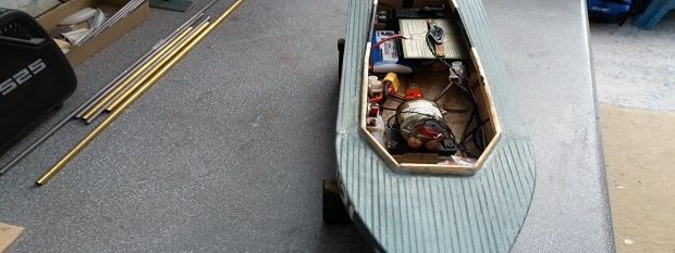

                              2. Second pic shows 'vintage' installation but with modern LiPo (1500 MaH). OK for bath testing I think, but, will probably need an upgrade to drive shaft (2 > 4mm) and replacing the Bob's board with a modern ESC.

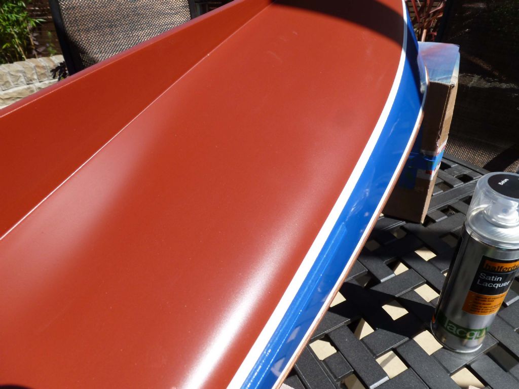

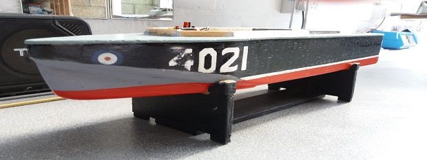

                              3. Final pic – is the waterline red too red…I was thinking maybe a car accessory Red Primer (or similar) may be better ?
                              Boat will be re-numbered in due course as I've yet to see any RAF launches of this type numbered over 2xxx.

                                Bath test once you have changed the propshaft and vintage Bobs board.
                                Red oxide paint is the "usual" red colour of choice. It goes much brighter when wet and in the sunlight.

                                    Halfords red oxide is very good but it is a primer so technically not waterproof. Ideally it should be sealed.
                                    I have recently discovered, along with others, this matt lacquer from Halfords. It gives a lovely finish and appears to be OK for any sort of paint.
                                    #83662
                                      I usually just splash some Eze Kote on it. Gives it a semi gloss finish. Under way the red bit will be wet and thus shiny in any event.
                                      Will check out the matt lacquer, very handy.
                                      #83663
                                        There's also a Satin version of this which I've used on their Red Oxide with great results. lacquer 02a.jpg
                                        It does seem to be solvent-based, however, so the usual advice to test it on a small area should be heeded.

                                          The bright red that has been applied so far does seem to be durable and waterproof. I think I may leave this on until I get around to the prop /driveshaft upgrade.
                                          Thanks for the painting tips all. I'll get some red oxide and lacquer and experiment with some scrap wood in the meantime – Dave yours looks very slick I must say…
