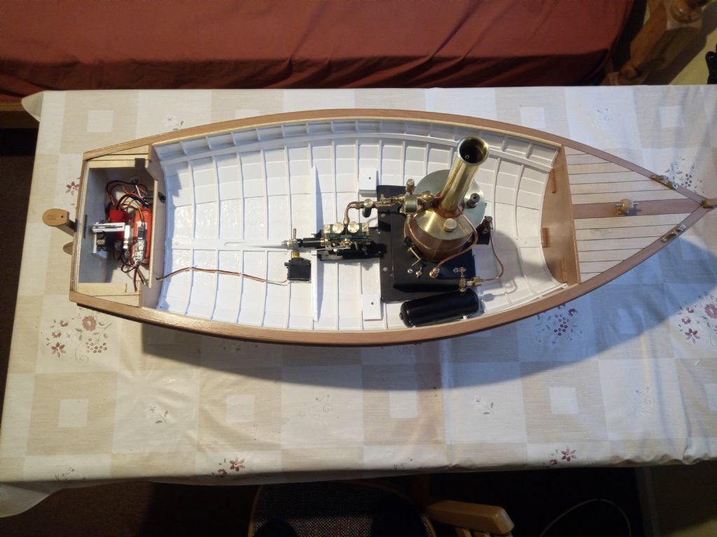

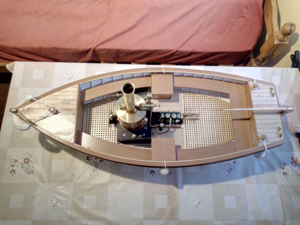

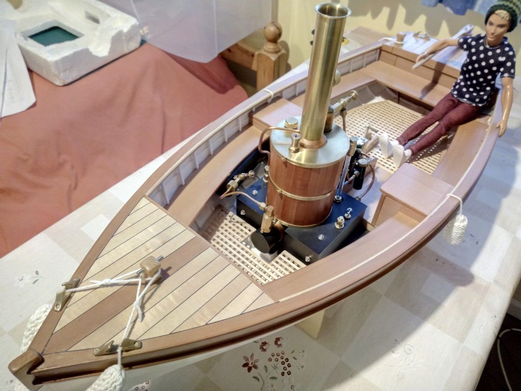

      Have just completed putting this together over the last 9 months. First boat build in 40 years and first live steam ever! It has been fairly enjoyable but there have been plenty of wee swearies along the way – bit of a learning curve with the 'fancy' woodwork. Ran it up today for the first time – bonny!

          Thyat is a really lovely looking boat. You seem to have made an excellent job of it.
          #79330
            Hi Batto
            I'd say a well spent 9 months, beautiful work keep us posted on the first voyage
            #79331
              Batto. Yes 9 months work not wasted. A nice looking boat, and live steam as well! Ashley
