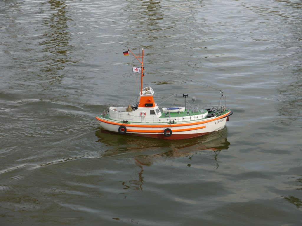

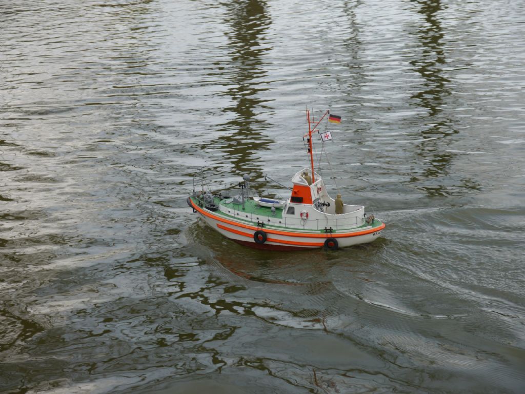

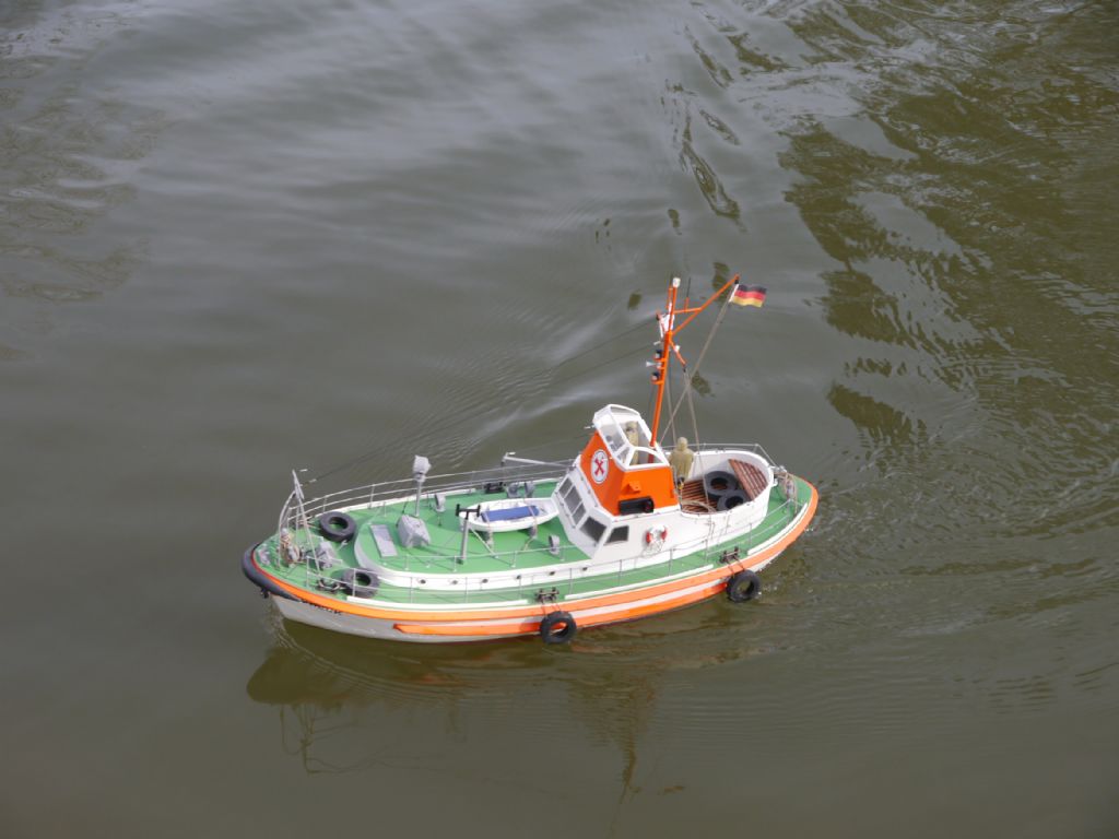

      Here are a few pictures of Lubeck, a Manfred Sievers kit of a German Lifeboat 1942 to 1967, scale 1:20 and model length of 65cm. Sievers makes a range of kits and he has a website, Today was its first sail at Fishers Green Model Boat Club near Waltham Abbey, Essex.
      It is brushless motor propelled and has a magnetic switch which you can just see in front of the motor on the starboard side. This negates the need to lift off the superstructure to switch on and off, since just passing a magnet over the hull in the right place switches it on and off. as needed.
      The 2822/17 Turnigy brushless motor consumes less than 1 amp when running and the esc has been turned down 50% because otherwise the model virtually takes-off at full speed.

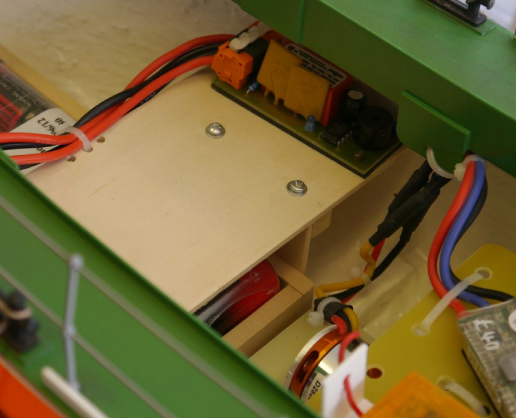

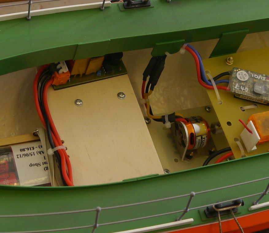

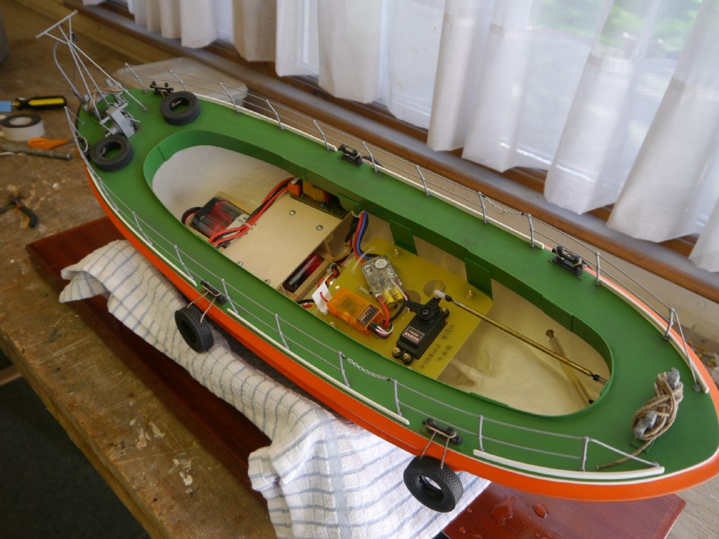

              And here are a couple of pictures of the magnetic switch up against the hull's starboard side. The switch comes from Alexander Engel who has a website.
              Interestingly, when I cycled the 3700mAH 8.4 NiMH battery after Sunday's one hour sailing session, the brushless motor had only consumed 0.45 of an amp from a full charge. So, the tiny motor which you can see in the pictures and which is rated at 102w, is also much more power consumption friendly than what I would previously used, such as a 385 brushed type. Speed controller, forwards and reverse, is a Hawk 30amp. Not cheap, but it works perfectly and does not need water-cooling. Motor fits into a standard 380 type of mount with no adjustments, except it is back to front. Rx is £4 Orange generic type for Spektrum DSM2 – also works perfectly.
