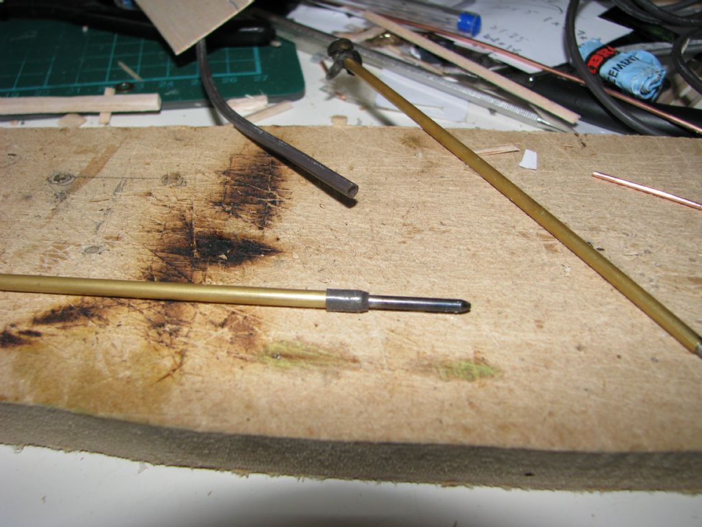

              Another trick is a thin-walled silicone tube – ID slightly less than the prop-shaft. Push it on over the prop-tube at the motor end, and let 1/8" or so overhang the prop-tube onto the shaft, so that it makes a seal. See below:

                  Thanks DG, will note that one down to try, will save a lot of time & effort if it succeeds. smiley
