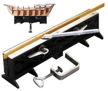

                  I might have misunderstood what you planned to use the clamp for, I presumed that your model was complete and that you were carrying out maintenance.
                  However for a build of a traditional sailing vessel a keel clamp is necessary but I wouldn't bother with the expense of buying one as I would simply make my own using two lengths of 75mm x 15mm (one fixed to the building board and the other loose) and bolting them together to form a long clamp.
                  Something like this one from Mantua LINK but without the fancy flanges
                  If you post some photos of your build I will be able to help out a little more.

                    Thanks Paul that sounds a great idea something to do this week
