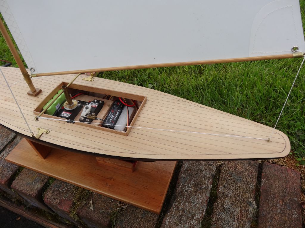

                              Whilst stored in the old shed (which leaked like sieve), this model had suffered during storage. Now I have a new dry shed, Jenny has been undergoing some much needed tlc. Hope to have her back on the water next week.
                              Took this photograph which shows the lovely shape of the small yacht's hull.
