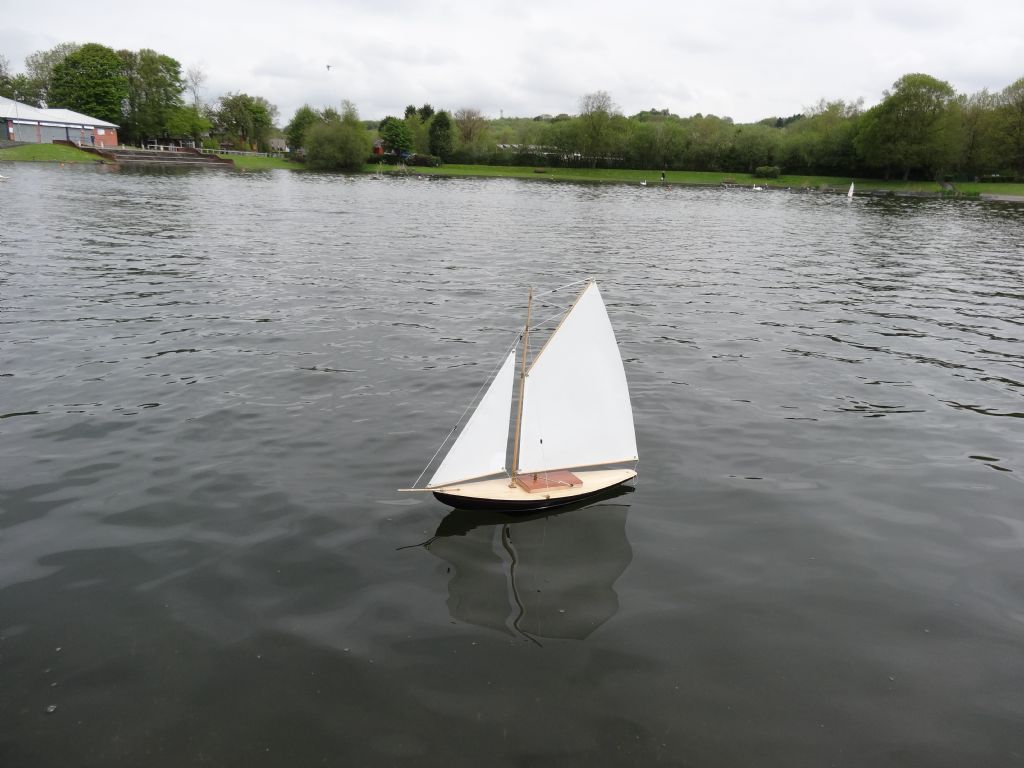

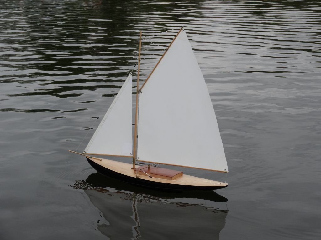

      Took the model yacht Jenny for it's first sail in a long time this morning and took a couple of photographs.

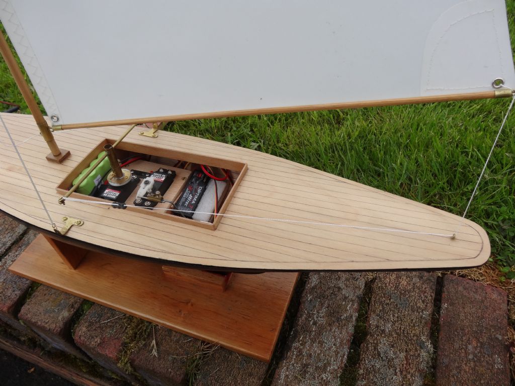

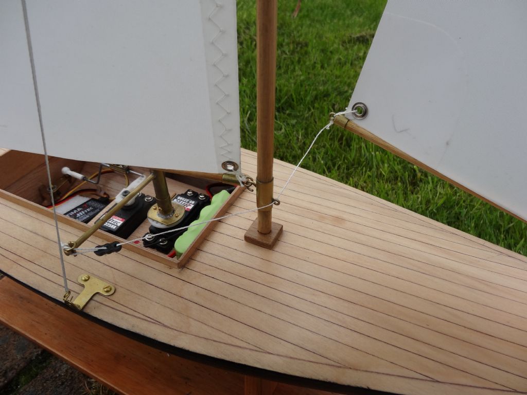

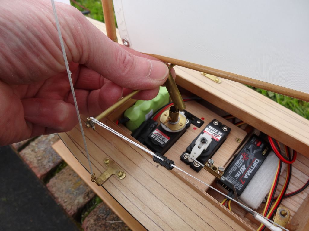

      Larry, you were asking about the sheeting system, hope these photographs help. Cabin/hatch removed for clarity.

        Hi Tony,
        what a grand yacht, very nice indeed.
        I've just spent 20 minutes reading the thread from start to here. A very neat instalation under the deck too.
        Now be carefull, Colin will have you labelled a "yottie" too. I like to use jackstays and luff hooks for sails on restorations of older yachts, it makes taking the sails off easier as they're cotton and can suffer if put away damp from mould etc.
        The small eyelets I get by the 100 from SAILSetc and they also have the die, washers and brass threaded eyes too. The larger eyelets I use for the tack, clew and head. Some of the modern brass eyes are weak and twist off so take care.
        Impressed I am, Kimosubby
        #41161
          A very strange and unusual setup, Tony……….But very neat and tidy, I hasten to add!
          The removeable winch arm is very novel
          You have the line from servo winch to the extreme end of the boom?…….This will drastically reduce the amount of swing……….Is that your intention?
          A kicking strap would help restrict the lift of the boom
          Apologies for giving unwanted advice, but I couldn`t control myself!………lol
          Yottie Bob
          #41169
            Thanks for the comments on this one, The installation is crammed in a very small space with not much room. It is always worth going the extra mile to make the installations neat and tidy and it is annoying when at the lakeside to see so many models with untidy electrical, mechanical and control equipment workmanship. I plan to make smaller rx holder (next Autumn/Winter) as the one in the photographs is sized on a 40mhz 7channel rx whereas the new Opima 2.4ghz rx is a much smaller physical size. Temporary packing was used for this sailing session.
            Bob, your advice on modifying the sail boom and fitting a kicking strap should make an excellent improvement and it will be well worth trying different positions for the booms eyelet position. The installation was carried out as Douglas McGhee's plan and build item, which is always a good basic starting point. The point which was problematic was the main sail's sheeting line which has a tendency to snag on the corner of the cabin. Some kind of a fitting on the deck with a small eyelet to hold the cord above the cabin would be helpful. The only deviation from Douglas's design is the conection between the sail servo and winch arm. The plan recommends a square tube to fit in a larger square on the servo, as I didn't have any square tube in stock, I came up with the round tube and small bolt idea.
            Th model had been in storage for a while and a small amount of green verdigree has appeared around the bowsprit's brass fittings. This can only be caused by storage in a cold damp shed in the North of England. Whilst at the club comments were made as to how stable the balsa hull has remained whilst in storage. The hull was wrapped in fine denier ladies tight so this method has certainly had a test. Comments were also made as to how well the model sails upwind.
            Thanks again for the comments and Kim, very much enjoying watching your 36R take shape.

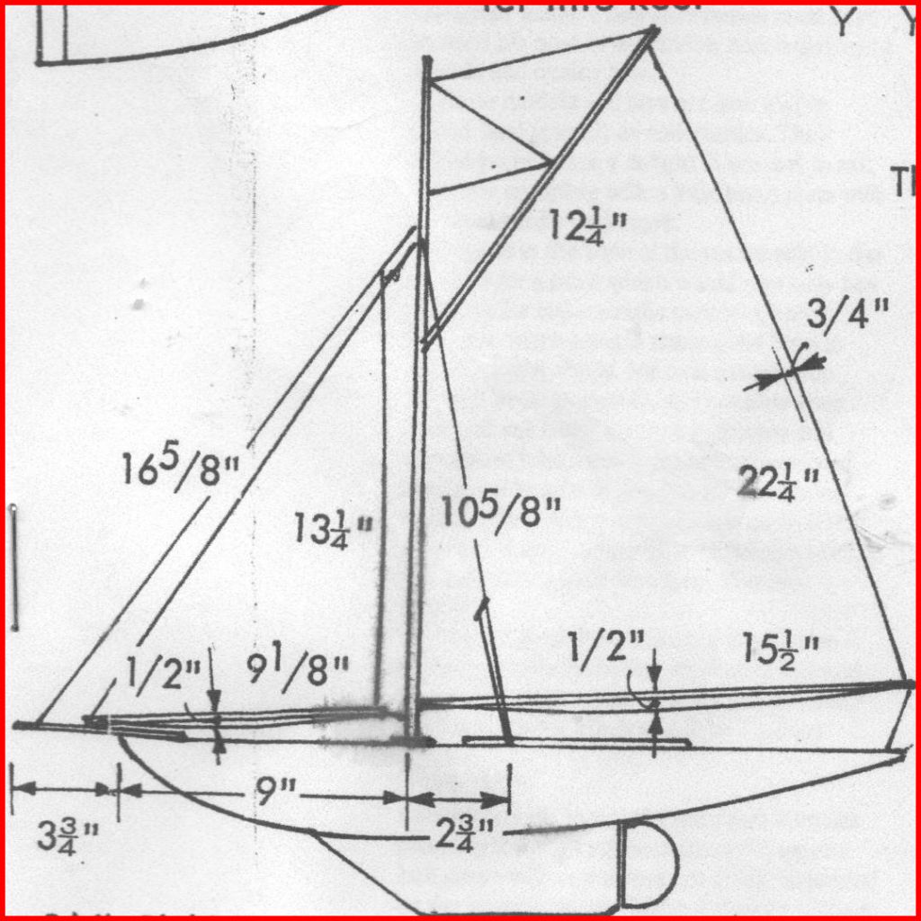

                            thank you for the help on sails, search for template on nylet came up blank,
                            but have sail plan of Jenny ,
                            as for me scan showed up a malfuctioning implanted valve ,may be swirt of wd40 might cure it ……

                              I've now got a nice black and white image of Jenny to use as a guide. From the MM2070 plan thats popped up below on this forum. It appears that in that image the sails are made from modernish type sail material.

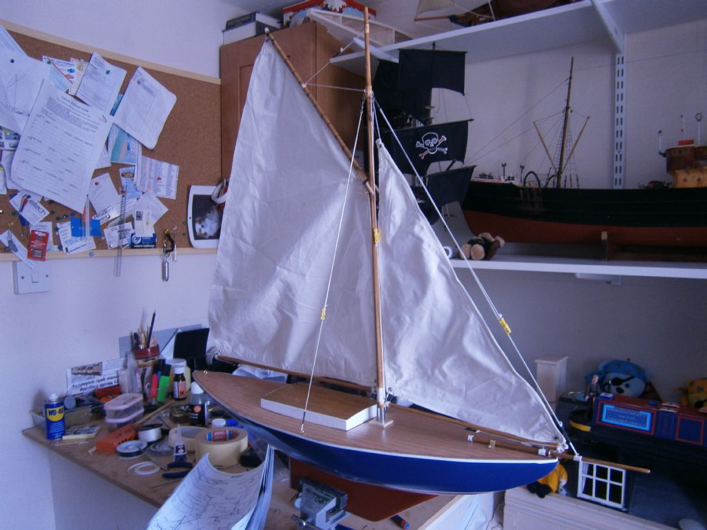

                                    #41421
                                    LARRY WHETTON
                                      @larrywhetton68737

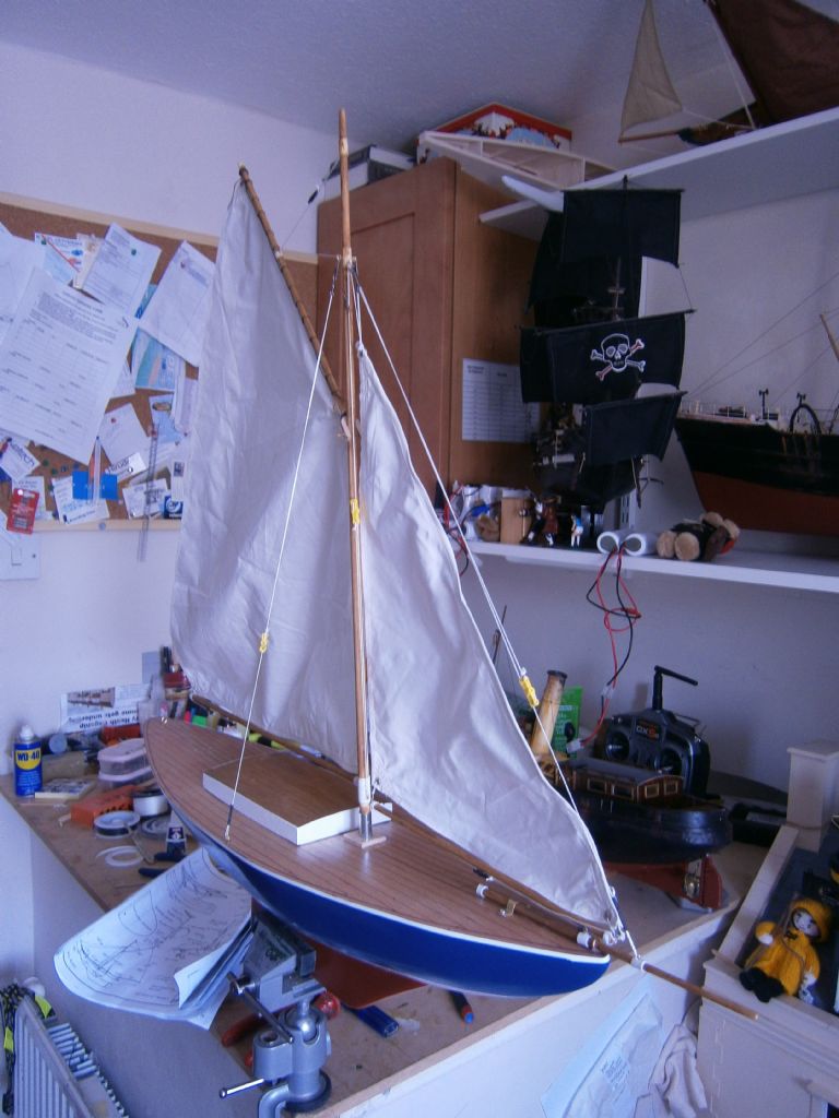

                                      jenny 009.jpgHi all…
                                      Nealy completed JENNY , compleated masts and rigging and the sails kindly made for me by
                                      Kimo…. starting to look like a old pond yacht, rudder and R/C bits next,
                                      when i get a new solder iron my trusty weller as give up.
                                      thank you again KIM you realy pushed the build along …….cheers Larry….

                                        Hi Larry she looks good, nice to have a pal to make a set of sails as for my Jenny I have just got bact on it after working on my car and put two coats of resin on the hull .Have to go to the doncaster show to sort out sails and mast.
                                        Rod
                                        #41427
                                        Kimosubby Shipyards
                                          @kimosubbyshipyards
                                          Larry,
                                          the sails fitted then? Looks like you may want to remove the wire stay I added in the luff – unless you've kidded me by not tightening the luff up.
                                          Rod, you only have to ask, I only know Larry through this forum.
                                          Oh, and Larry, Cloie pictures of her first outing on the 36R thread.
                                          Cheers, Kim

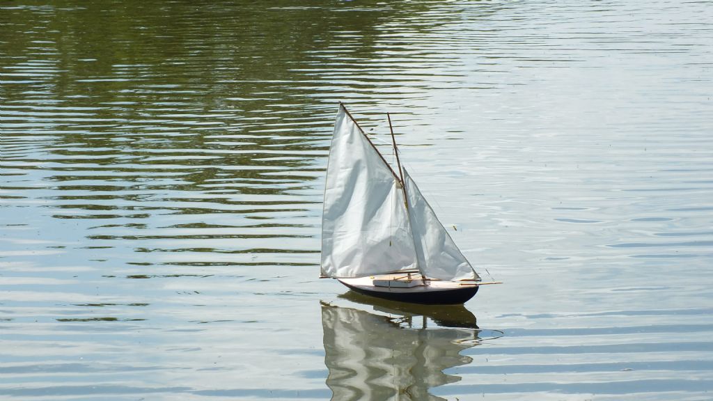

                                                    #41501
                                                    LARRY WHETTON
                                                      @larrywhetton68737

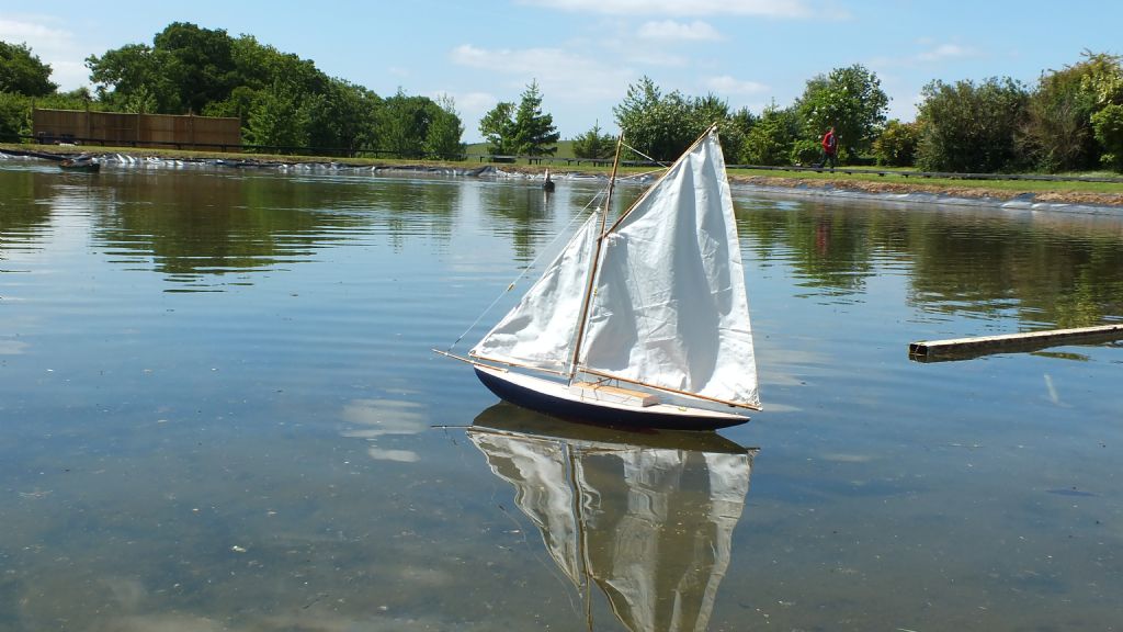

                                                      taking on bristol pilot
                                                      chedder  sunday jenny 039.jpgGood Morning all,
                                                      Put Jenny on the water, on Sunday ideal weather , so was eager to put through trial,
                                                      nice little breeze , sails filled nicley thank kim,
                                                      went down wind a bit serdate, so far so good time ti turn, but then nothing whent stastic.
                                                      need to add more ballest, so bring it in for addjustments,
                                                      but just sat there doing nothing then a gust of wind hit it when into flat on the water mode ,
                                                      to late now swamped with water brought to shore , receiver ok .in water proof balloon ,
                                                      resin coated in side so bailed out, so will have to make a few mods before next outing,
                                                      onward and uppward , so Ashley you are not the only one who as fun……
