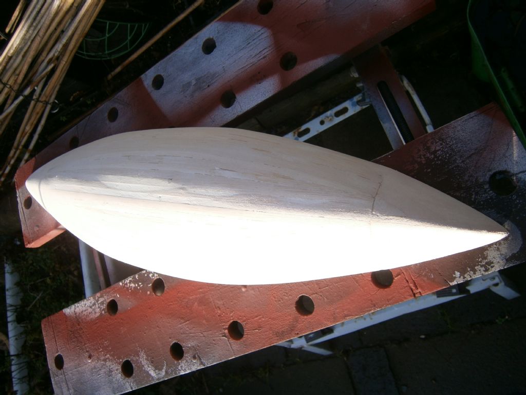

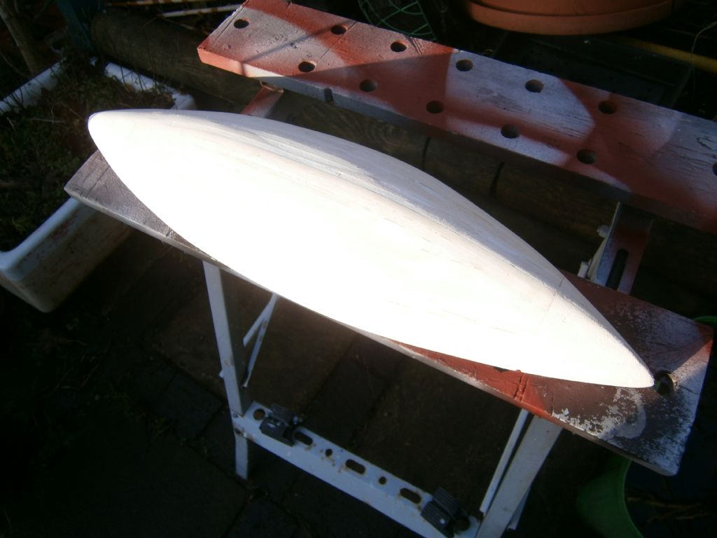

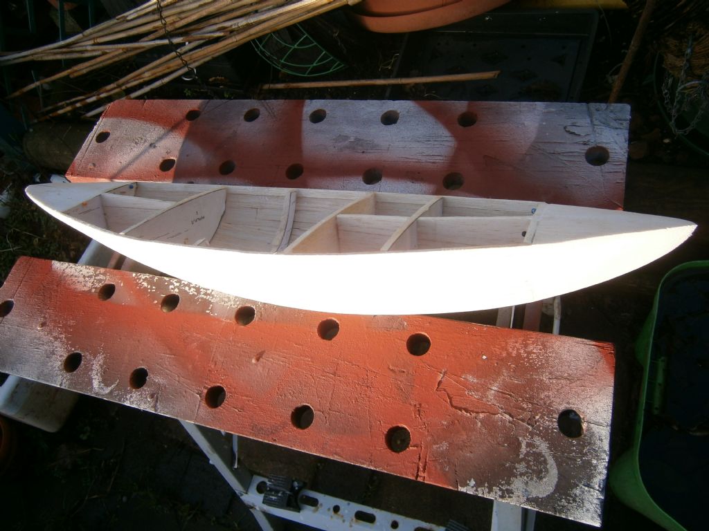

        Here is JENNY hull awaiting stocking cover…….
        Tony my deck will be thin ply planks drawed on with fine marker pen,
        or as Bob sergested use card with same treatment well varnished ,
        Rod stick with the post……more build photos soon to cold for paint finish ,no heating in shed……..

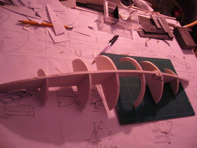

        Rod smart
          @rodsmart62545

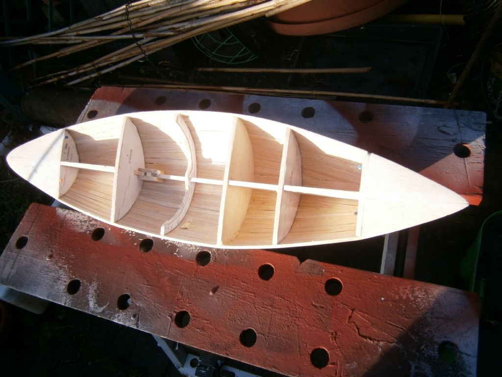

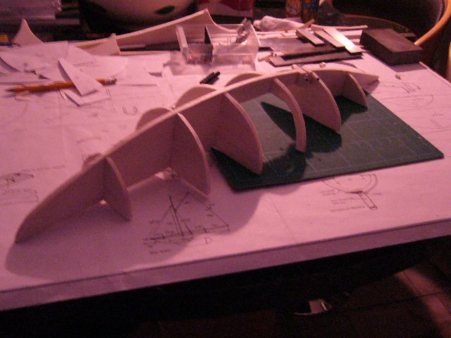

          monday 292.jpgLarry Hi,will only be going so far as I 'll going to my family near Tamworth and i'm working in the kitchen.monday 295.jpg
          Edited By Rod smart on 17/12/2012 16:45:25
          Edited By Rod smart on 17/12/2012 16:46:17
          #38225
          LARRY WHETTON
            @larrywhetton68737
            Hi Rod,
            Looking good so far ,
            Make sure all ribs are sqare and plum fix the first planks at deck level ,
            and keep checking spacing , this will stifen up frame work ,
            leave for a day before you start on the rest of planking , and dont forget to put a slight chahmfer
            on ribs towards bow stern , to get mas glue contact,…..fix planks on left and right side together
            you will find that some planks will need a taper, hope this helps Larry….

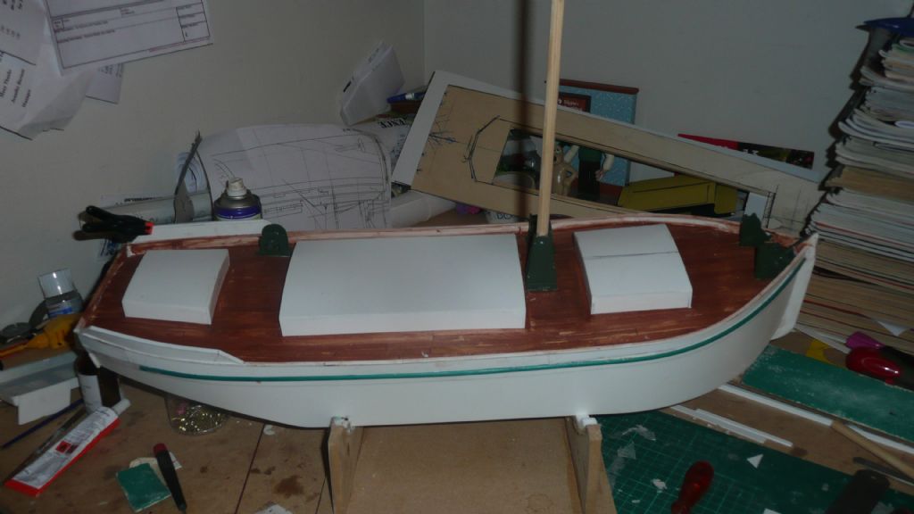

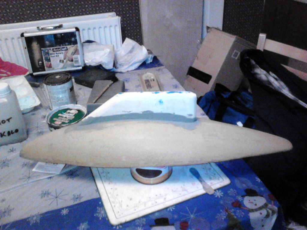

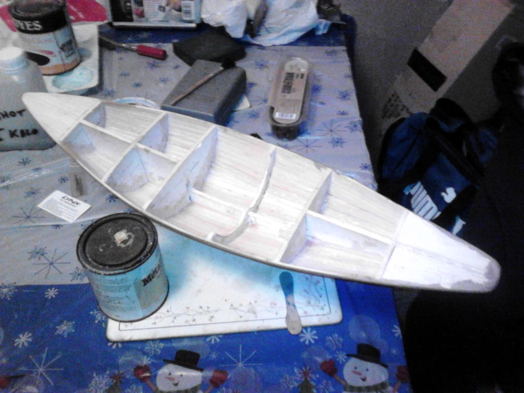

                    .I now have some photos of my Jenny "so far":
                    Here I have fitted the keel, and have applied cellulose putty around the join between keel and hull. Note that at this stage I have also fitted the rudder tube – this helped with lining up the keel squarly to the hull.
                    This photo shows the inside of the hull, I applied a coat of polyester resin to the inside of the hull before sanding the outside to ensure the hull was stiff, and help seal the small gaps between some of the planks. Notice at the stern, the remnants of the stocking material impregnated with fibreglass resin, which is proving very tough to sand down.
                    Cheeers
                    Ricky Walker

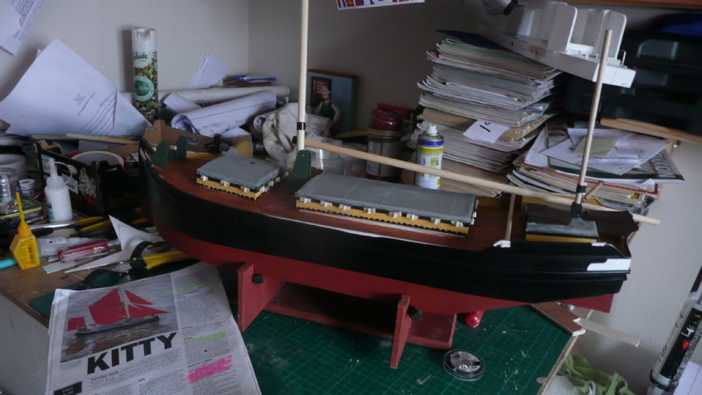

                              Thats a sad tale , make yuor freind pay for the next model that make him sober up….laugh
                              is the TSB this one ?…i have built it but now sold …..beware of the sail riging at if using styrene '
                              fill the hull with water to test for leaks good jionts are must…….Larry..
                              this model is now sold , i never sailed it was a more of build test but looked nice………….
