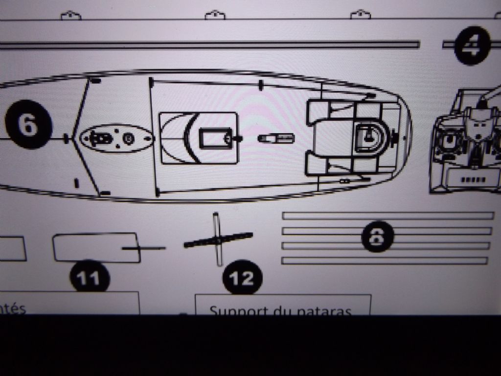

              Hi James,
              The instructions such as they are online in French with diagramshurricane inst.jpg, but the attached is a photo of my tablet so forgive the quality !
              Google = Volantex Racent Hurricane, there is pdf to download
              It seems the 2 lines coming out the back of the boat from the winch make a continuous line round the eyes on the deck and the mainsail and jib are attached to it !
              This is not the easiest method Iv'e ever seen
              Good Luck

                    #100565
                      Hi George,
                      I don't think it's that complicated a system, my money is on the winch having 2 sections upper and lower as the winch is operated one pays out and the other pulls in this giving you a tensioned running line on top of the deck to which the sheets to the main and the jib are attached.
                      I think the diagram I posted shows a bobbin on the port side to which the sheets are attached, there is already a fixed traveller in the centre of the boat for the main sheet to exit to the boom.
                      The Dragon Flite 95 has a much better and simpler system with a single line from the winch which is tensioned by very thin elastic to the bow and runs completely above deck.
                      Edited By Ray Wood 2 on 24/05/2022 15:43:29

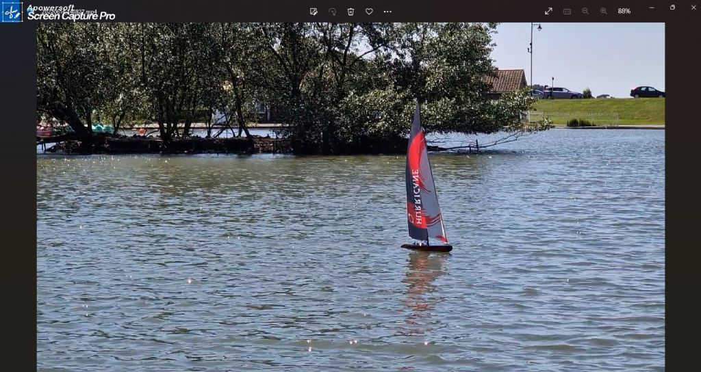

                                #100872
                                James Clark 4
                                  @jamesclark4
                                  Volex Hurricane back on the Water
                                  #100873
                                  James Clark 4
                                    @jamesclark4
                                    Posted by James Clark 4 on 18/06/2022 15:05:13:
                                    #100874
                                    James Clark 4
                                      @jamesclark4
                                      Hi Dave please see photo of Hurricane back on the water @ Portishead Lake this was taken after it got stuck under
                                      a tree branch & was rescued by a guy with a small dingy that worked in the local Cafe crying
