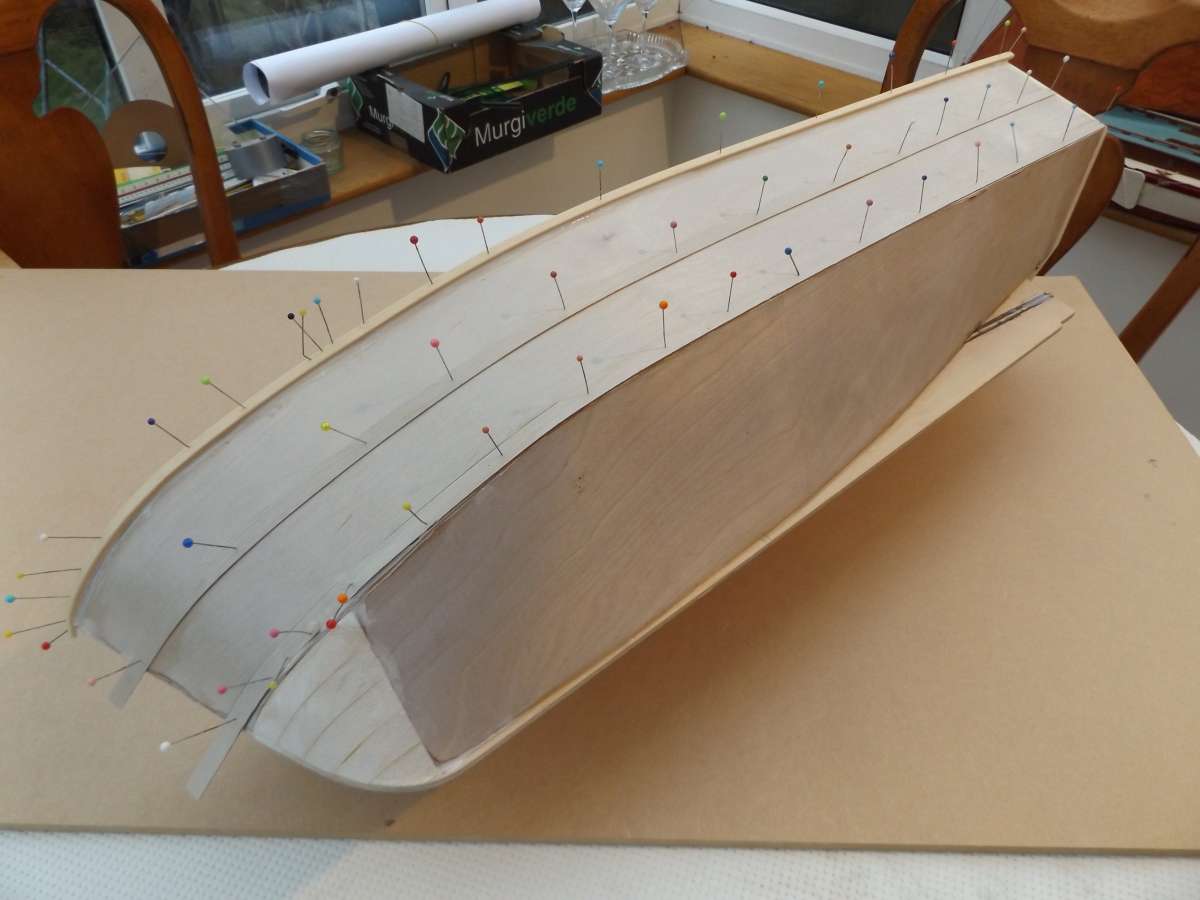

              Well back from another epic Wales weekend, small update on the launch, all set up with the chine rails of obeche for the inner and balsa for the outer, easier to plane and sand to shape, better press on with the skins, paper templates are the way to go for me 1/32″ topsides and 1/64″ ply for the bottom as I have plenty, although cheaper to use gold leaf these days 🙂
              Regards RayInvicta 5 060824

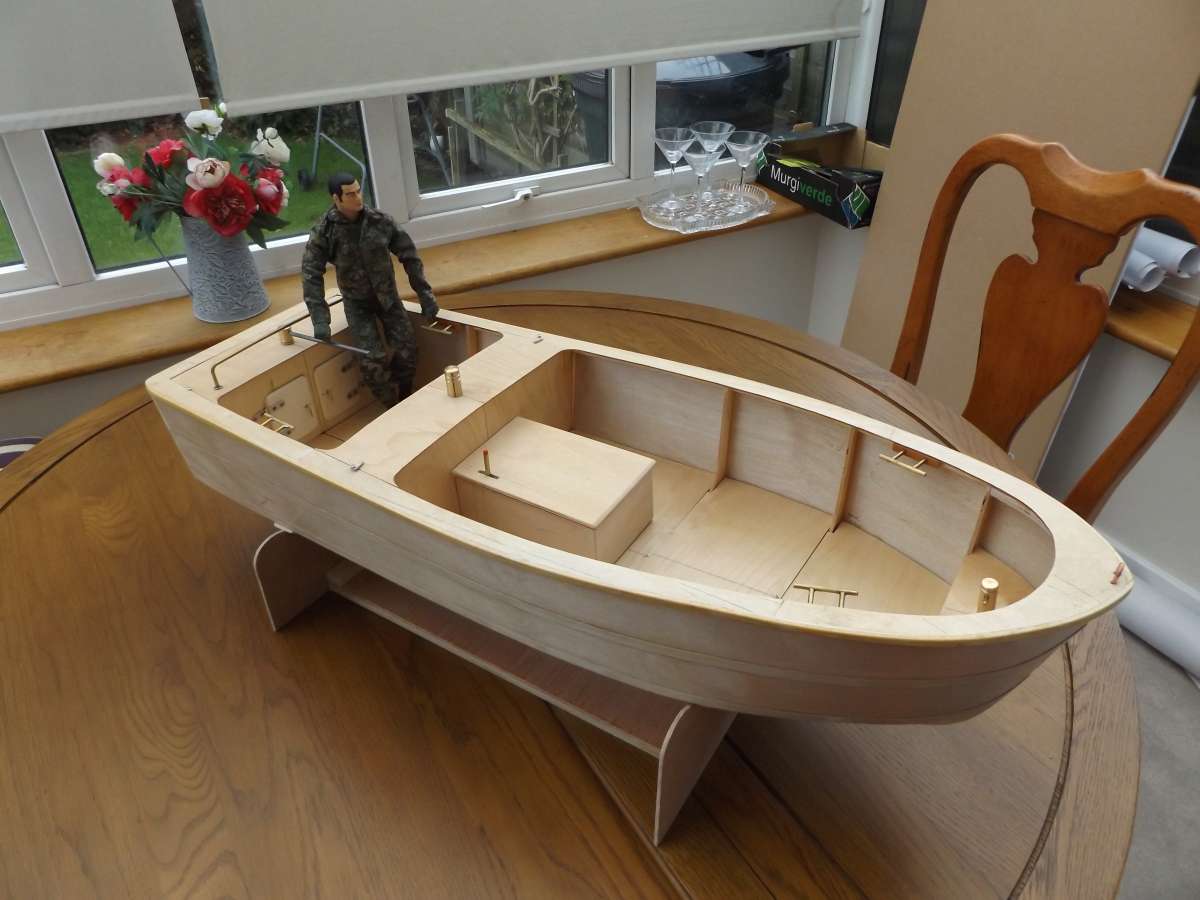

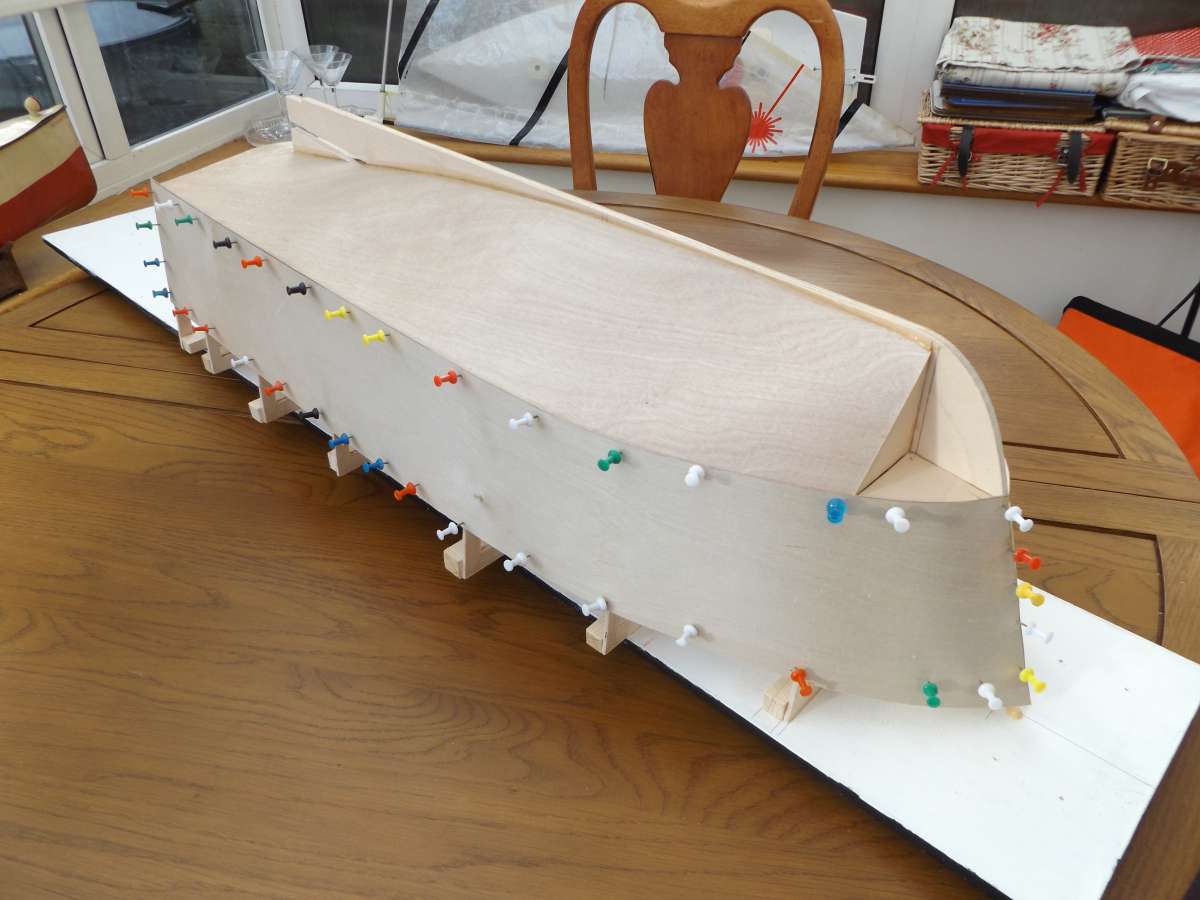

                      Unfortunately the pins had to be taken out and all the holes filled  🙂

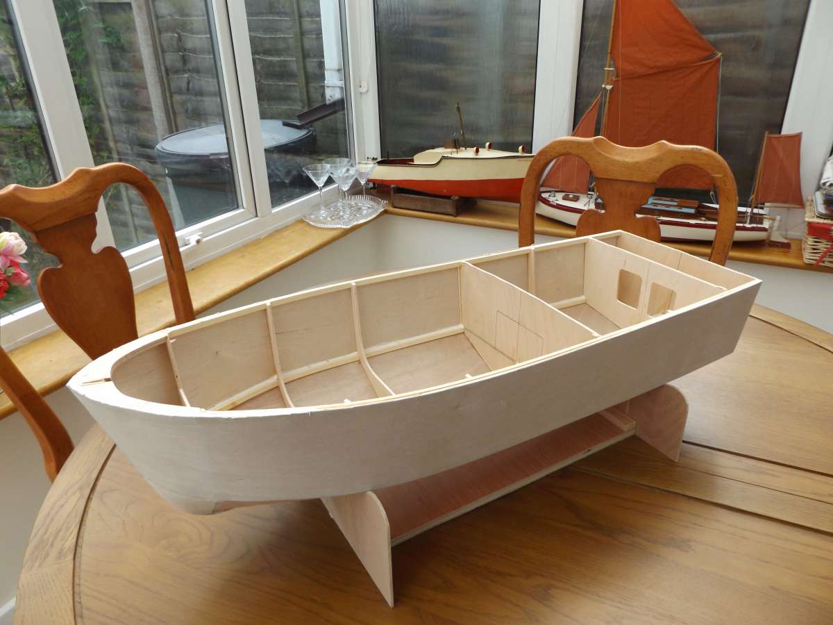

                      Looking more boat like, the great thing about this is there is no cabin to bother with , running gear and rudder next which should be interesting !! Action man will have to be steering the boat, I think round corners on the transom makes her look more steel like ? , need to buy some bits now, how I miss the Chatham Dockyard Model Shop 🙁
                      Regards RayInvicta 8 210824Invicta 9 210824

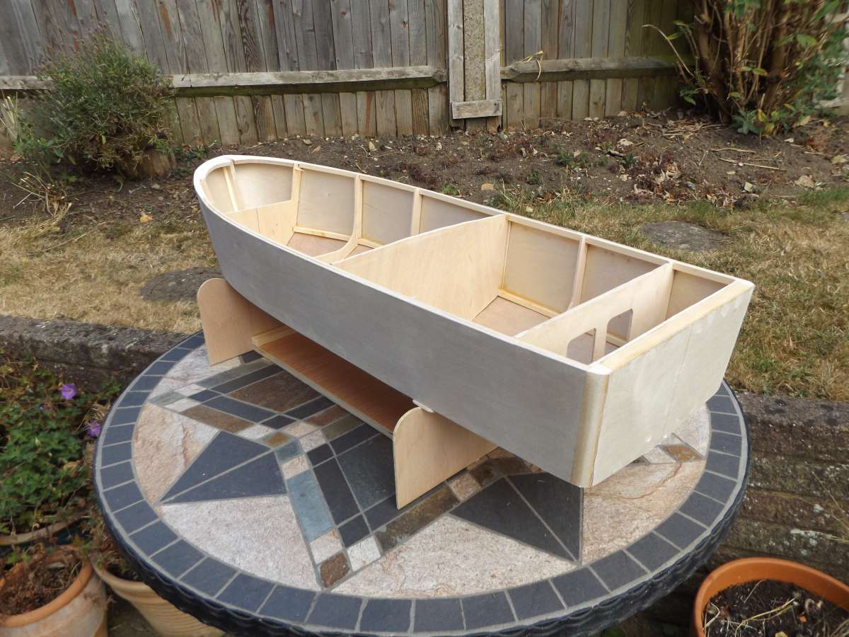

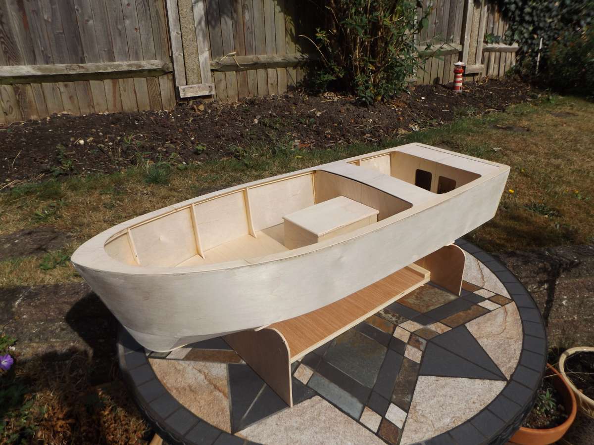

                        Well all this wet weather is certainly good for the building programme 🙂
                        Just a few fittings to fabricate and ready for paint shop .
                        Regards  RayInvicta 12 Portside wood work completeInvicta 14 Rubbing Strakes

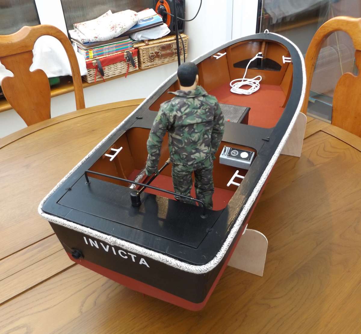

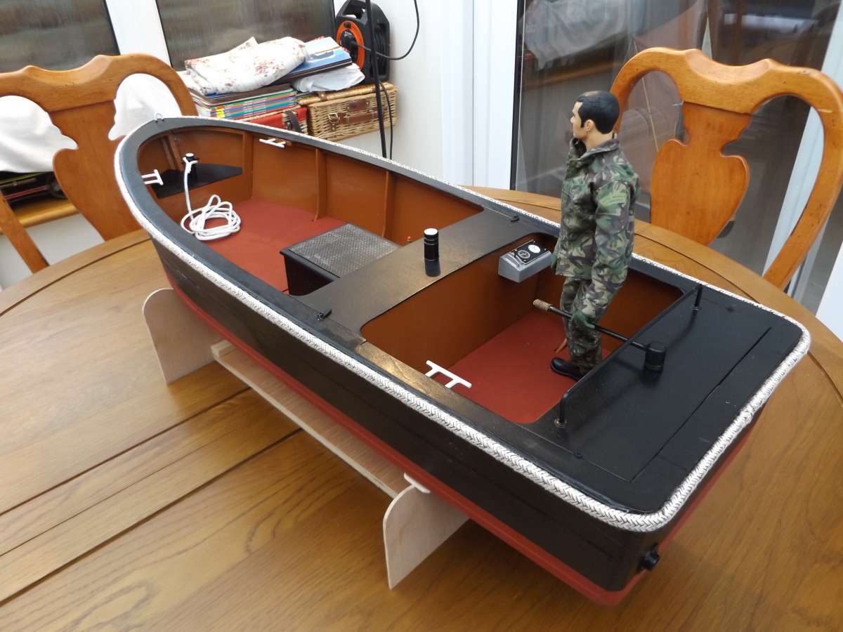

                              Invicta is ready for the water now just waiting for it to stop raining and blowing 🙂
                              Regards RayInvicta 17 241024Invicta 16 201024
                              #122901
                                Very smart.  The figure sets it off perfectly.  Is he fixed to the boat?  Wouldn’t want him going for a swim in choppy waters.
                                #122911
                                  Hi Richard,
                                  Yes his boots are super glued to the deck 🙂 but I must make him a buoyancy aid just in case !!

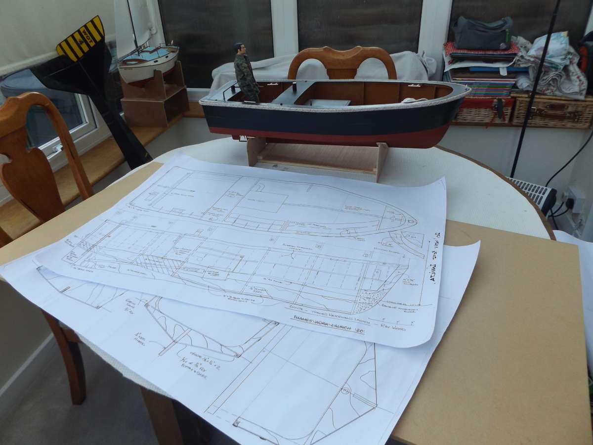

                                              I know it looks like I’m trying to do all the free plans in the magazine !! but this oneInvicta Drawing 180225 is on it’s way to Lindsey now 🙂
