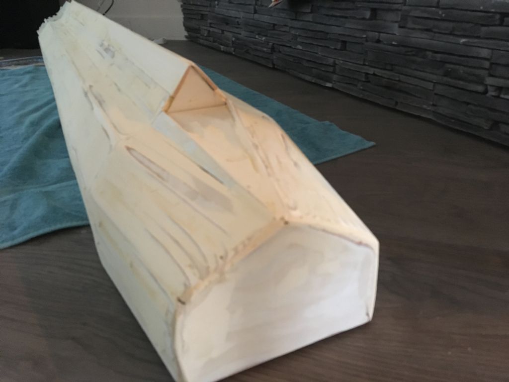

                                    Florian Hebekerl
                                      @florianhebekerl32192
                                      #90332
                                      Florian Hebekerl
                                        I didn’t calculate but guessed since it is very light still. I can pick it up with two fingers .
                                        #90333
                                        Chris E
                                          @chrise
                                          OK That is a very shallow underwater version of a bulk carrier so it will not have the weight problems that I envisaged with a full scale hull but it will still be heavy.
                                          #90334
