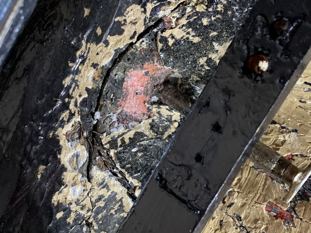

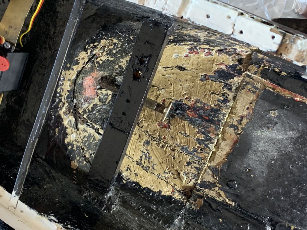

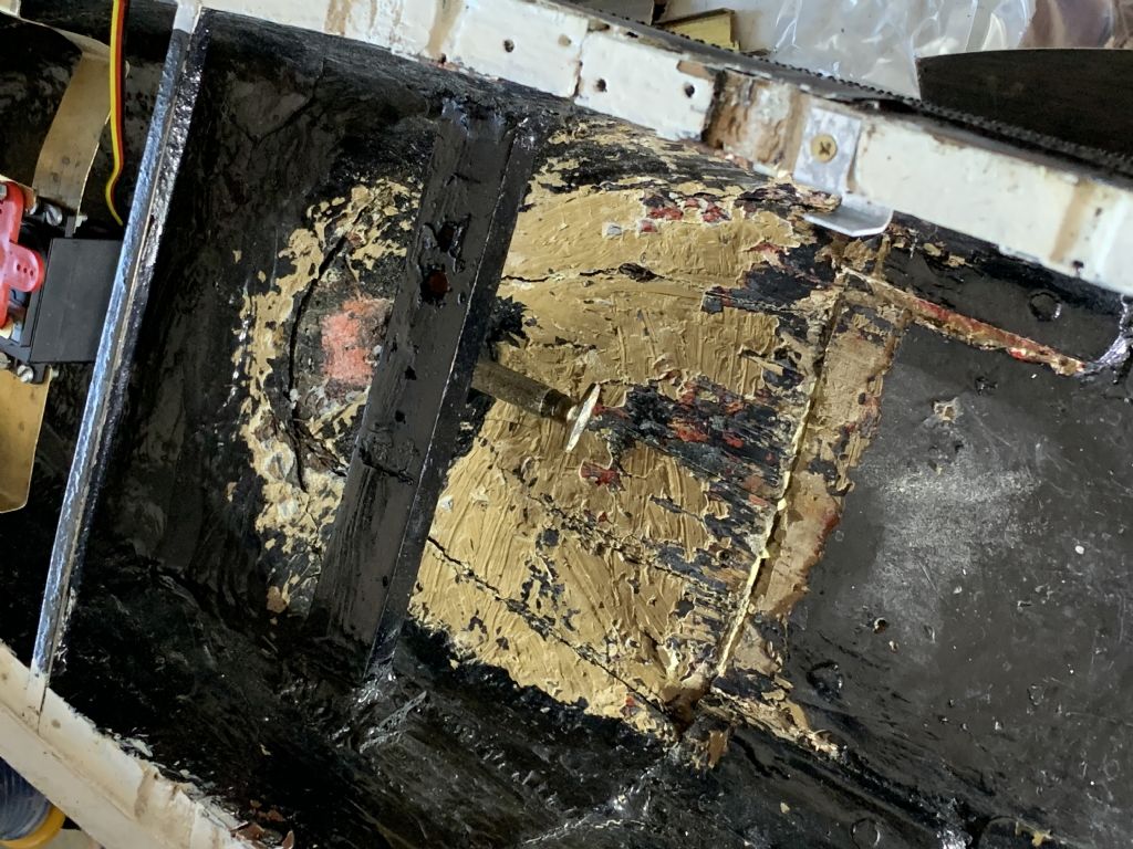

                              I have removed some earlier repair work that contained the point of entry of the water inside the boat and discovered some extensive damage and poor repair work in the past. I will upload a photograph tomorrow morning…
                              My feeling is that it will be important to stop the ingress from the outside and am considering using <https://www.rawlinspaints.com/home/metal-paints/metal-topcoats/3137-bradite-chlorinated-rubber.html&gt; in red (below the waterline) in keeping with ships of this type and era. I'm hoping that as a liquid rubber paint it will seal the hull after a few coats.

                              #95164
                              M Harvey
                                @mharvey34888

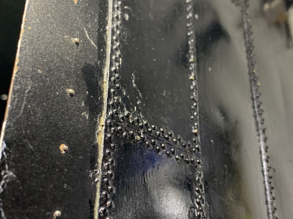

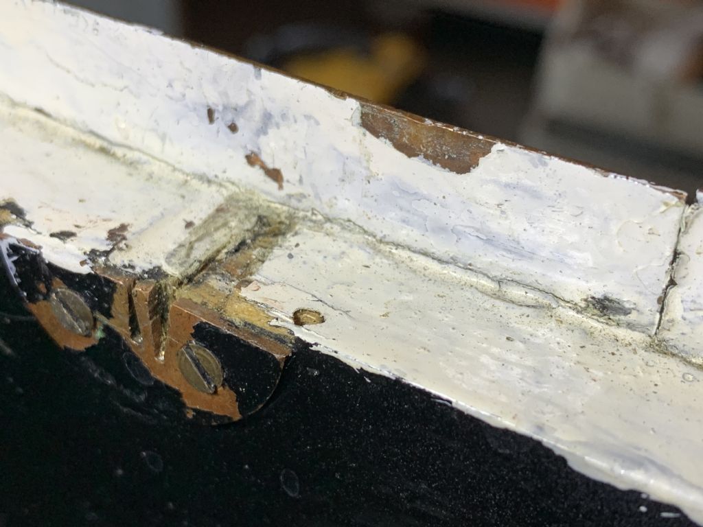

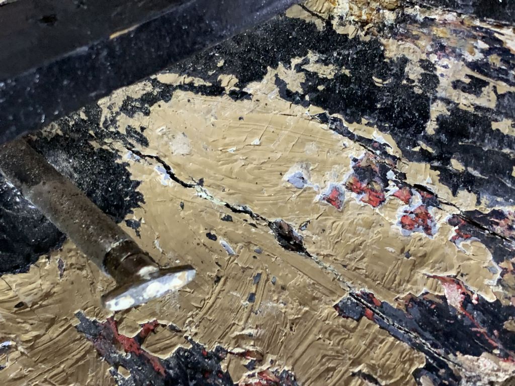

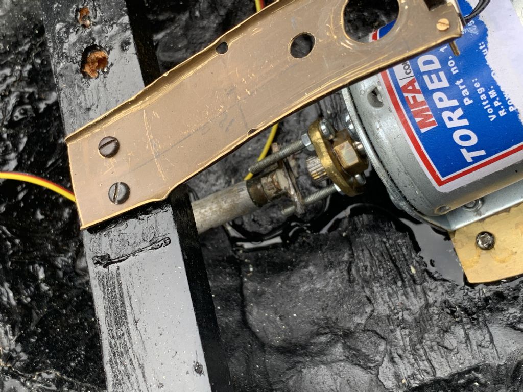

                                Hi Dave,
                                So I have uploaded some more images of the removed previous repair to the inside of the hull and some details of the metal outer hull.
                                Looks to be made from Brass??
                                It also looks like she has been torpedo from the rear now i have removed the previous repair work…
                                Any comments gratefully received.
                                Michael

                                  #95167
                                    Ooo er Michael! Scrape all that muck out, rough up the area and fibreglass/epoxy resin I think to fix that. Externally, just red oxide paint should do, although some epoxy run into any external cracks may be needed, although the resin from the fibreglassing should penetrate those.

                                    #95189
                                    Dave Cooper 6
                                      @davecooper6
                                      Yes, Ashley's scraping method sounds like the way to go.
                                      You may need to go easy in places though as you could go straight through ! I would do a couple of test patches first, then come back to us with some more photos. (It may just be brass-plated steel or similar…)
