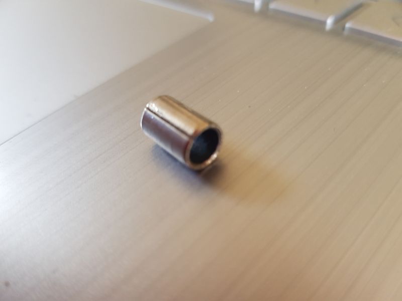

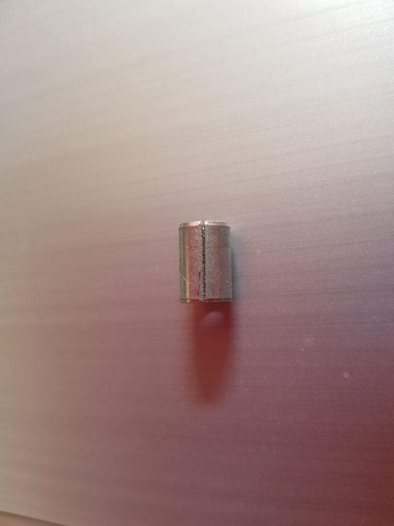

          20220928_115408s.jpgJust out of interest, these were the bearings fitted in my Surfury. I bought half a dozen at the time. They were from America I believe and made to an imperial size. They are split down their length and close up to the shaft size when fitted. They were advertised as frictionless and are white metal lined. Provided a white metal bearing is well lubricated with clean oil , they will last a long time.
          In my working days we used to re-metal white metal journals for shafts 10" in dia and then have to hand scrape them to a final fit. How things have changed!
