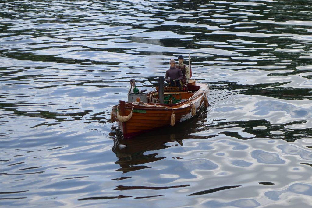

In the afternoon I decided to have another go. Steam was raised and the engine dropped in the water. It went really well! Good performance, engine control working perfectly and water level working fine as well. I thought I would take a couple of shots for the magazine so asked someone to bring the model past while I crouched down with my camera. Two shots before I discovered I had forgotten to put the card in the camera!
