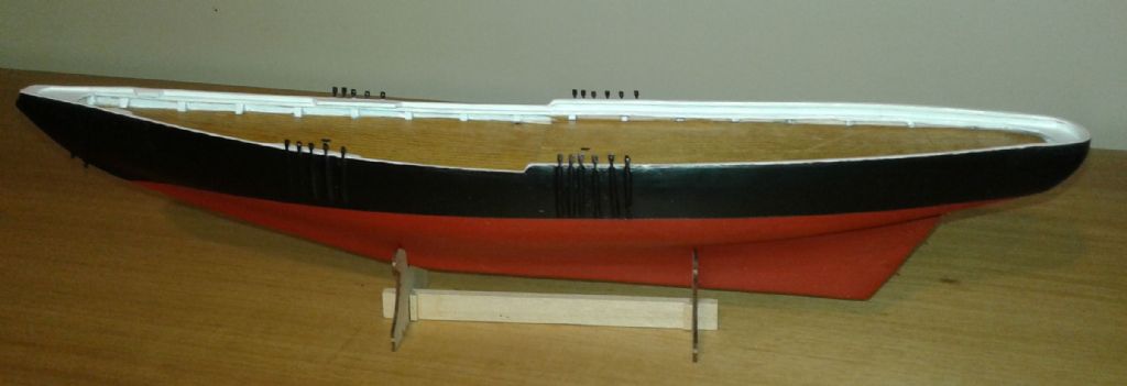

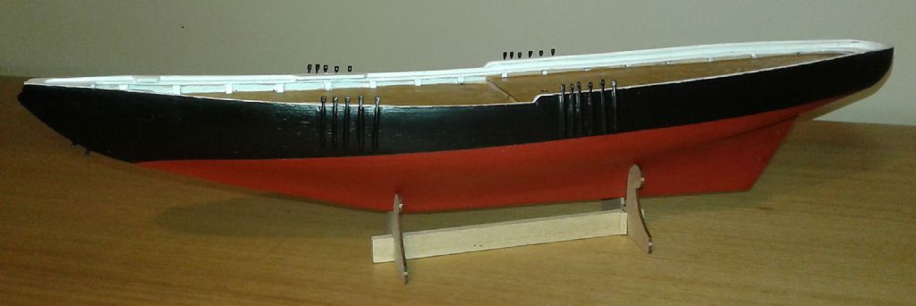

      Is there any chance we might be treated to a photo or two of the now painted hull?!

        Hi Mattias
        What a great idea to sew the 'lines' using a thread coloured a few shades darker than the cloth supplied. I really didn't like the look of models I had seen and images of the real boat do not show the joins nearly as much which looks a heap better.
        Here are a couple of photos taken with my mobile phone camera. You will not the rudder has not yet been attached and the white 'water line' not yet applied. Also there are areas of the aft area on the sides below the rail not painted – they were just too small for me to attempt to paint. The line between the white rail and the black sides of the hull are not particularly good either but I just can't get those improved.
        I will now work towards applying the 2mm white pinstripe at the water line, attach all the stuff on the deck. I have decided to get some 'blackener' to apply to the chain and also the eye bolts and also the copper wires supplied for the deadeyes and winches etc, Hopefully that will arrive before Easter.
        Once again I have had to resort to peering at the videos on deck of the real Bluenose to better understand where many of the eyebolts are attached to the rail and deck as the plan is NOT 'user friendly' and also appears to show more eye bolts that what are supplied and in places which don't seem to be correct. For example the plan of the deck appears to indicate that there are at least 4 eye bolts which I have no idea why. If you still have the plane have a look between the main mast and stern at places marked 34 and 38. All the plan shows is a small circle which appears to be an eyebolt. There also are marked each side of the helm something I have no idea what. Some places have what appear to be a 'wooden block' or pulley. I have to continually compare the deck plan with the side view to work it out. I guess once I have finished this model I will be better 'equipped' to build another although I'm not sure if I ever will although I am getting a lot of satisfaction building this one (together with a lot of frustrationfrown)
