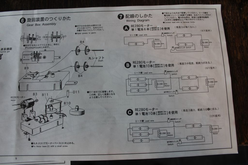

      I have a part built Doyusha 1/250 scale IJN "Yamato", and my question is can I just stick an RE280 motor on the end of the gear box and use the kit supplied gearbox and props? If so what voltage motor should I use and how do I the RC control the whole thing?

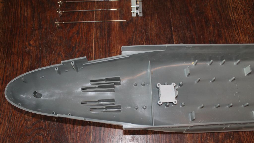

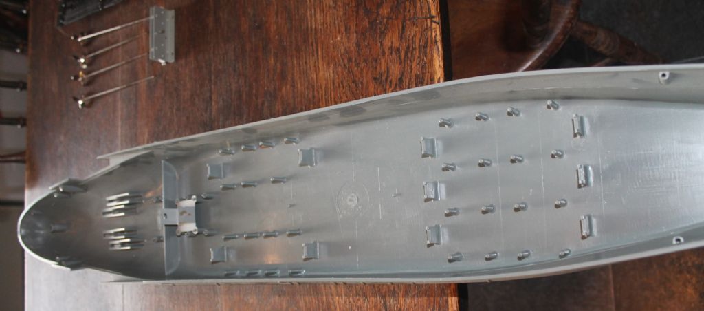

                      #92440
                      john hutchinson 1
                        @johnhutchinson1
                        #92441
                        john hutchinson 1
                          @johnhutchinson1

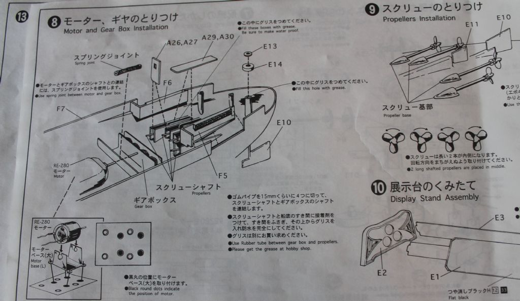

                          Firstly thank you for the replies! Photos of the hull and the instructions. The "one in/4 out" gear box is shown with the props as supplied, and sits on the 4 mounting points to the left of the motor base plate. I assume the second gearbox [6 on the plan] is to drive the radar as a long square rod is slotted into it.

                            Are the tubes moulded in the hull and all you get is the shafts?
                            #92447
                              The running gear they supply looking at the photo ie stern tubes looks like a wire in a tube with is not up to the task of 280 power in my view ? we are in danger of over thinking this ! is there anything wrong with 1 motor and the gearbox supplied ??
                              #92448

                                The props are fixed to the ends of a rod which passes through a tube and attaches via rubber tubing to the gear box.
                                I was thinking of using a replacement propshaft and prop [x4 ] with 4 separate direct drive motors running off 1 or 2 speed controller[s], but the M4 stuff I have for another project [LCM6 as seen in the last few magazines] seem far too large.
                                #92449
                                john hutchinson 1
                                  @johnhutchinson1
                                  My concern over the current set up is how good is the metal used for the props, shafts and tubes and will find it all rusted together after the first voyage.
