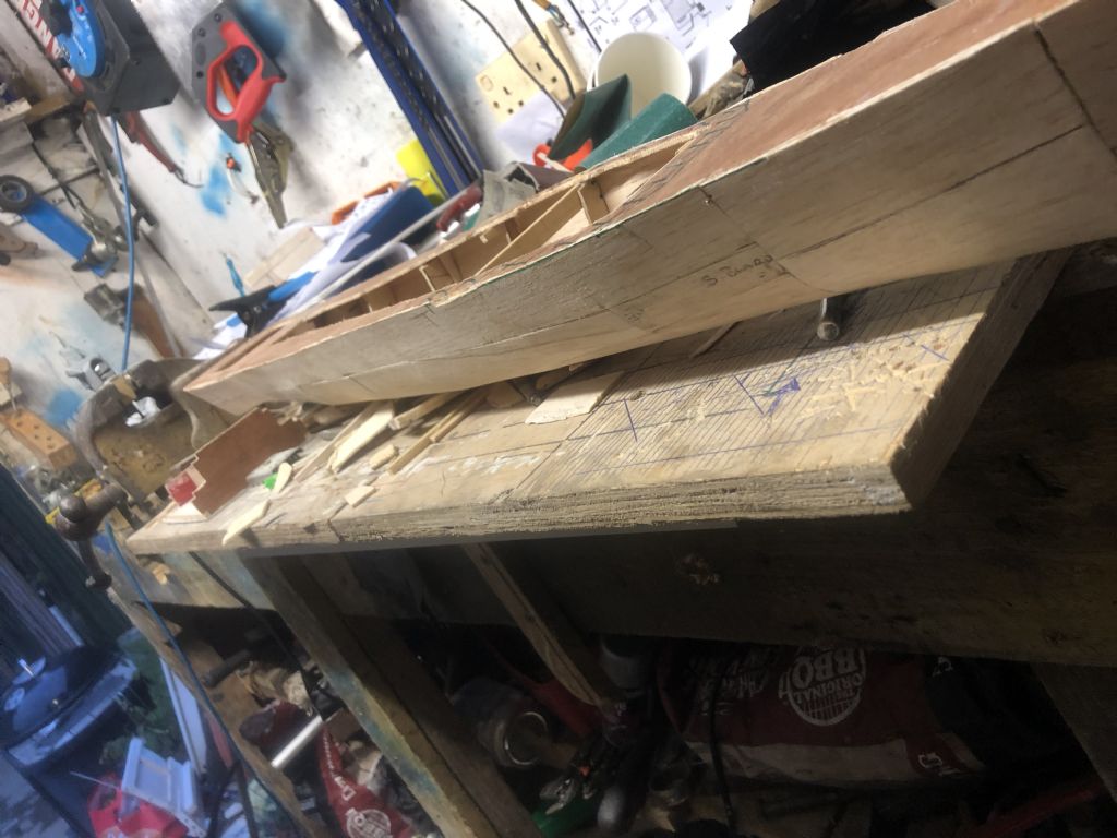

      First of hello! I've always tinkered around with 'stuff' I have rc gliders, nitro cars and planes, a Thames Barge (completed about 30 years ago when I was 14-ish&#128584
      I have taken upon myself to build a ship of resemblance to Barbaros class frigate. Why? I liked it and had a 'scale fail' three times attempting to do the Bismarck… opted for a gentler taxation of thought!
      Now many here will hold their hands up in sheer horror whilst casting scorn and grabbing their pitchforks… to which I am happy for them.
      It's not (well kind of is😂&#128584 about that
      perfect scale finish and complete look of authenticity but its about the road which is travelled to reach the end result! Anyhow.. here's 1 or 2 pics as it nearly looks now… oh and the hull is perfect mm by mm checked with a fixed jig thing and digital vernier's. 😯😎👊🏻

              Hi Stephen. Keep us posted. Hull shaping up ok…the carcass is ply ? and if so of what thickness?
              I would say that smaller modern warships like this can be a bit tender/unstable/wobble quite a bit, and an effort should be made (when you get there) to make the superstructure as light as possible, and similarly get the battery as low as you can. Personally I like to fit oversized bilge keels/fixed stabilisers as this can greatly help to prevent rolling, but this is a personal taste thing.

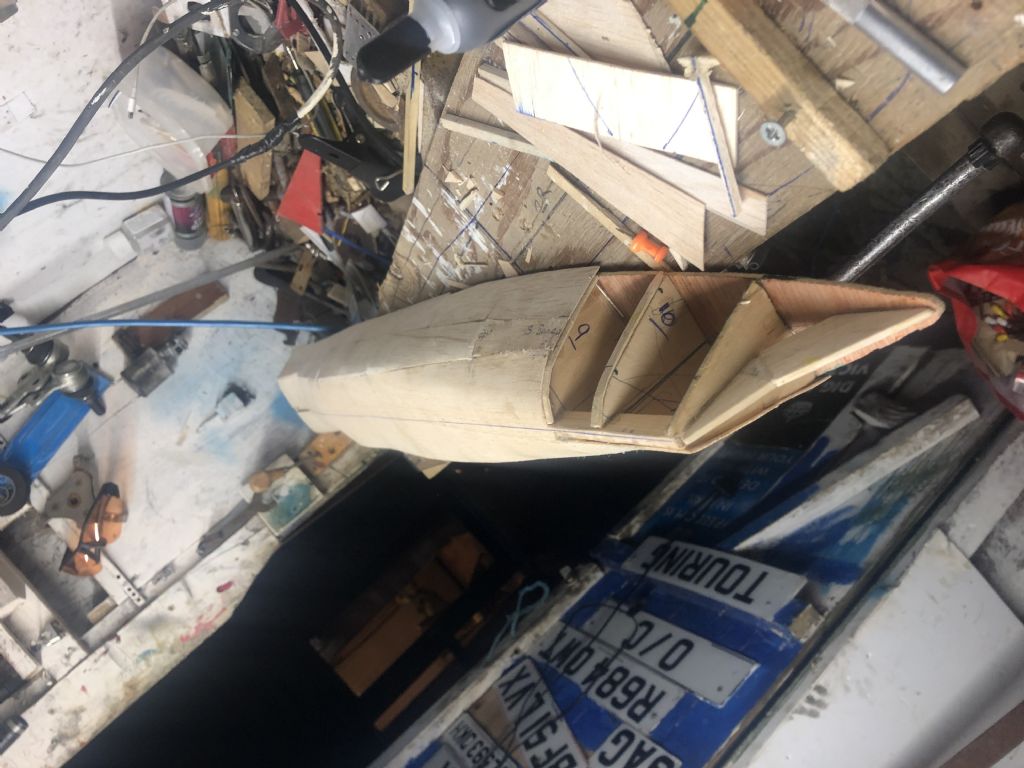

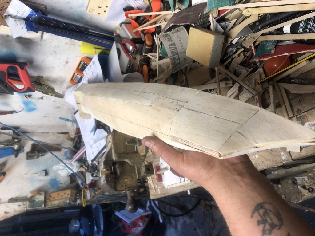

                Thank you Ashley, advice is always well received. I have been making the superstructure from thin Balsa, 4mm square and 1/32 sheet. the hull formers-ribs? 🙈 are 3mm ply I kept the front three solid to make it more rigid. The deck which is visible will be cut and trimmed to leave a 10mm edge which the real deck will sit flush to and allow me to ensure as watertight a seal as possible.
                Battery choice was to be lipo's slong each side at almost keel line (10mm internal from outside if that makes sense😂
                Motor wise is giving me the biggest confusion, it wants running on two screws with central rudder but not sure on motor choice ss yet.
