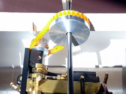

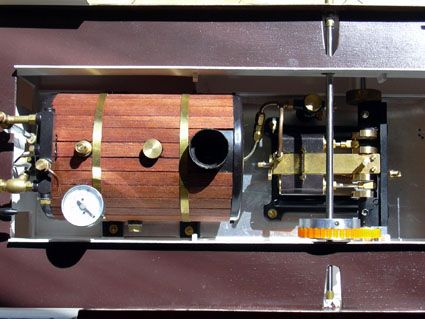

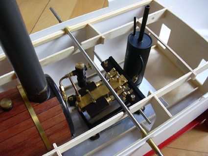

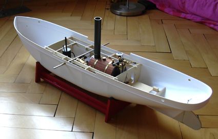

                Here is a short summary about my Glasgow project.
                The steamer is going to be powered by a horizontal oscilating steam engine of the German manufacturer Regner The plant is pretty similar to the former Cheddar Plover Paddle, which I originaly wanted to install. But, as you probably know, Cheddar is gone..
                The quality of the Glasgow-kit is very good and if you go with the instruction you wont have to expect big problems. If you are going to power the boat by a steam engine, you should cut additional openings into the bulkheads (to make sure that there will be enough oxygen for the burner).
