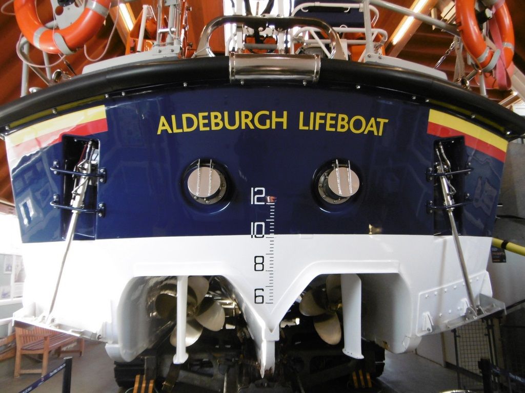

      Maybe too late now but I took this shot of Aldeburgh's Mersey last Autumn.
      Not a Tyne I know.

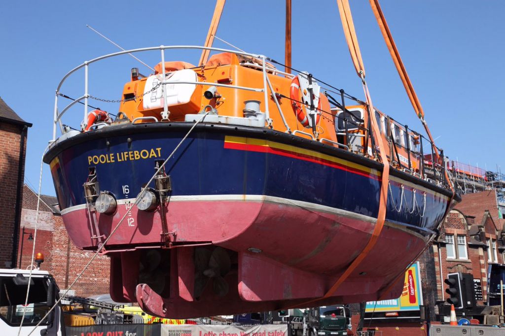

                  I wondered if this photo could throw some light on the tyne class stern.

                      Looking at the picture of the Tyne as above, one wonders why they didn't go the whole hog and make the props inside proper tunnels?? Surely would have been more efficient…or perhaps this would have taken too much design time up??
                      ​The new Shannon ones have jet drives now.

                        thank you for the pic of the tyne boat, i actually have that picture on my pc now , i have improved the position thus the angel for the shaft but in the process butchered the hull, so a far bit of repair work to be done, very steep learning curve though.

                          i want to cover the brass rudders on my tyne class lifeboat, making them look much like the ones in the photo above, has any one done the same if so, can you give me some pointers or direct me to videos, i have a couple of ideas but looking for inspiration ..
