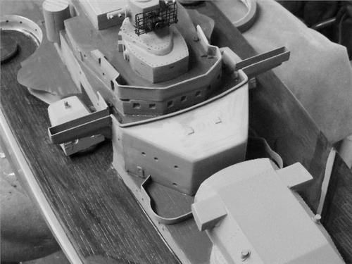

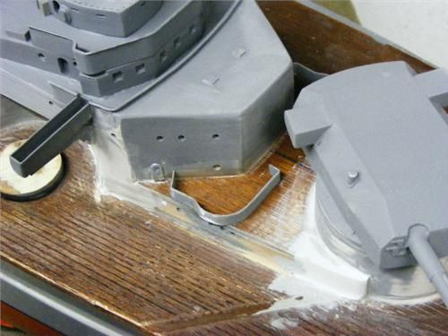

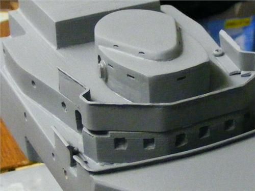

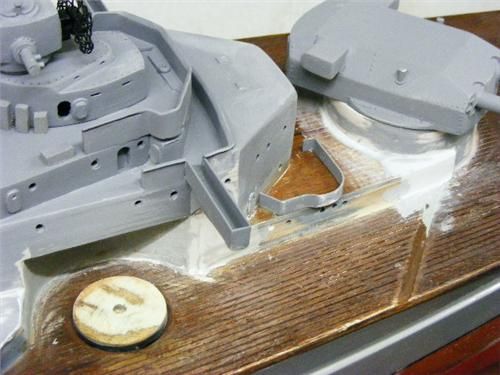

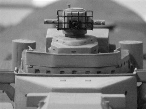

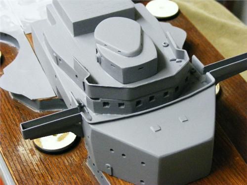

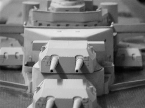

      hi i see what you mean im content just for it to look like it should it looks solid but only the top is a solid piece(thanks to my bandsaw) took some more pics as its going along ,dont have good plans so its a bit make it up as you go.your superstructure must be time consuming to make?
      http://www.modelboats.co.uk/wp-content/uploads/sites/5/images/member_albums/3926/oct_035.jpg
      http://www.modelboats.co.uk/wp-content/uploads/sites/5/images/member_albums/3926/oct_037.jpg
      http://www.modelboats.co.uk/wp-content/uploads/sites/5/images/member_albums/3926/oct_036.jpg

        Hi, It didn’t take as long as I expected to make, of course I was rather caught up in seeing if my idea worked and it is very light.
        I used a number of reference sources, one inexpensive one was the paper back book " Battleship Tirpitz", one  of the Conway maritime modelers series by Gerhard Koop and Klaus Peter Schmolke proved invaluable. There is quite a lot of stuff on Bismarck in the book as well as some excellent plans and great photographs. Robert Ballard’s Discovery of the Bismarck book was very useful too.Some of the pictures show areas of the ship that were difficult to understand in the main plan. It was the hanger areas and boat decks that I found quite difficult to find understandable pictures of.
        By the way I think your progress so far looks really good, there is already that sense of massiveness coming, Bismarck is graceful and elegant but there is an underlying weight to her features. I love your open doors, I should have thought of doing that, but these are the wonderful differences between models that make them individually so interesting.

        Gary Rowe
          @garyrowe80914
          hi modelman
          what have you used / how did you get the roll top edge on the bullwalks in front of the forward conning position
          amazing progress
          gary

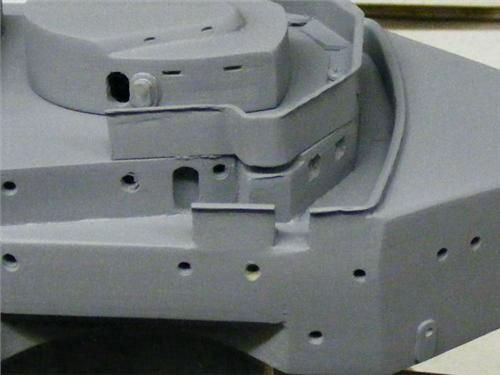

                its not a race to finish the build but i only use materials im used to working with wood/metal/filler etc cutting out the bridge wings/supports and fitting was tonights playtime about 2 hours all in inc paint and fitting more doors its not a 24/7 job .it must be said so much can be made thanks to aldi,s bandsaw in such a short time the bridge wing supports are 5mm aluminium plate cut with bandsaw 5mins inc drawing light file and hey presto ready to fit ,not as time consuming as you might think making things.im not too worried about the weight so im not limited to the type of materials i have at my disposal to construct my ship.it is nice to see other builds and get a different perspective so keep em coming

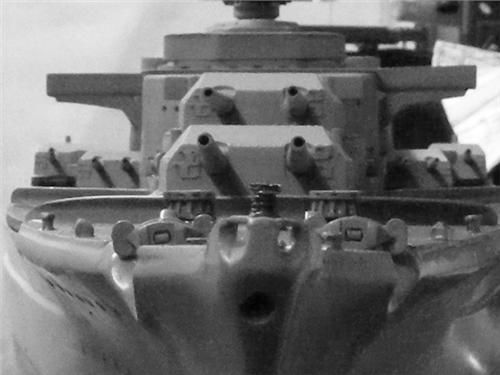

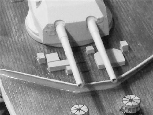

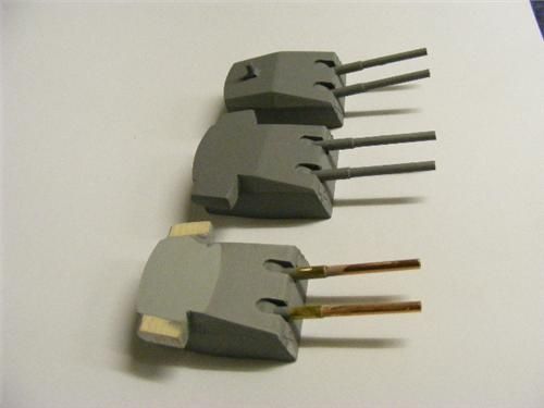

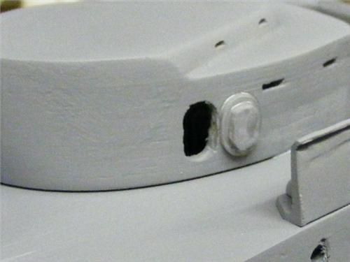

                  just added a little more the forward fire control 7m range finder
                  http://www.modelboats.co.uk/wp-content/uploads/sites/5/images/member_albums/3926/nov_011.jpg
                  http://www.modelboats.co.uk/wp-content/uploads/sites/5/images/member_albums/3926/nov_008.jpg

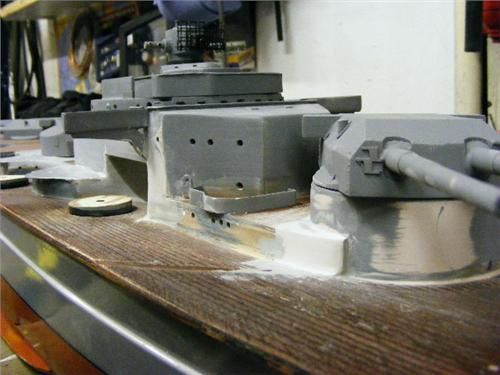

                        Rough and certainly not ready

                          #17206
                          Modelman
                            @modelman

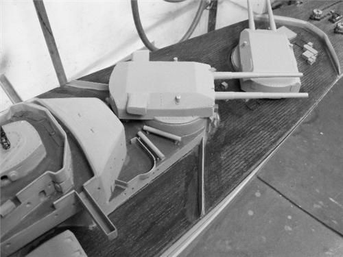

                            hi gary  used plywood and a hole saw for the barbettes,have you done anymore to your build

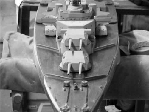

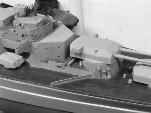

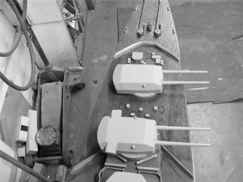

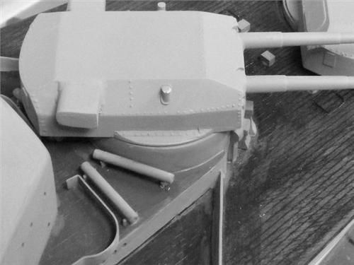

                                        http://www.modelboats.co.uk/wp-content/uploads/sites/5/images/member_albums/3926/nov_039.jpg
                                        http://www.modelboats.co.uk/wp-content/uploads/sites/5/images/member_albums/3926/nov_032.jpg
                                        http://www.modelboats.co.uk/wp-content/uploads/sites/5/images/member_albums/3926/nov_039_0.jpg

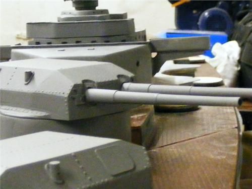

                                        here you go this may inspire you,ive gone all period with the photo,s.didnt realise you were making such a detailed build it will be nice to see some pic,s.my build is just a broad representation in stand off scale as you can see but i have a lot of detailing to do.

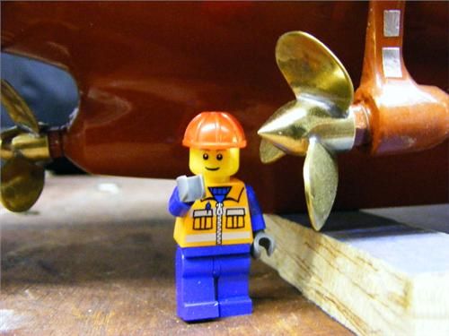

                                            http://www.modelboats.co.uk/wp-content/uploads/sites/5/images/member_albums/3926/dec_008.jpg
                                            http://www.modelboats.co.uk/wp-content/uploads/sites/5/images/member_albums/3926/dec_011.jpg
                                            http://www.modelboats.co.uk/wp-content/uploads/sites/5/images/member_albums/3926/dec_009.jpg

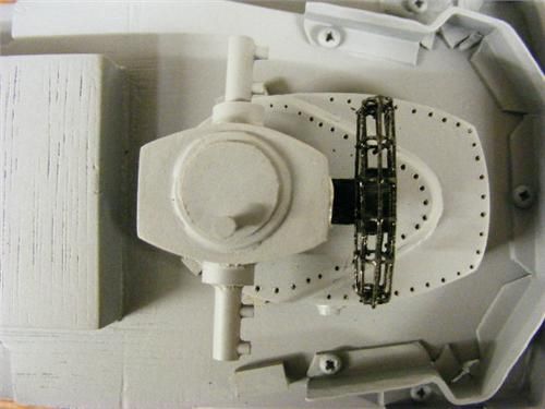

                                            started adding a little more detail

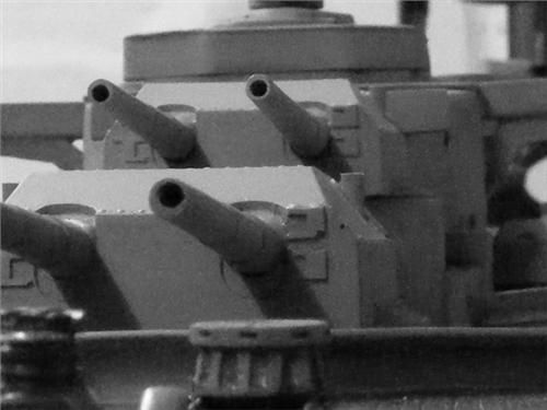

                                              crude but getting there
