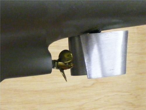

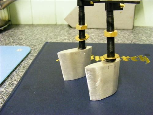

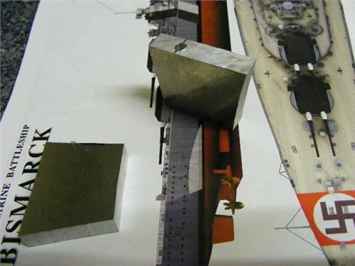

                just started making rudders out of 10mm aluminium this is how i want them to look (picture) when finished
                #15567
                Modelman
                  @modelman

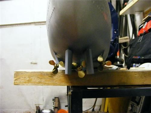

                  and here they are filed ready to fit
                  http://www.modelboats.co.uk/wp-content/uploads/sites/5/images/member_albums/3926/home_aug_032.jpg
                  http://www.modelboats.co.uk/wp-content/uploads/sites/5/images/member_albums/3926/home_aug_035.jpg
                  and just like magic here they are fitted, made slightly longer on purpose to help steering .having to save up for some good 1/128 plans to help with the rest.

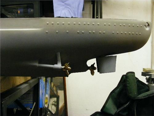

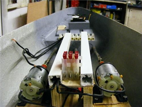

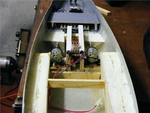

                        more drilling cutting and filling
                        http://www.modelboats.co.uk/wp-content/uploads/sites/5/images/member_albums/3926/home_aug_039_0.jpg
                        http://www.modelboats.co.uk/wp-content/uploads/sites/5/images/member_albums/3926/home_aug_038.jpg
                        http://www.modelboats.co.uk/wp-content/uploads/sites/5/images/member_albums/3926/home_aug_037.jpg
                        but the motors fit just wiring now
                        #15748
                        Gary Rowe
                          @garyrowe80914
                          morning

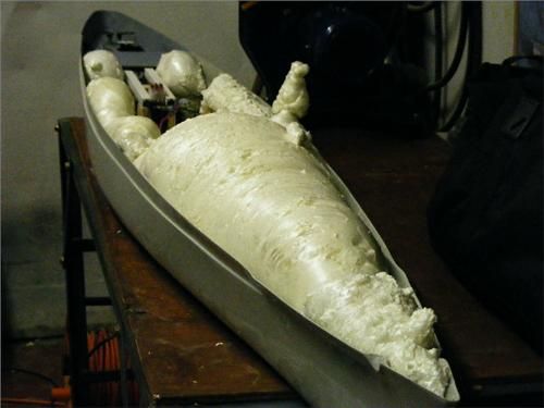

                          you have done more work in the last week than i have in the last 9 months can you send photo 3 from a different angle
                          gary
                          #15770
                          Modelman
                            @modelman

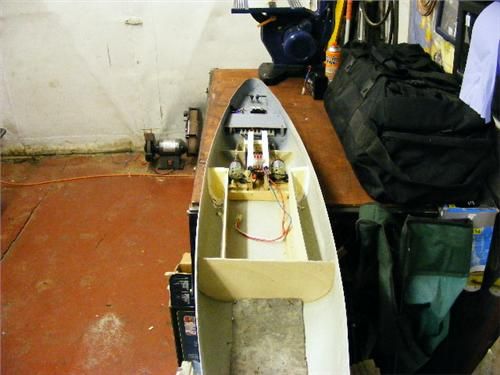

                            no problem will this do, dont take too much notice its not finished yet the cavitys where the shafts are and most of the hull will be filled with spray foam/filler.i can retreive a stranded boat but not a sunk one!!!!

                              don’t get carried away with the foam in the summer it gets warm expands and blows your deck off

                                  @modelman

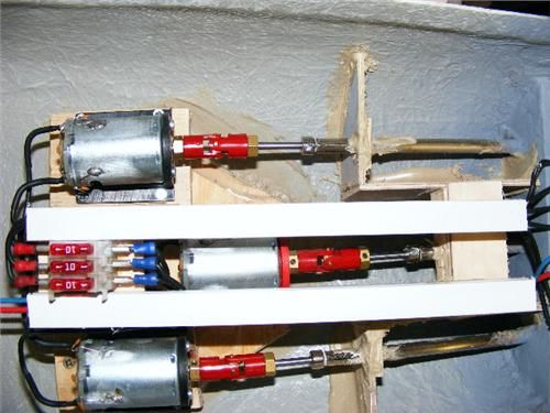

                                  few more pics showing sub division ready for filling and trimming and lead sheet in bottom to equalise ballance.if you checked previous link you know it will soon be getting wet,video will be posted later. bye for now

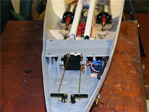

                                    can you show us your rudder linkage
                                    gary
                                    #15823
                                    Modelman
                                      @modelman
                                      hi mate will this do no complicated linkages minute adjustment can be made on shaft clamp the simpler it is the less can go wrong.

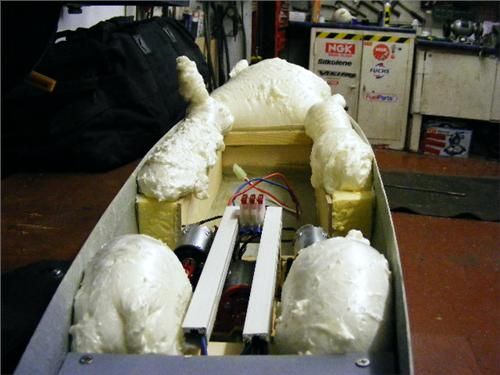

                                        foam filling forgot how much it swells lol
                                        http://www.modelboats.co.uk/wp-content/uploads/sites/5/images/member_albums/3926/home_aug_064.jpg
                                        http://www.modelboats.co.uk/wp-content/uploads/sites/5/images/member_albums/3926/home_aug_066.jpg
                                        now its cut down it dont look so bad just needs capping lots of expansion grooves cut into foam(but not very visible)

                                          #15833
                                          Gary Rowe
                                            @garyrowe80914
                                            hi
                                            whats that little blue thing next to the rudder?
                                            did you look on the fleetscale website and compare sizes yet?
                                            gary

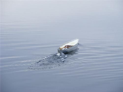

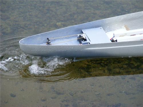

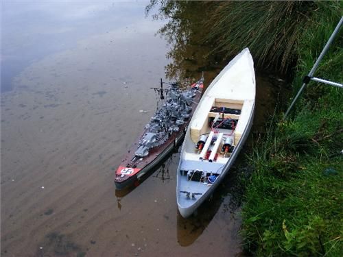

                                                  sorry gary i meant fleetscale picture of bismarck build .take a look took it on water,for first time used my 1/200 bismarck as a tug towed the hull out then used the fleetscale hull to tow bismarck back.decided all was well and let it loose no problems encountered,heres a few snaps i will post a link to you tube later you can see for yourself.i used the electronize motors 35mm props and 6volt sla battery very pleased with results makes my 4 foot bissy look small bit excessive for a tug dont you think,lots more lead ballast reqd,20+kilo me thinks.

                                                  #15853
                                                  Gary Rowe
                                                    @garyrowe80914
                                                    hi pete
                                                    that is the best feelin in the world when your baby first gets wet under its own power.
                                                    all that foam has not left you much room for the interesting bits sound smoke guns lights.
                                                    don’t forget to seperate your clean and dirty wireing RX as far away from other stuff as possible
                                                    gary
