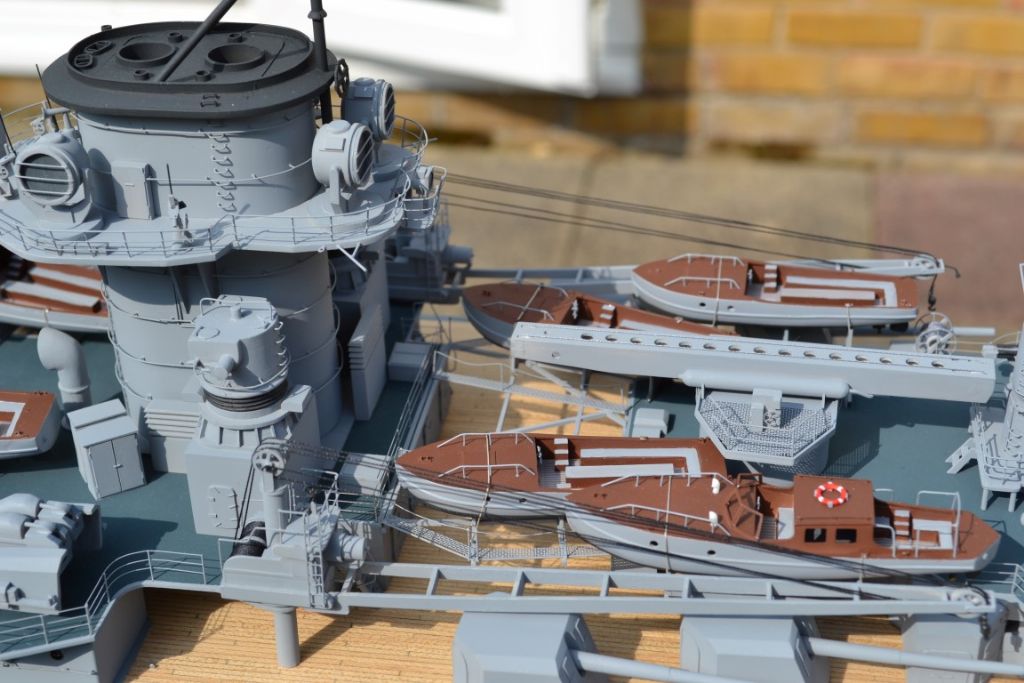

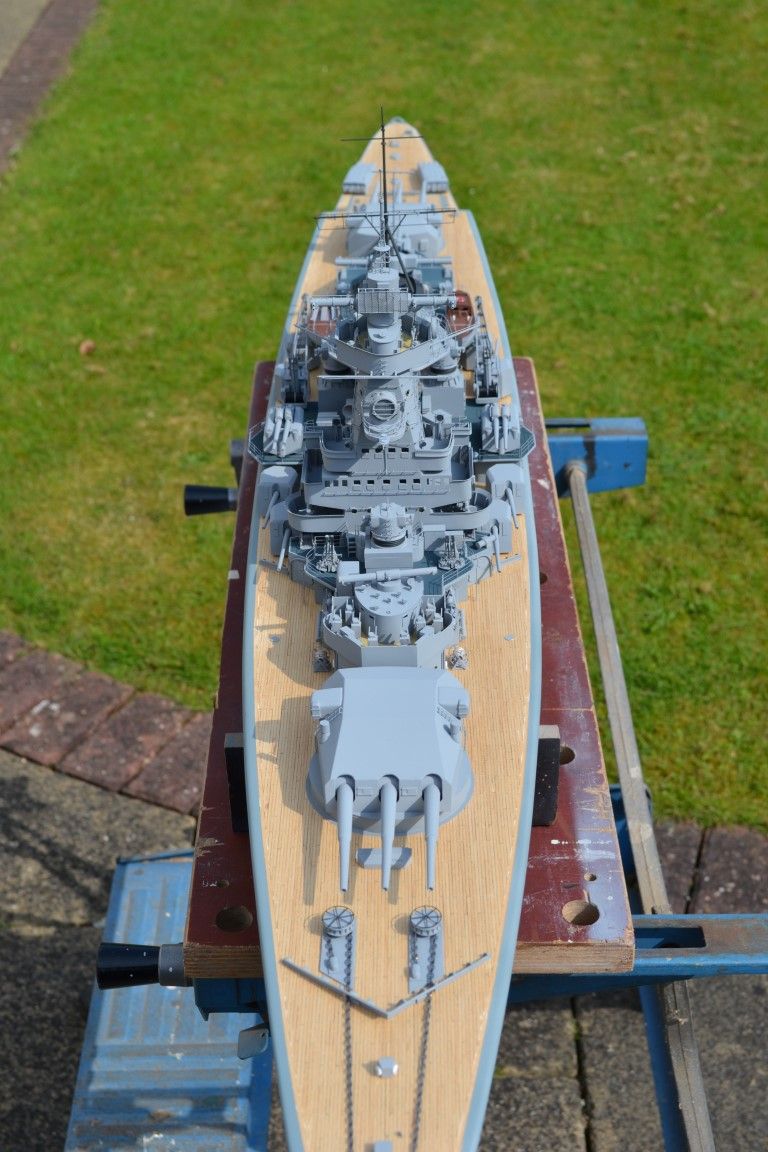

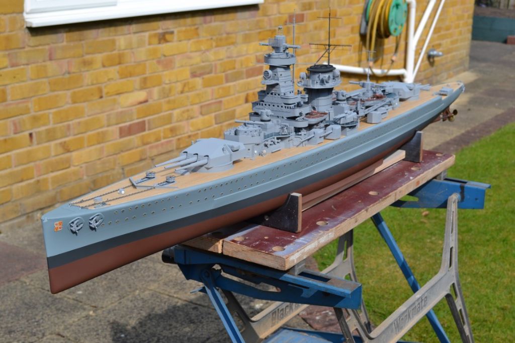

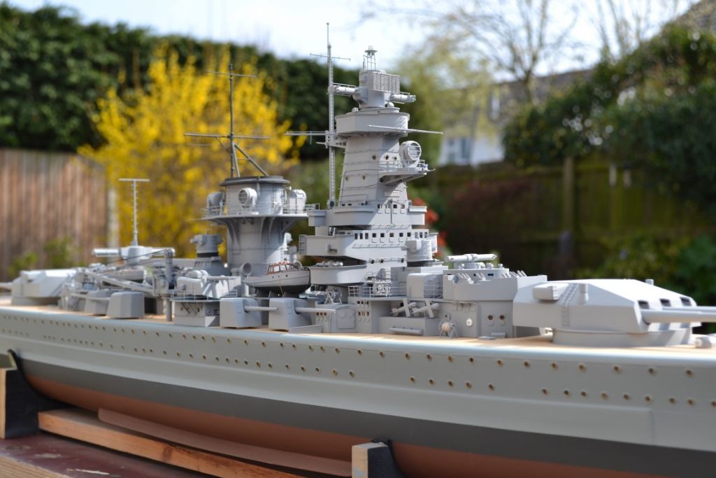

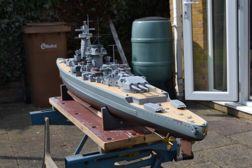

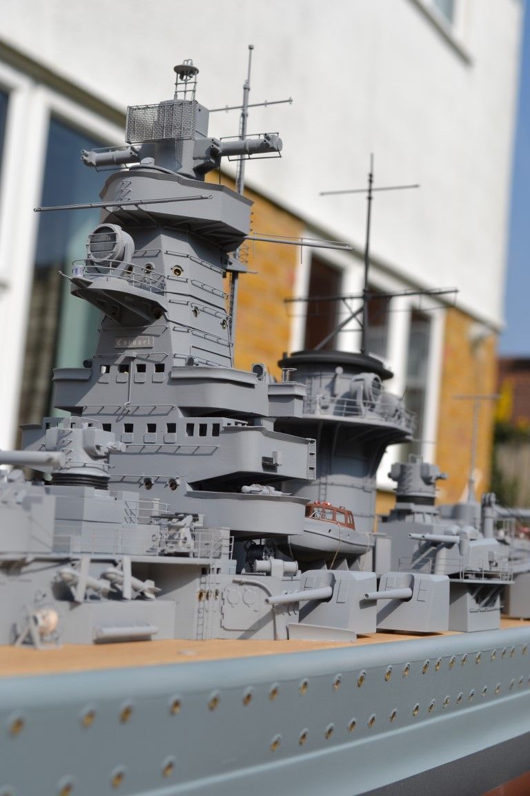

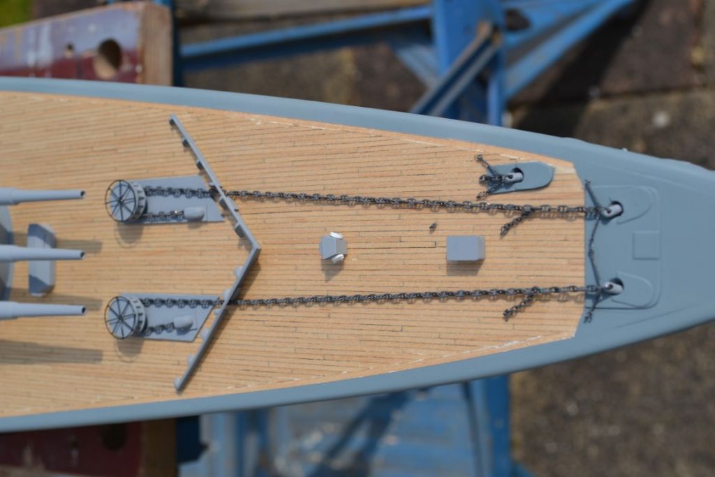

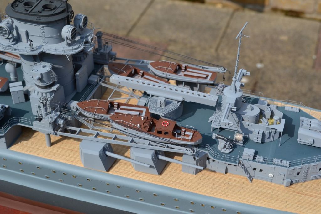

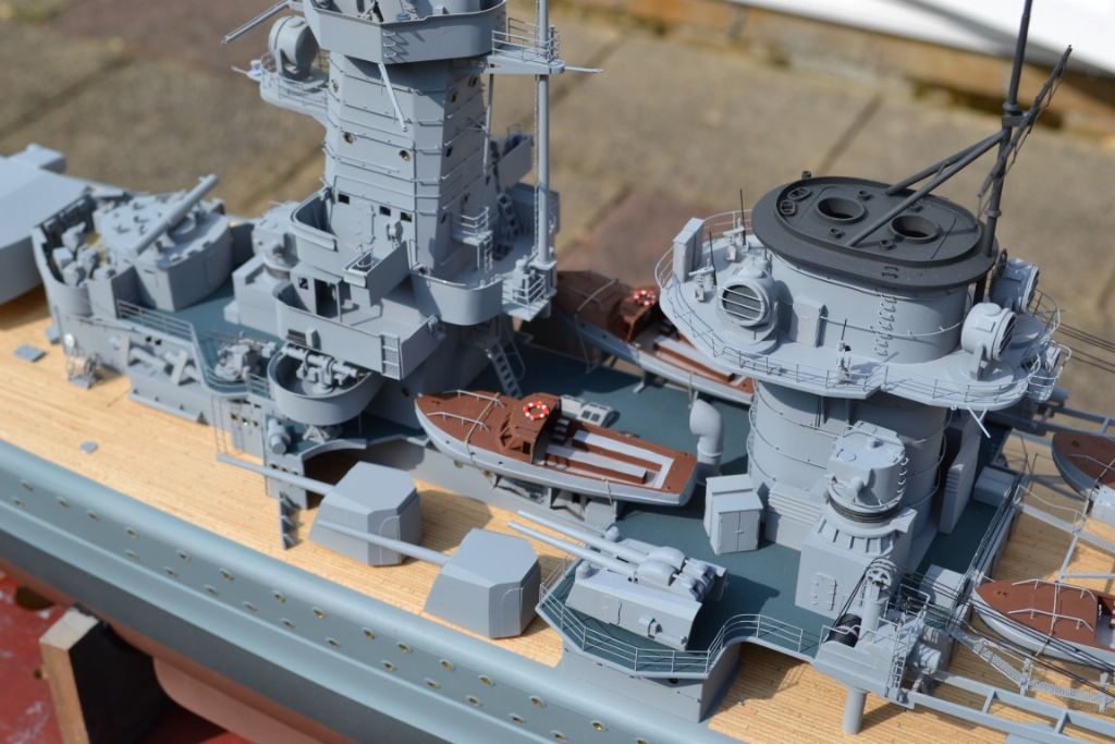

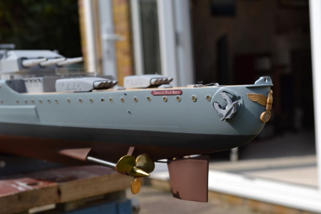

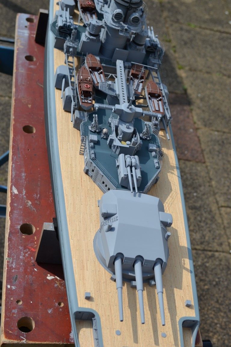

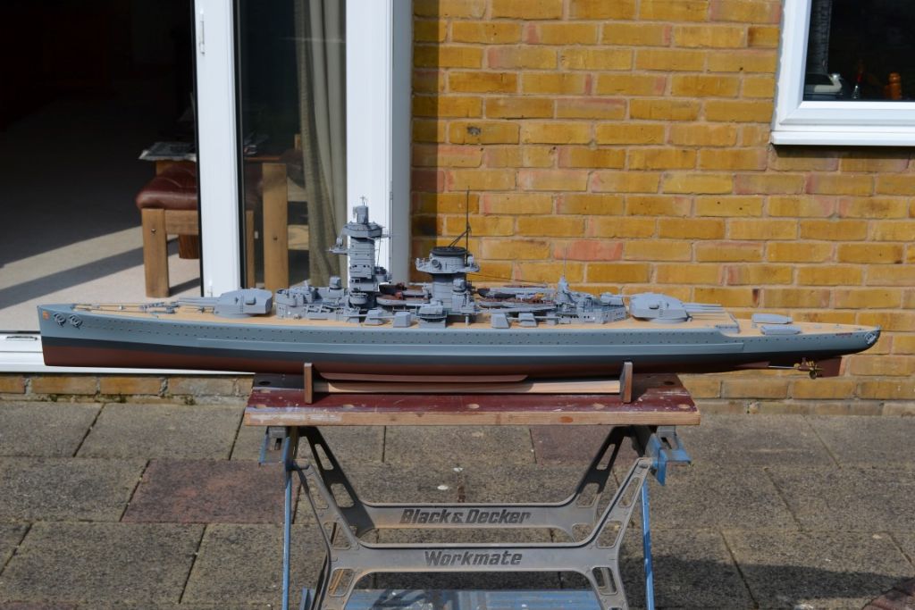

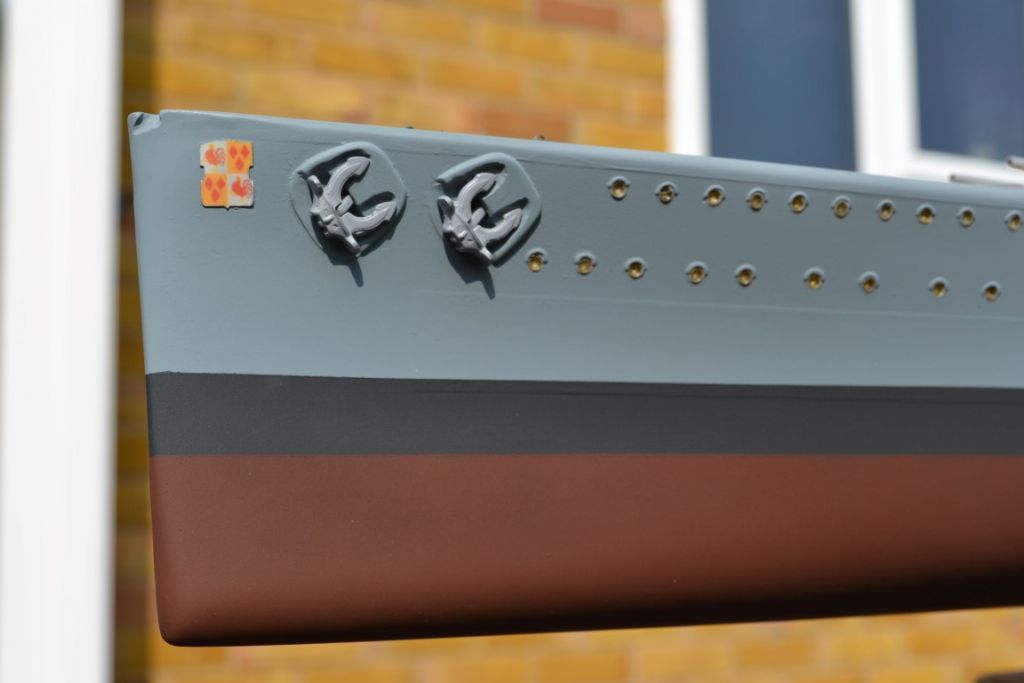

                      Hi all. I have been working hard on the AGS over winter and have now reached the stage where it looks like a ship. As the serious sailing and holiday season approaches I have to put the AGS on hold for the time being. I also need to repair one of my other models ready for various Surface Warship Association outings. AGS is about 90% complete requiring main deck stanchions/railings; all the rigging; the mounting of the two cutters and all of the deck edge things like bollards which will be installed once the stanchions/railings are finished and oh yes the tricky painting of the Arado Ar 196. 1400 hours so far.
