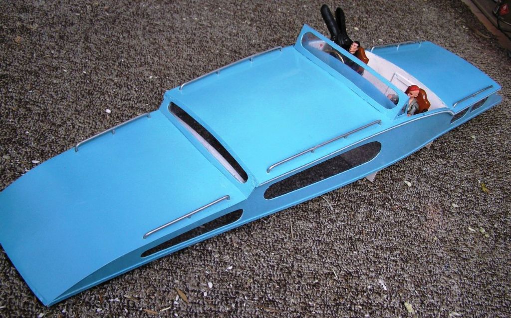

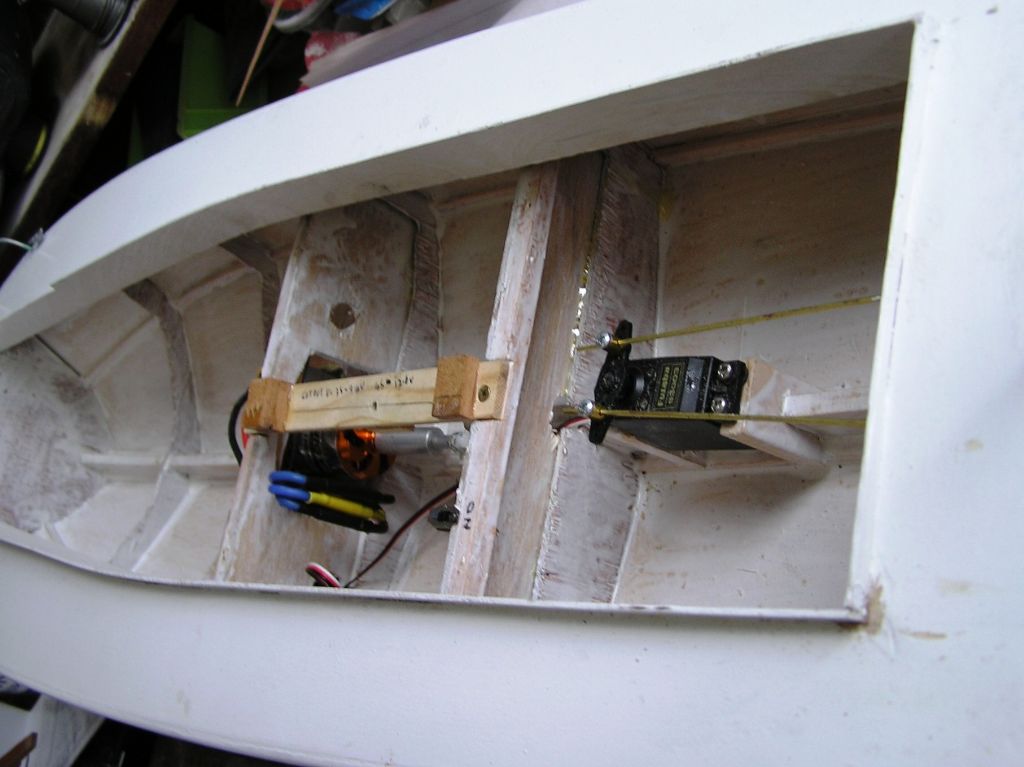

            harry smith 1
              @harrysmith1
              insides.jpgHi Chris
              A few pics of my Sea Commander built on the same idea.
              Very easy to work on and the cabin locked down by double 10mm magnets
              #69762

                        Posted by harry smith 1 on 05/02/2017 22:59:18:
                        insides.jpgHi Chris
                        Thanks Harry, yes that's similar to how I'm going to do it.
