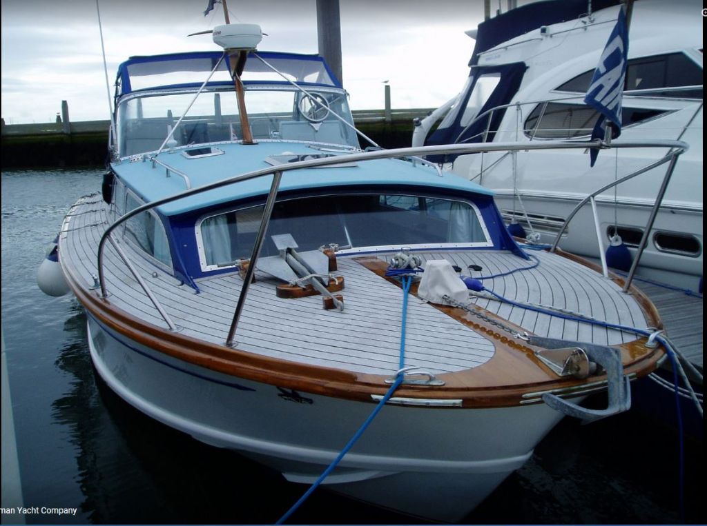

        The king plank and edging and the planking is being done with reference to photos of the real thing. They do vary a bit from boat to boat as many have had the decks replaced. The outermost plank doesn't go round that final bend to the bow but finishes as shown.
        The second plank was quicker and easier to glue in position as you have the first one to push up against.
        Photo attached of the Swordsman Tireur showing the bow detail which I'm using for the Huntsman and Swordsman builds.

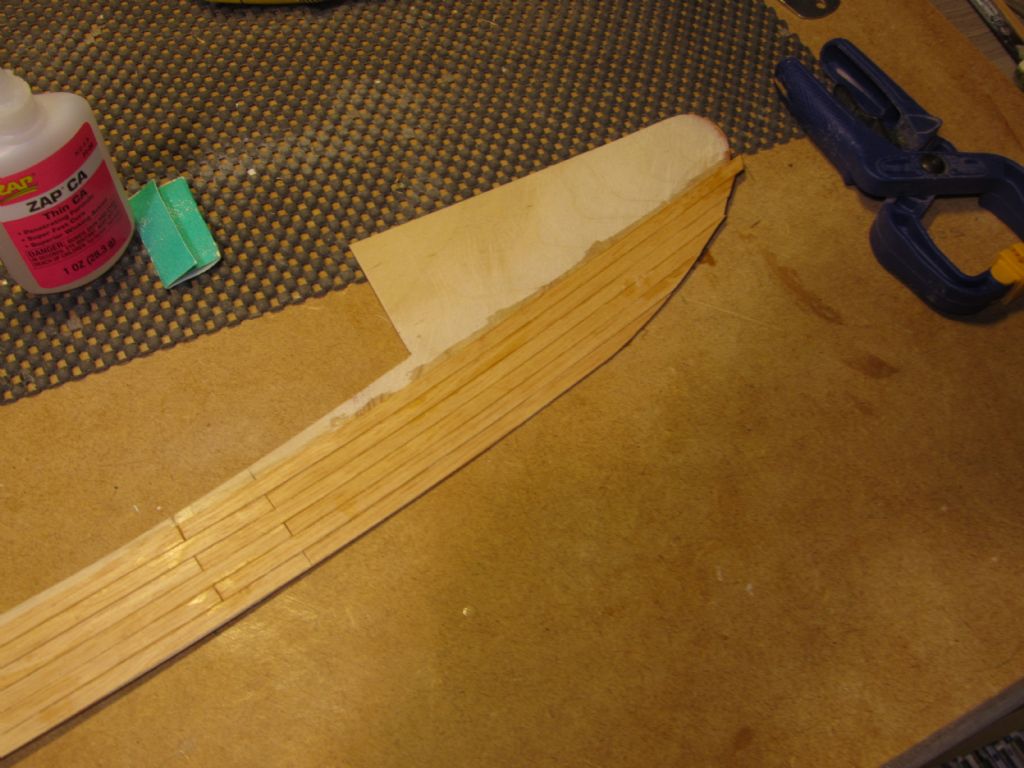

          It's been one of those two steps forward and one step back days today which most of us have from time to time. I started on the second plank and had difficulty getting it to lay flat where it curves towards the bow and not helped by a slight weakness in the plank due to a branch or similar. I got it flat but the plank started to splinter. Gave it a sand and it didn't look too bad so carried on. I made sure with the third plank that there weren't any defects at that point but still had trouble, not helped by the curve getting tighter as more planks were fitted.
          To be honest I wasn't completely happy anyway; in the previous photos you can see that the first plank isn't a nice smooth curve, so the decision was made to remove some of the planking. As you can imagine this was a bit of a pig to do having used CA but using a variety of sharp tools I got it done. No way was I going to remove the full length of the planks so I introduced joints just back from the front of the cabin, which I think looks better anyway, and cut some false joints with the Stanley knife further back to effectively cut the planks into thirds. Another hiccup was with one of the planks near the stern which had ridden up on the adjacent plank and the CA had grabbed before I noticed. So this was cut out and replaced.
          With the replacement planks at the bow I've straightened out the curve sooner so that they meet the edging sooner which makes fitting the planks easier. Not exactly like the real thing but still much better than straight planking. Was hoping to get both sides done today but with the problems that didn't happen. I shall start the second side before finishing the first incase I have to make any adjustments to get it symmetrical.
          planking1
          planking 2

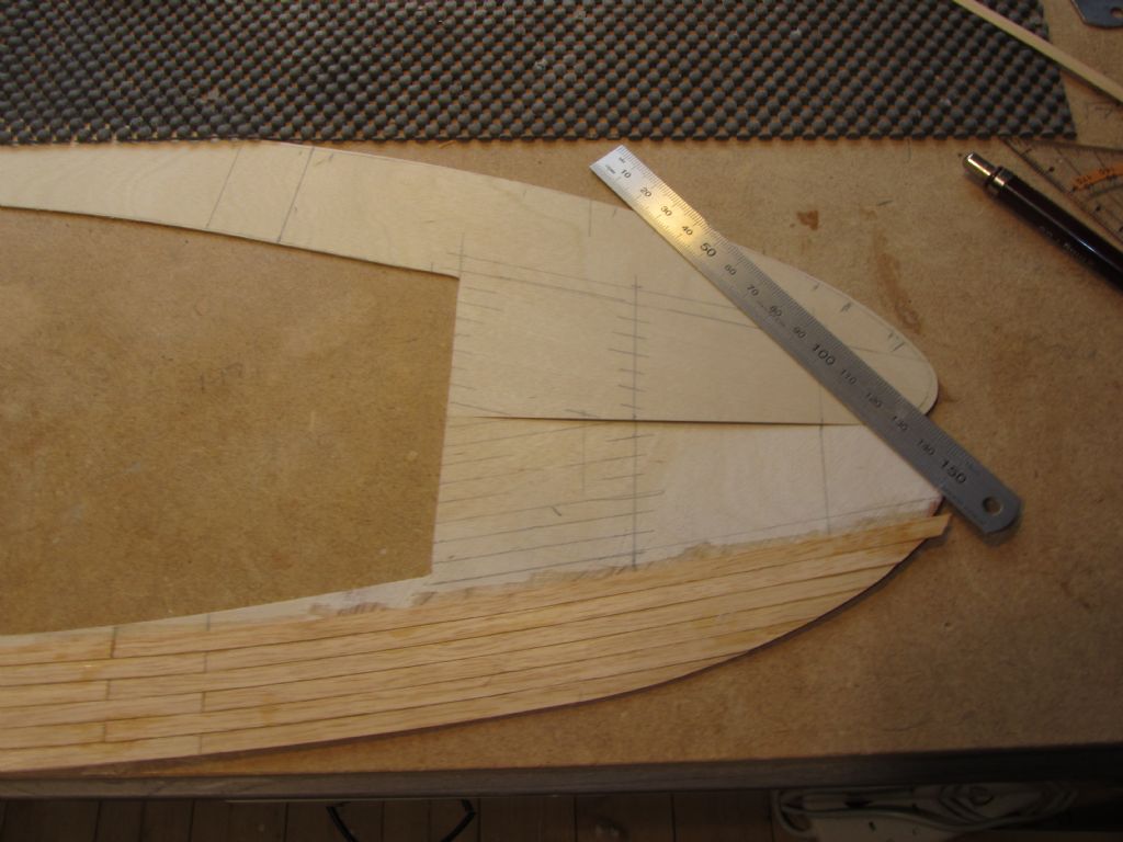

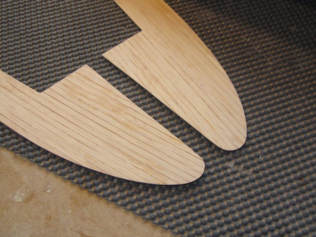

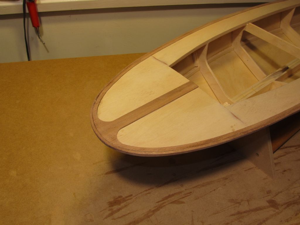

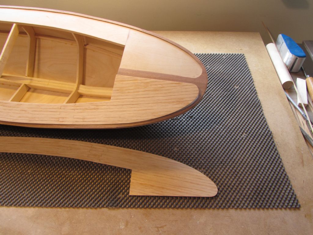

                Before starting on the second side it was prudent to do some marking out so that the planks on each would meet the king plank symmetrically. Having done this I planked the rear two thirds of the second side to where the joints are and then added the sixth plank which was the point I'd I'd got to on the first side, along the line marked out. This was a bit of a risk as I would be fitting planks both inside and outside this plank.
                I then fitted planks alternately to both sides, approaching the king plank, checking measurements as I went. The last thing you want is a marked difference in size of the last small triangular plank as the eye will be drawn to it. They ended up smaller than drawn out and less than a plank width but at least they are pretty much the same size. This part was definitely the hardest part!
                I then added the planks to the outside and thankfully the outermost plank fitted nicely to the outside edge of the ply sub-base. The oversailing planking was then sanded back to the edge of the sub-base and the top given a preliminary sanding. As said, not perfect, but will look nice once varnished and contrasted with the mahogany.

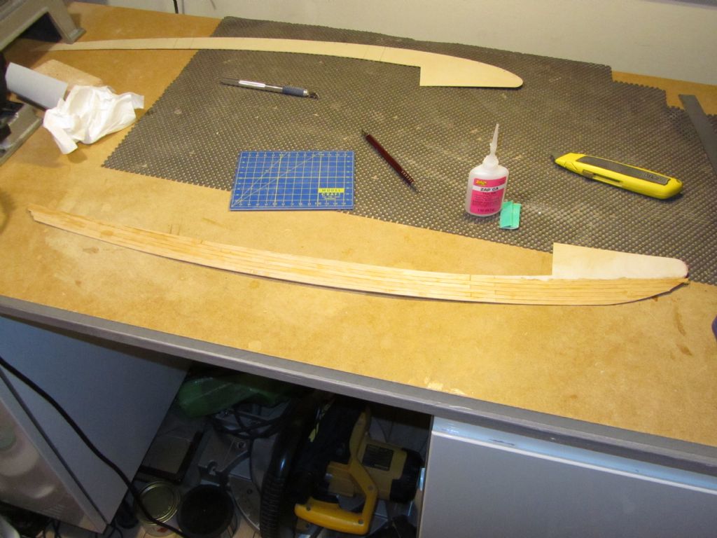

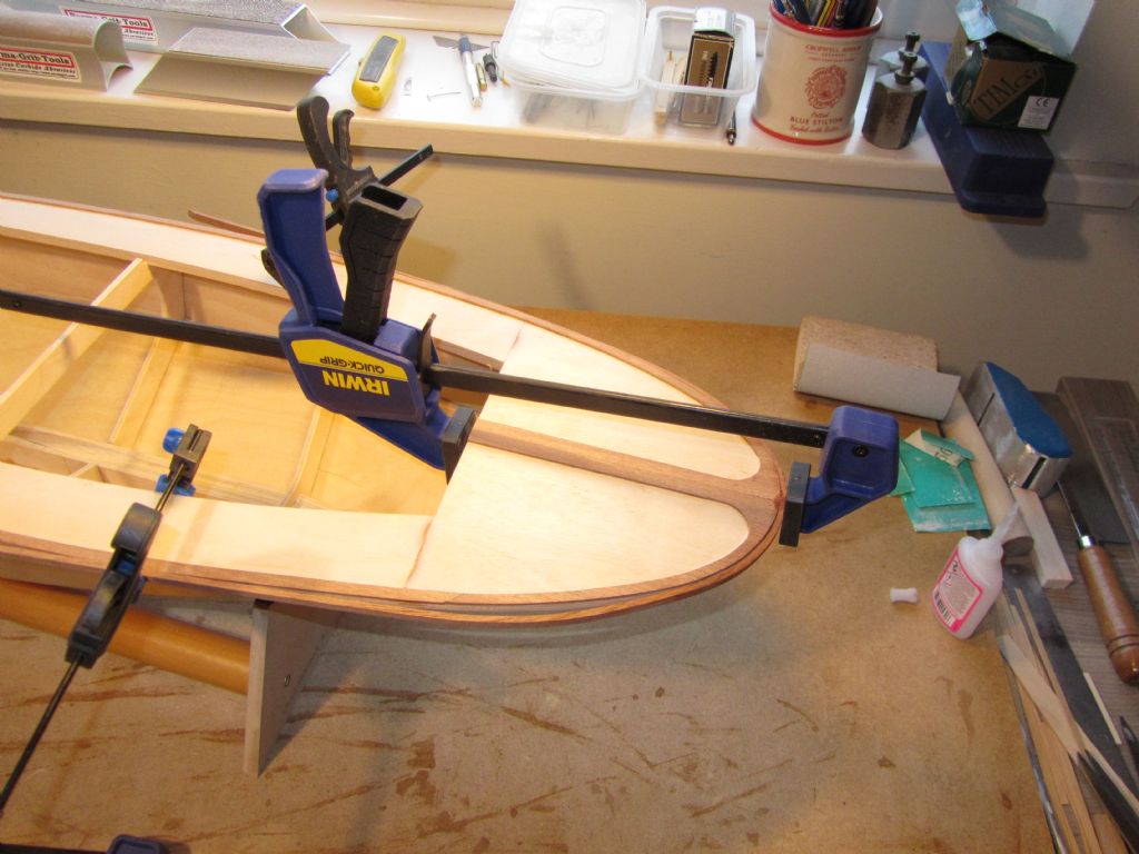

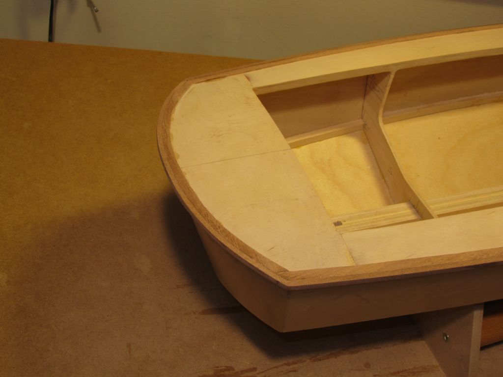

                  Next job was fitting the rubbing strips. Having joined those at the bow on the Swordsman I thought I'd make it easier for myself by having the curve of the bow in the middle of a strip rather than at the ends of two strips with a scarf joint to boot.
                  It was easier but I didn't get the strip as tight to the bow as I did with the Swordsman so am going to have to resort to a bit of filler. Just need some more sanding to remove glue marks and round off the edges and they will be ready for a coat of varnish before gluing down the planking.

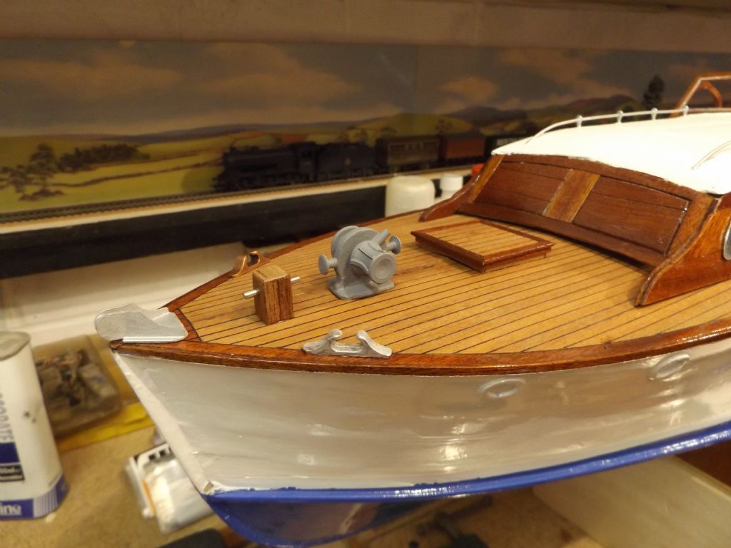

                    Work on the Huntsman has been going on in parallel with the Swordsman and the deck has been planked in the same manner and the upstand has been fitted around the inside of the deck area for locating the superstructure.

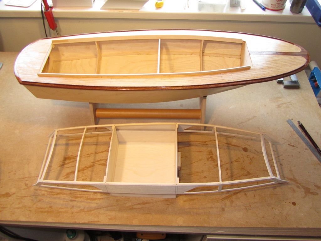

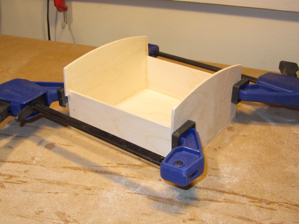

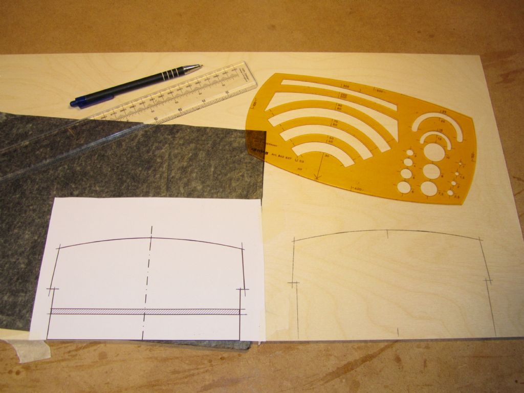

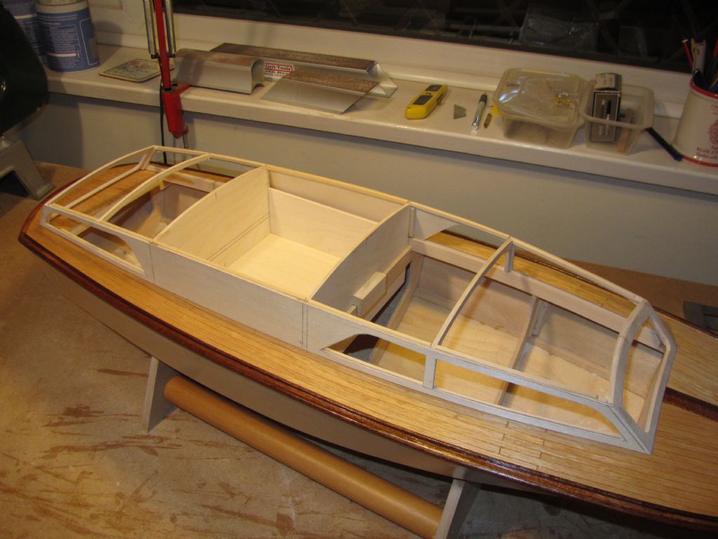

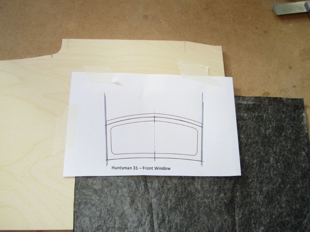

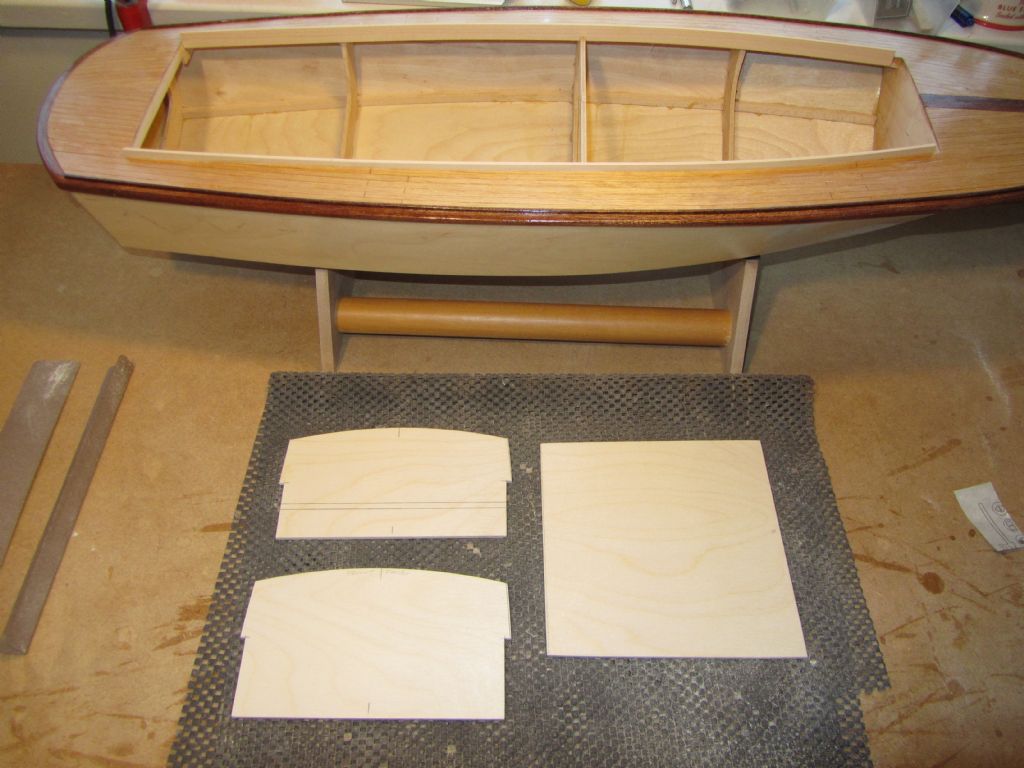

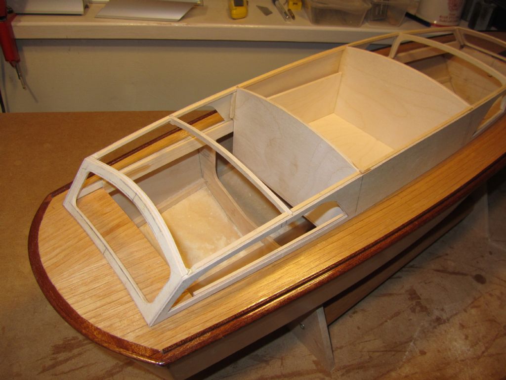

                      Next job then was to build the cockpit box. Drawings were produced for the rear of the front cabin and front of the rear cabin and for the base and then cut out of 3mm birch ply and glued together with a/resin. Measurements were then taken for the sides of the box, drawn directly onto the ply, cut out and glued in place.
                      Usually the cabin formers are restrained by and sit on the bulkheads, but as this was originally going to be a full cockpit version, the rear bulkhead had been repositioned and didn’t have a top to it. I did think of fitting a part bulkhead to do the job in the conversion to aft cabin but decided not too – more on this later.
                      superstructure2
                      superstructure3
                      superstructure4

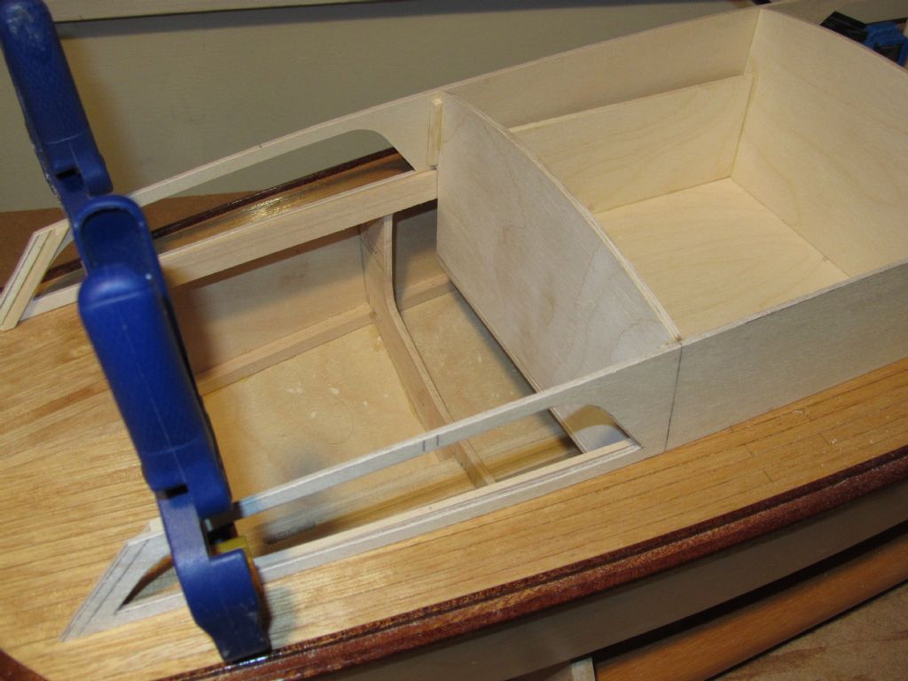

                      #93361

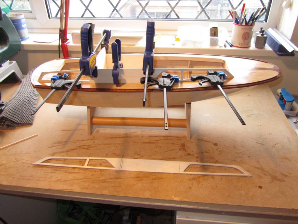

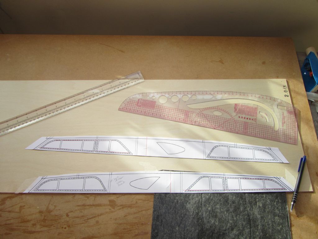

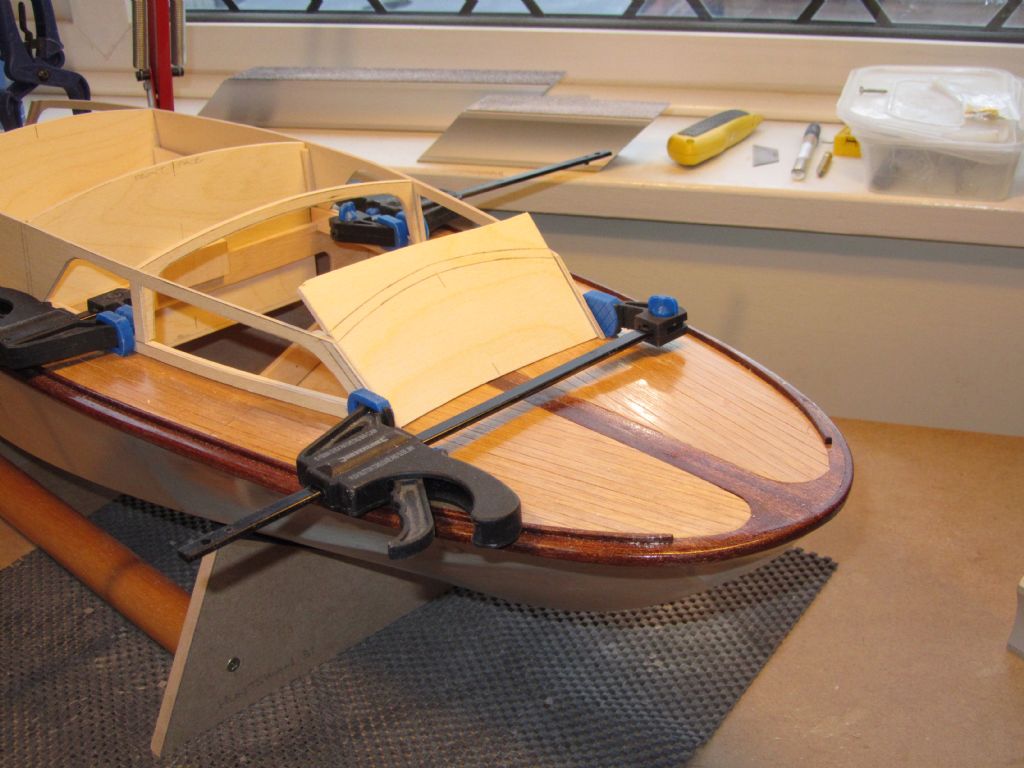

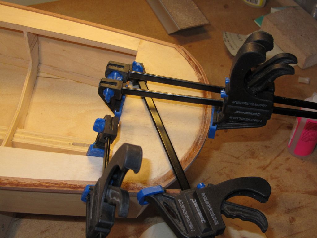

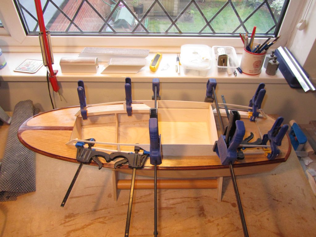

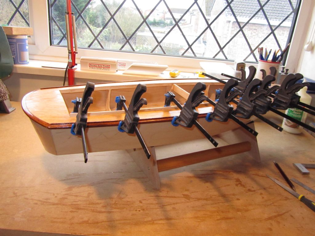

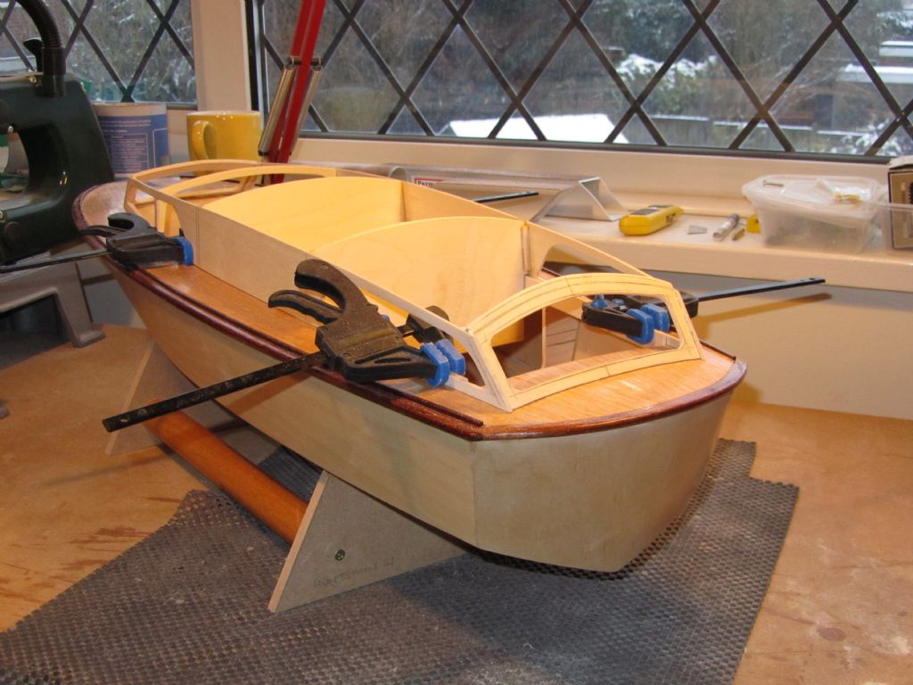

                        Then the cabin/cockpit sides, having been drawn up, were printed out and test fitted. Some slight adjustments were made to ensure that the front and back were in the right position and the bulkheads were aligned and then they were printed out again, transferred to 2mm birch ply and cut out with the scroll saw.
                        With the box in position, the sides were then clamped in place. On previous builds I’ve applied glue before doing this but as they were accurately positioned and not wanting to disturb them I glued the box and sides together using 2 x 2mm bass fillets and once the a/resin had gone off ran some thin CA between the ply joints.
                        superstructure6
                        superstructure8
                        superstructure9

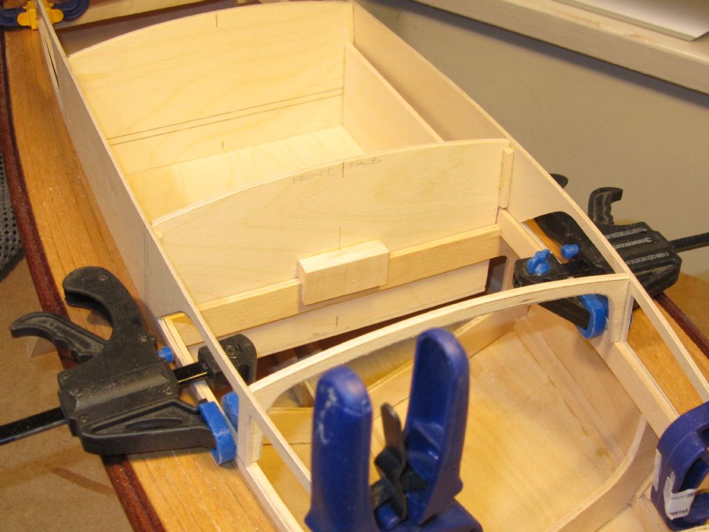

                          The photo shows the lack of bulkhead to the rear of the cockpit and I decided that as the superstructure sits on the deck, support from the bulkhead is not really required but restraint is and so the easiest thing to do is just to provide a hook at the front of the cockpit over the bulkhead there. Whist making and fitting this I also made and fitted the roof support with extended legs to give the right angle for the cabin sides.
                          superstructure11
                          superstructure12

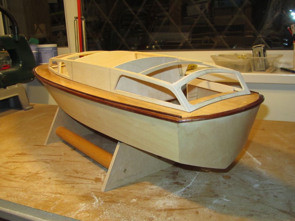

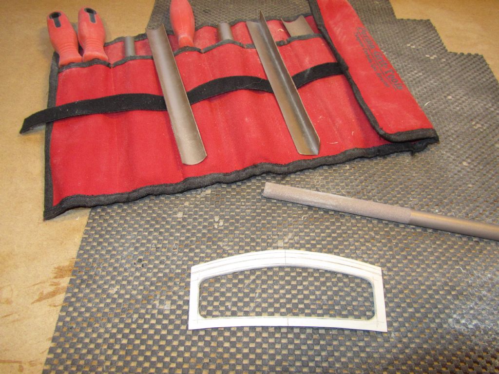

                            Then on with fitting the front window. First 2 x 2mm bass fillets were glued in place to locate the window and give increased gluing area. Part of the window drawing (the bottom and sides) was then transferred to birch ply and cut out. The bottom was then sanded to give a good fit to the deck camber and then sanded back at an angle to allow the window to angle backwards. The sides were then gradually sanded towards the line to ensure a snug fit. Now the position of the top of cabin sides can be marked on the blank along with the window opening. Rather than use the drawing for the opening I decided to draw the opening straight on in pencil, so far so good. But as I was cutting it out on the scroll saw and approaching the third corner I realised I had forgotten to draw the rounded corners, bugger! Quite a lot of time was taken to get to this stage and the window fitted really well so I was a bit gutted at having to remake it. But taking stock I saw that there was only one saw cut into each corner and enough timber left to just about get away with it, phew! The window frame will cover it anyway. The window was then glued with a/resin and clamped.
                            superstructure13
                            superstructure14
                            superstructure15

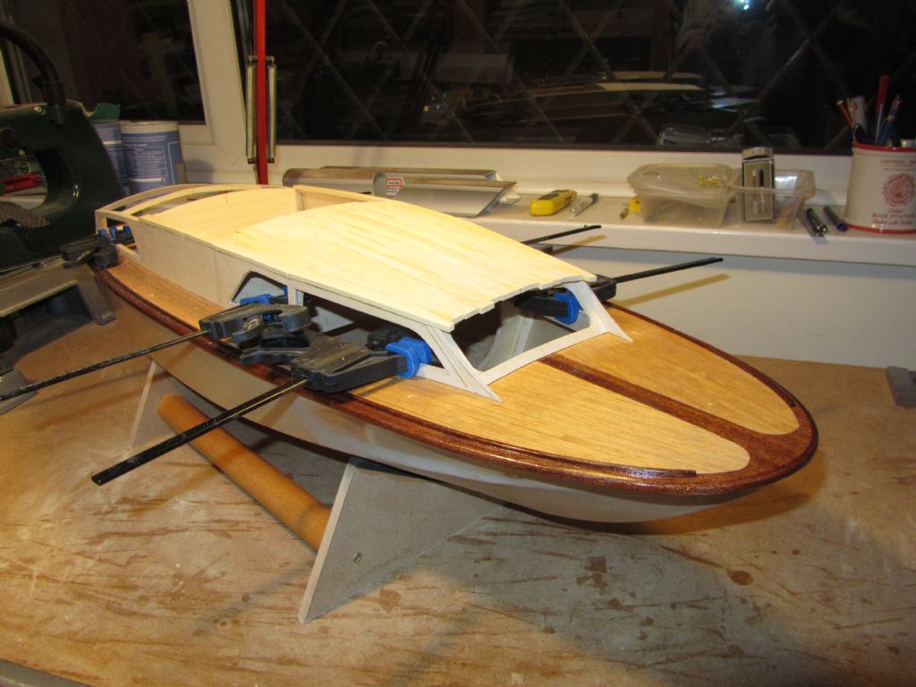

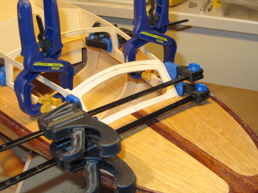

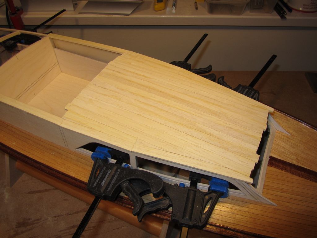

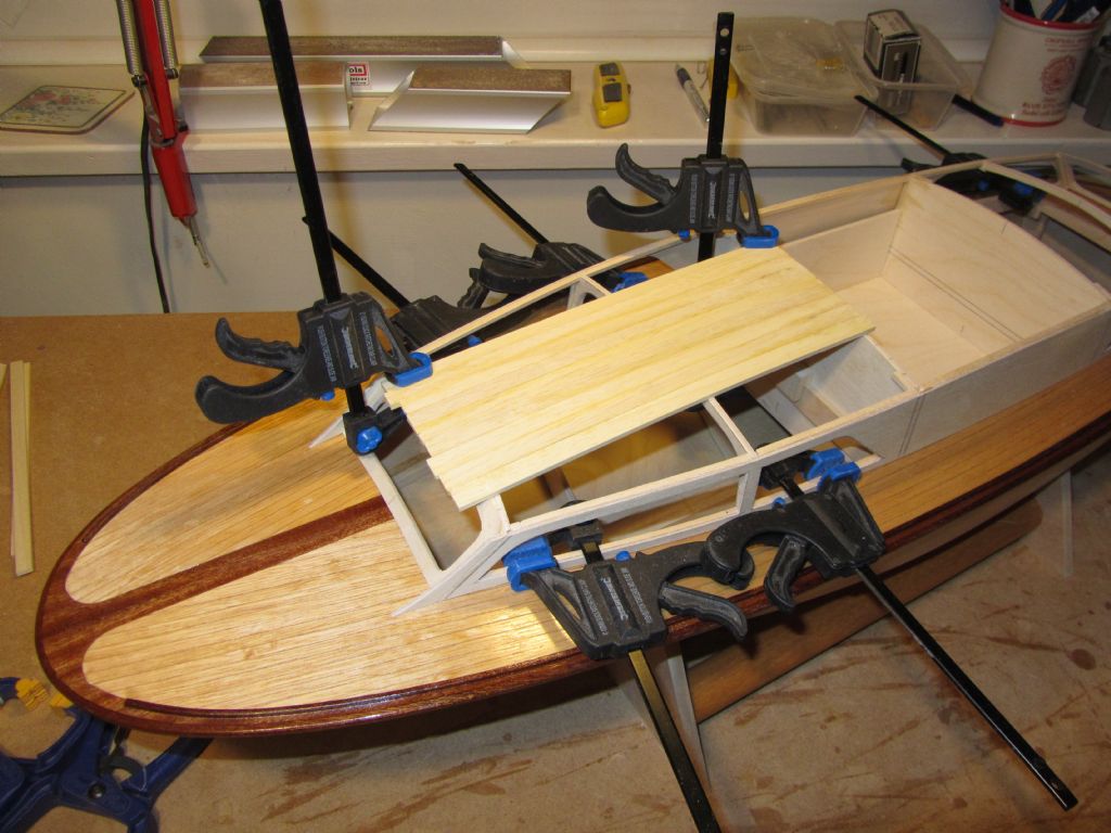

                                            Roof planking coming on. As per other builds using 3 x 9mm obechi planks glued down with Slo Zap slow cure CA underneath each end and a/resin along the sides.
                                            There is a slight curve fore to aft so clamping or weighing down at ends and leaving for awhile until the CA sets. As I said I enjoy this part, just cut a plank to length, glue in place, leave for awhile, and then on with the next, very relaxing!
                                            Bit more work at the sides as the planks have to be cut to shape to fit – on with that tomorrow.
                                            Note the securely clamped down superstructure. Clamps will not be removed until all the planking is glued in place and then left overnight!
                                            superstructure23
                                            Edited By Chris Fellows on 28/01/2021 19:12:57

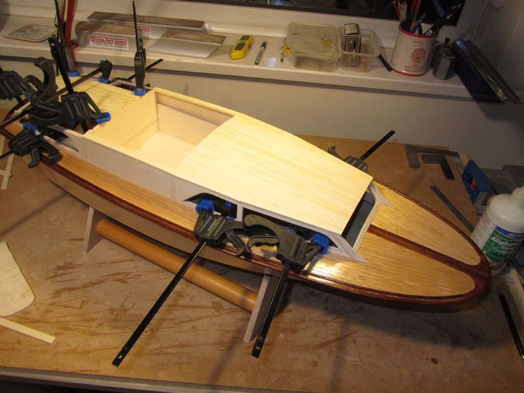

                                              Finished planking the for'ard cabin roof today and along the top of the cockpit sides. Aft cockpit tomorrow.
                                              superstructure24
                                              superstructure25
