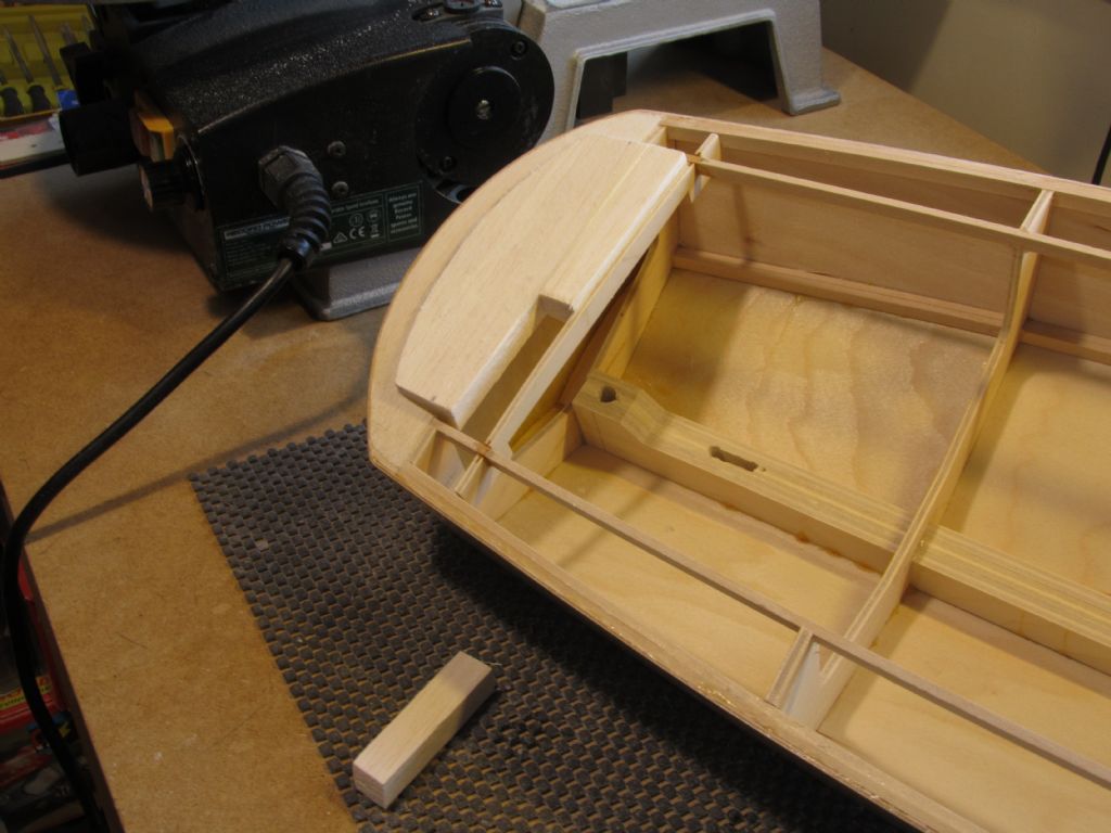

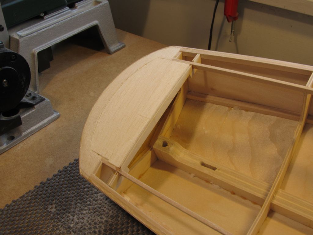

                  #91719
                    Where does the time go! smiley

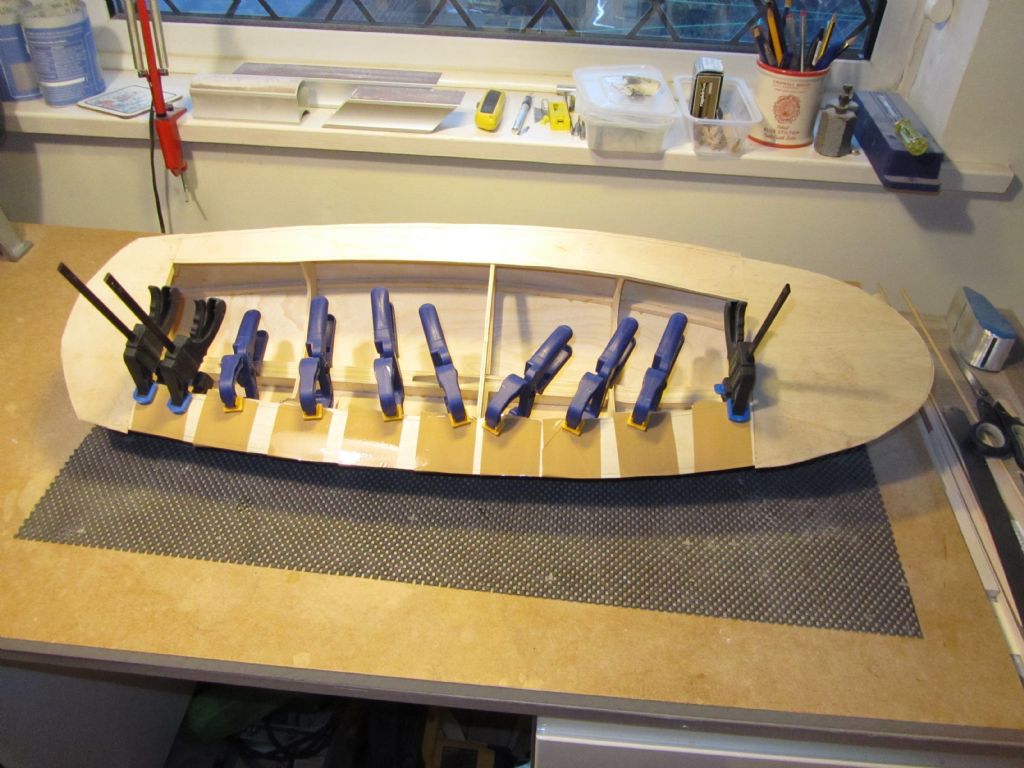

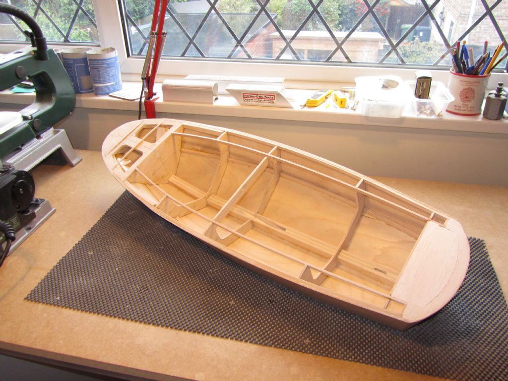

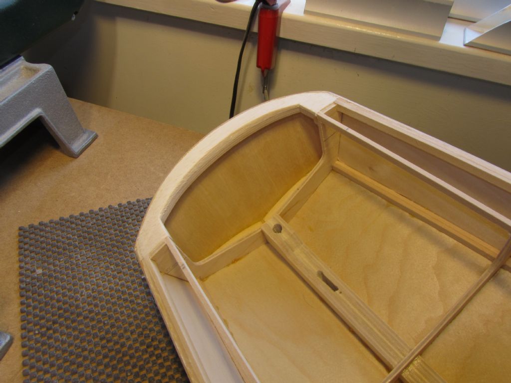

                    Prompted by a comment that Ray made some time ago about me building similar boats I was considering changing the build from the Sport (full open cockpit) to the aft cabin version. Whilst I really like the look of the Sport I already have/am building three full cockpit boats (2 x Huntress and 1 x Huntsman 28) and my big 47" Huntsman 31 has a new owner and so I have made the decision to go with the aft cabin design.
                    To that end I've increased the size of the deck by the transom by adding in a ply former and infilling with that valuable commodity – balsa! Followed by sanding to the curve of the deck. The only other modification required is to add another former for the front of the rear cabin to sit on.
                    The 0.5 x 5mm Tanganyka timber strip arrived today for planking the deck. Need to add some additional formers to the deck to provide the camber and then glue the ply sub-deck in place and then planking can begin. I've bought enough strip for the Swordsman and Huntress as well.

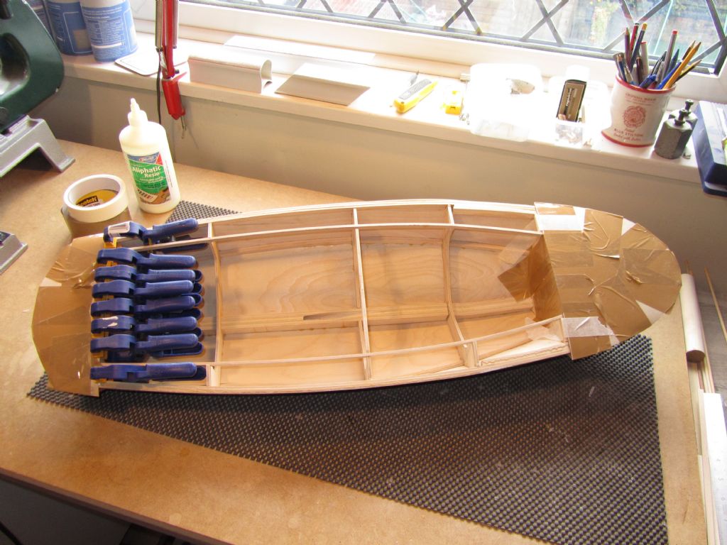

                    #91854

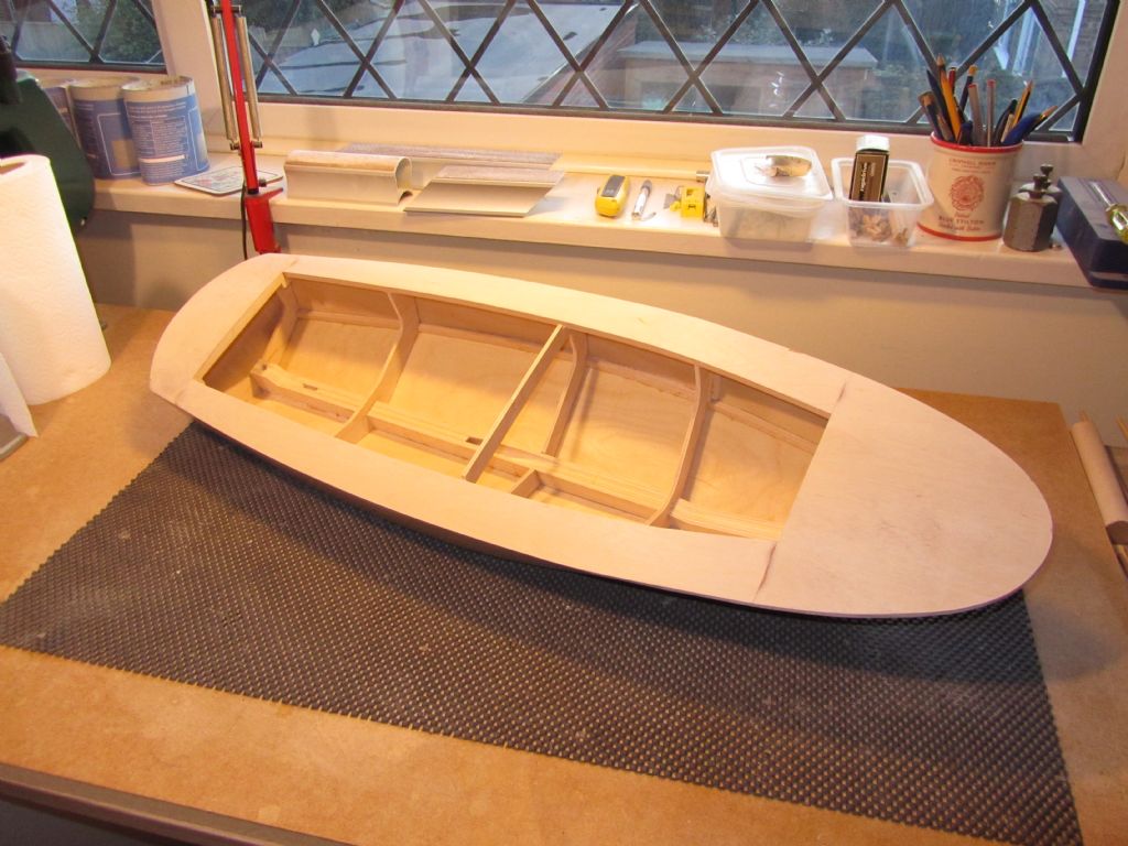

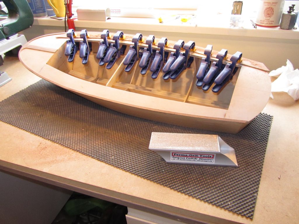

                      Sanded the top of the forwardmost former (top of bulkhead No. 1) so that the sub-deck would sit properly and then added in another former between it and bulkhead No. 2 and sanded to profile.
                      4 No. pieces of 0.8mm birch ply (bow, by transom and 2 sides) were then cut to shape, slightly oversize, using card templates and then glued in place with a/resin and held with clamps and parcel tape. Left to thoroughly dry and then sanded around deck and internally where the coaming will be fitted.

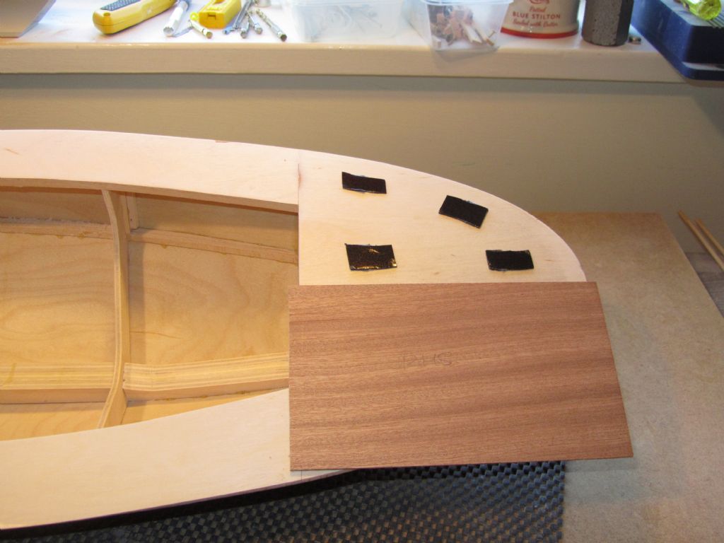

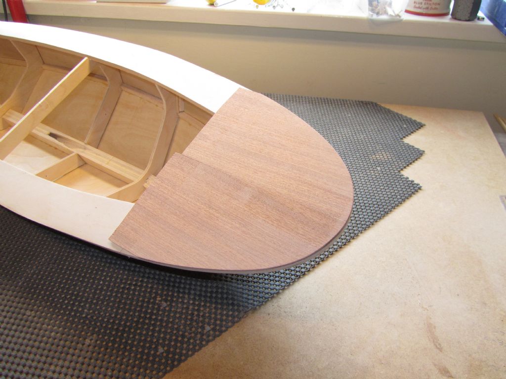

                        1.5 x 100mm mahogany sheet is being used to produce the bow detail and deck edgings within which the planking will sit.
                        Started by sticking 2 pieces to the bow with small pieces of double sided tape, roughly trimmed to shape and then sanded back to the edge of the deck with PermaGrit block and then 240 grit on a sanding block. The pieces were then carefully removed using a thin scraper to cut through the tape.
                        The shape of the bow detail was then drawn onto each piece of mahogany and carefully cut out with the scroll saw and then sanded back to the lines. The pieces were then glued in place with Slo Zap to give some time for positioning.

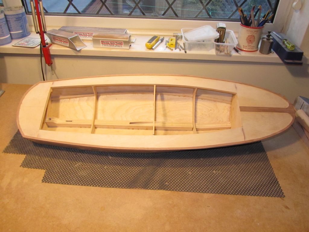

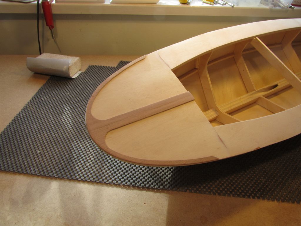

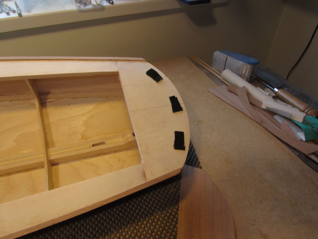

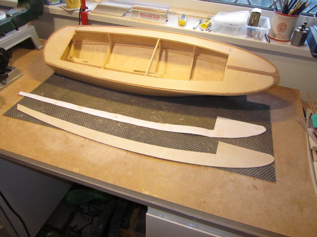

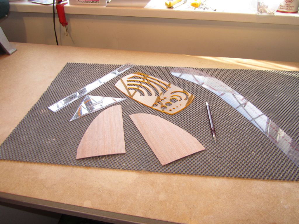

                              Edge pieces were produced by first cutting out a slightly oversize card template and then transferring to the timber and cutting out with the scroll saw. After clamping, the edge was sanded back to the edge of the deck.
                              Removed from deck and a width of 5mm was marked with pencil dots to form the inside edge, dots were then joined up using a large plastic curve and then carefully cut out with the scroll saw and carefully sanded with a concave PermaGrit block. Note the word carefully keep being used! Finally the pieces were glued to the deck.
                              Photo shows one edge glued in place and the other being sanded to the deck edge.
                              Transom piece to be done tomorrow to complete the bow detail and deck edging. The Swordsman has been done at the same time whilst I'm in the swing.

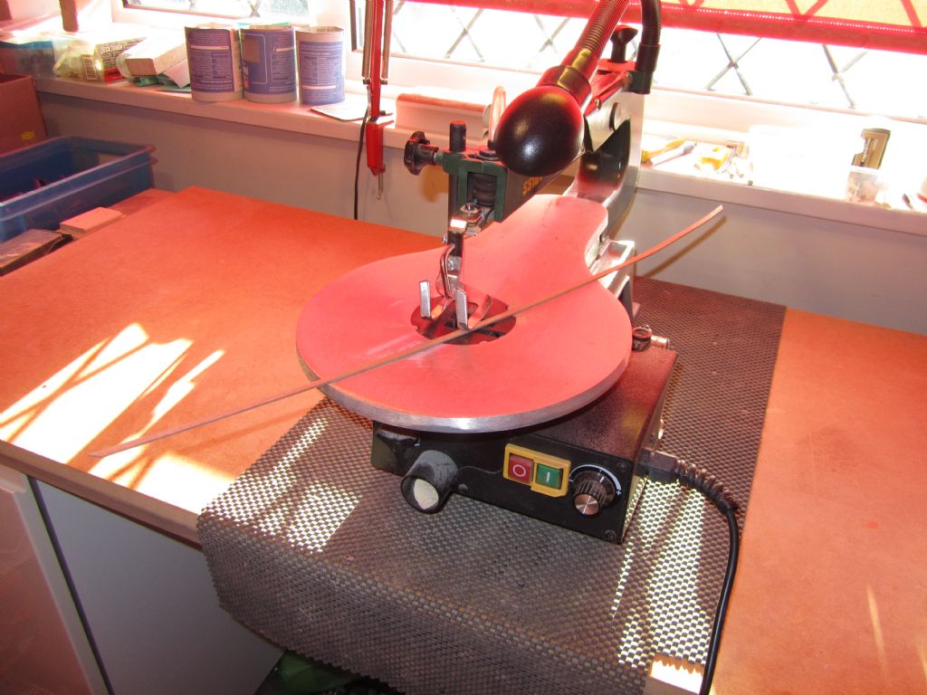

                                That scroll saw is just the job ! I'm just thinking about replacing my ancient Burgess band saw at the moment, as Aldi are selling a Ferrex machine for £147, maybe the similar Axminster offering not sure yet 😉
                                #91900
                                  Ray
                                  There's a marked difference between a scroll saw and a band saw, but I'm sure you know that.
                                  #91904
                                    Just had a look Dave and the Ferex Ray is reffering to at £149 is another band saw but is showing as sold out.
                                    It was either a scroll or band saw for me and decided on the former. Was thinking about a band saw at some point for planks etc. but may not bother now for the use it will get. The scroll saw has been brilliant and has had quite a bit of use and for less than £120 was good value.
                                    Still fancy a pillar drill though, but don't have the space at the moment.
                                    Edited By Chris Fellows on 17/10/2020 11:36:59
                                    #91905
                                      Yes a few years ago I was given a scroll saw, but the table was about 18" diameter & bloomin heavy so it had to go ! !
                                      I understood that they vibrate up and down ? I prefer the bandsaw for most of my stuff , lots more teeth 😀
                                      #91907
                                        It's a question of cutting straight lines vs sharp curves. The bandsaw excels at the former while the scroll saw is vital for the latter. I decided long ago that to have both types was the best option and so it's proved. Mind you, mine were both second-hand when I bought them and just needed a good clean down, oiling and new blades. The Rexon 3-wheel 10" bandsaw is 25 years old and has a pressed steel case and machined bed with large threaded securing knobs, whereas the newer 'Power' it replaced was largely plastic.
                                        Incidentally you can buy blades with different numbers of teeth from any reputable woodworking machine supplier. ALDI and LIDL might make good offers initilally but you'll not get the spares and service backup like you would from, say, Axminster.
                                        #91912
                                          Got on with the piece of edging at the transom this morning. Same process as for the bow; held the mahogany sheet in place by hand and drew around the transom, cut slightly oversize and held in place temporarily with double sided tape, sanded to the transom edge and then removed. Ends were cut and sanded to fit between the side pieces and then glued in place.
                                          Ready to have a bash at the planking now.

                                            As for the Swordsman I've had to cut out and fit the sub-base from 0.8mm birch ply. Again a paper template was produced first then drawn around oversize on the ply. This was then cut out with the Stanley knife and sanded back to fit inside the mahogany king plank and edgings and flush to where the internal coaming will sit.

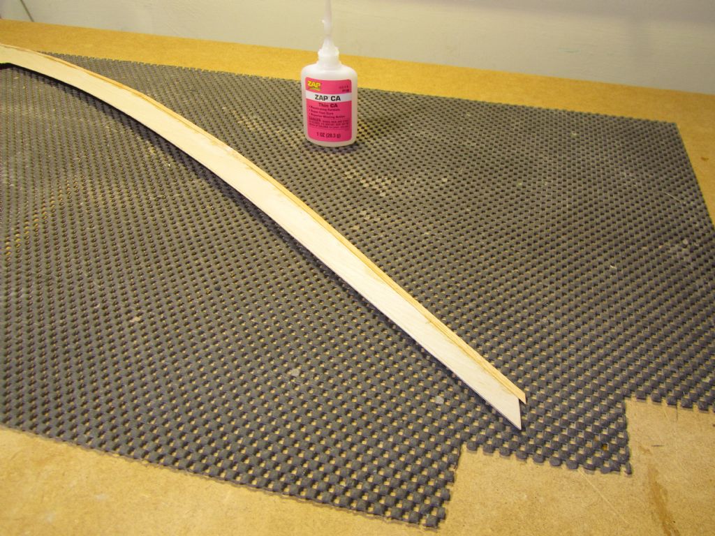

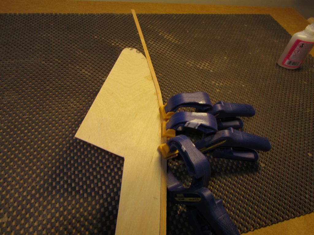

                                                    Just started the planking and got the first one fitted. Even using 0.5mm thick planks they obviously bend upwards going round a curve particularly at the bow where they are tightest.
                                                    So decided to use thin CA in the end rather than Titebond so that I could do a short section at a time and not have to wait for it to dry. Fiddly process but the subsequent planks should be easier to do.
                                                    Not perfect by any means but once sanded and varnished it should be look Ok. Timber is Tananyka which looks like teak when varnished.
