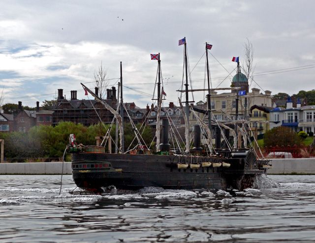

      Declan has sent in an old picture of Great Eastern anchored off Telegraph Field
      Ha! Ha!…..That had me fooled at first!
      It`s actually another example of digital dodgin`!
      Nice one Dec!

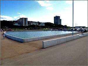

          The boating lake decision has been made……….New Brighton!
          Rather small, but with access all round and in a lovely seaside setting.
          Rockferry is about six miles away, where GE was broken up and I learned today that plating from GE still lies in the mud!
          This is the pond, brand new, built by the Council last year to replace the old one and is part of a multi million building programme!
          The sailing plan is to have a small dummy run next week, followed by a further serious dummy run with the BBC team, early August….followed by the official filming on August 22/23

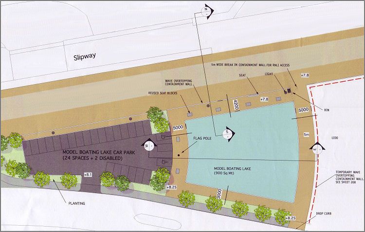

                Here is the new New Brighton pond layout, which may be of interest to our readers?
                Just the job!………Bob

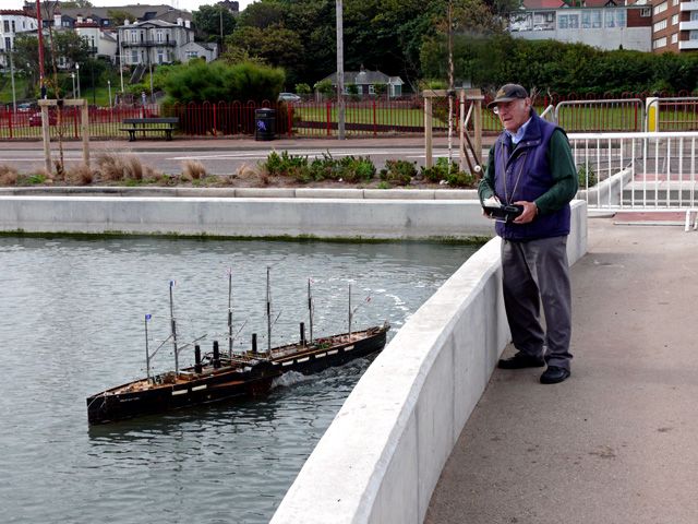

                                Capt Bob here reporting on today`s adventure into the unknown at New Brighton!
                                For this report, the pictures and stories will be fragmented slightly to make progess, rather than loading dozens of pix and blurb…. only to find that they`ve disappeared somewhere along the line, as a timeout sometimes comes into operation!
                                We got there quite early (9.00am) only to find the pond was in operation already!….. those NB boys are keen!
                                Got together an impromptu team in no time!….Don Morris (Chair), Jack Turner (Comm)… a NB member….and Geoff Abell…… .Not forgetting Capt Bobrunel at the controls
                                I know I`m making a song and dance about the trip, but it was such a light hearted affair, great fun and nice to meet the ever helpful NB boys

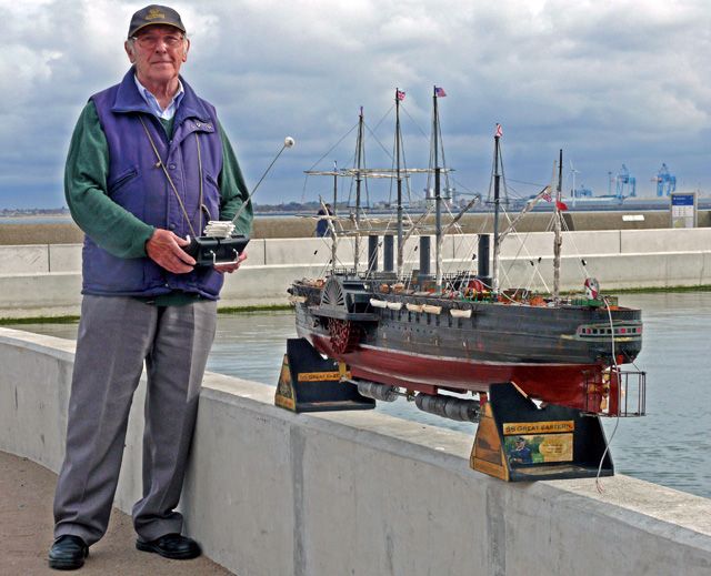

                                Capt Bob, Great Eastern and the Mersey estuary, ready to sail. Had a stiffish seaward wind at times and the lake looked quite daunting. with a long voyage ahead!

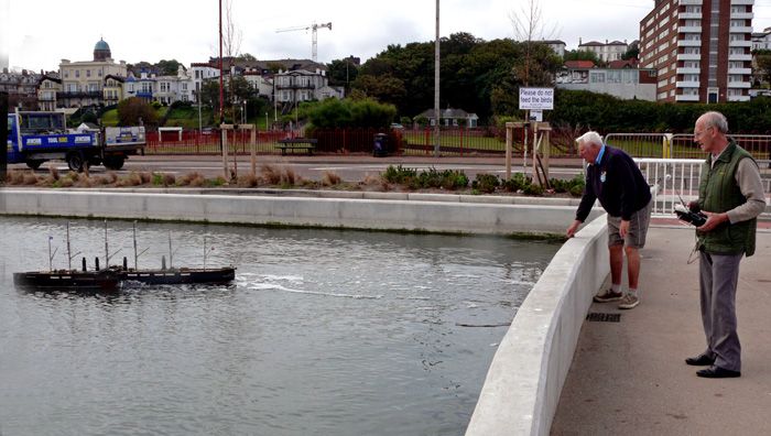

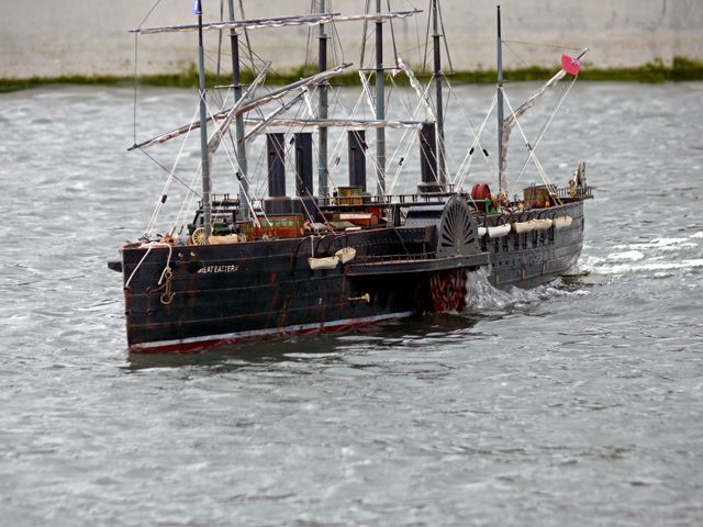

                                  GE steaming out of Valentia cove, Telegraph Field, County Kerry, Southern Ireland…. 1866…`ish!

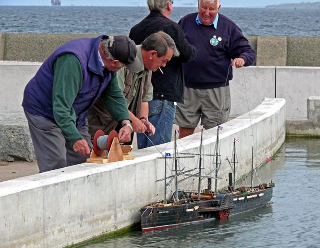

                                  Away the lads!
                                  Jack is anchor man for the cable, Geoff at the helm. It was surprising and a bit worrying, how the motors laboured, driving forward and unwinding the cable drum …….Into wind!
                                  Going forward. The wind blew GE to starboard and she would not answer to the helm!
                                  Why was that, Capt?……… Because the cable was often taught and prevented the stern from steering.
                                  What`s the answer?…….. Obvious! Stop the engines and allow the cable to sink!
                                  Aye! Aye! Capt!
                                  She`s coming about now Capt!

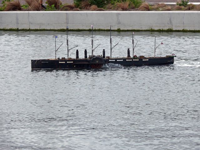

                                    Excellent Bob, and that waterline shot is fabulous!

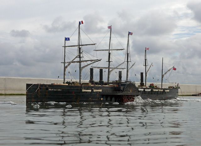

                                      Great Eastern steaming proudly into “Hearts Content”….. Newfoundland….1866
                                      (What a crackin` picture?)

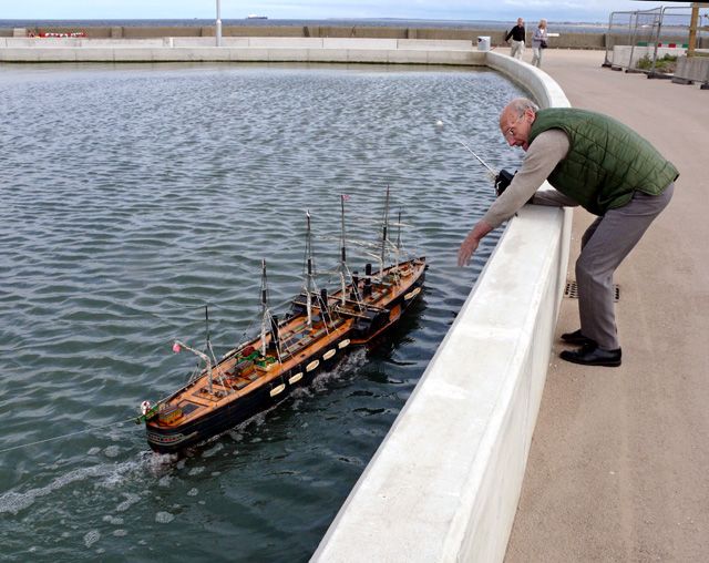

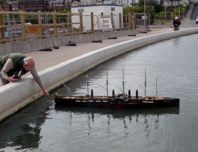

                                      First mate Geoff retrieving GE, coming in after the epic voyage!
                                      The bubble trail was nice to see.

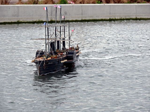

                                        We made the return trip out of the wind, with Jack holding all the cable, where GE towed the cable instead of unwinding it off the drum.
                                        Aye!….That`s the clue!….When GE sailed the Atlantic, the cable was unwound mechanically and allowed to sink to the sea bottom. But in our case, we are using the boat`s motors to unwind the drum…….That`s why the cable is forever taught!……..So the underwater gadget, to hide the cable would have caused too much resistance!….and could have even snapped the cable

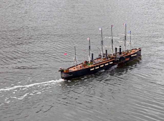

                                        Homeward bound in the slack waters, away from the wind
                                        Sailing nicely, with no cable tension

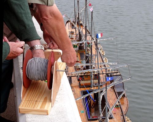

                                        What a palaver! Four men to rewind the cable!
                                        Why was that, Capt?
                                        Because Jack had coiled the wire on his arm and created a multi twist in the cable!
                                        Next time, we`ll rewind the cable from the wire end, end!….Another little lesson to be learnt
                                        Here we are…rewinding and unwinding the twist!
                                        Not much of a problem, but the twist slowed the process, but was great fun with all hands on deck!

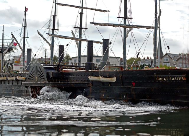

                                                    Just another nice picture of the Great Eastern….
                                                    And a shot of the busy stern end, showing the cable and foam…..The visual rotation feature, the red and white wheel,  worked well and should look nice on the video?
                                                    Edited By Bob Abell on 29/07/2011 17:34:30
