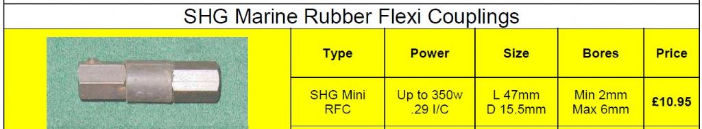

              Re the coupling, I doubt your shop will have the one Dave mentioned, so give the company (shg) a ring, they are excellent.

              #76409
                This is the coupling I now prefer. The two hexagonal parts are hardened steel and the rubber is very hard – you can almost use the thing as its own shaft aligning tool! The latest catalogue on-line is the 2013 edition and the price has increased. Yes – it's expensive but the best usually is. SHG attend most of the shows so you could save the P&P of £3.50 which IMHO seems OTT for a 12p Jiffybag and a Large Letter stamp.
                Edited By Dave Milbourn on 21/03/2018 08:31:34
