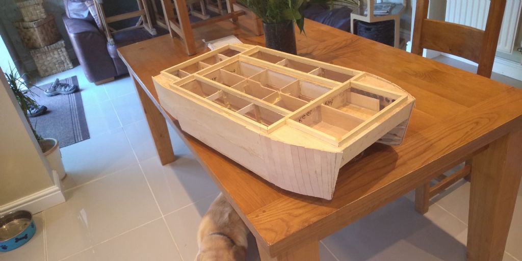

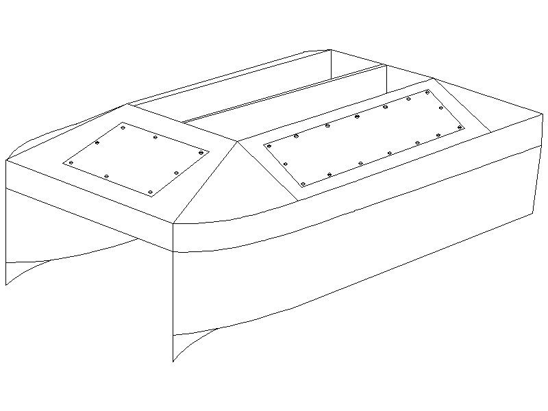

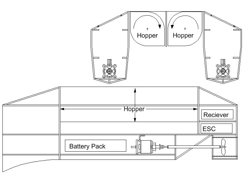

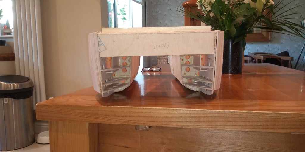

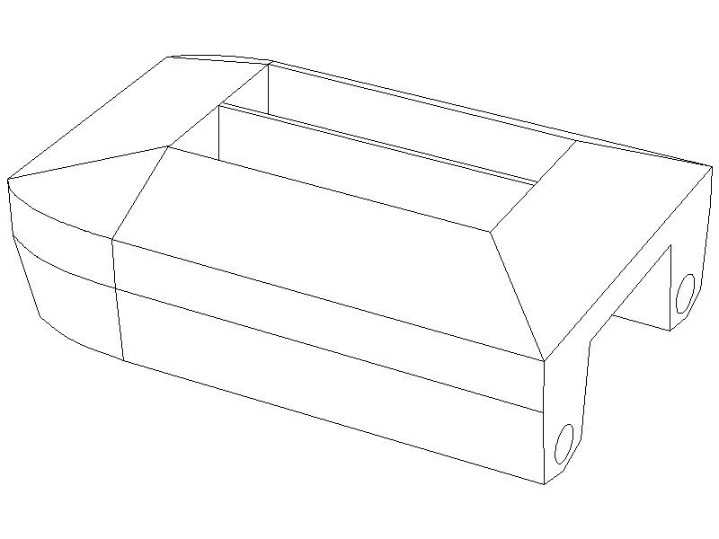

                                Neil
                                I designed a similar bait boat some time ago for a chap who wanted drop 10kg at a time.
                                I opted for 2 brushless motors each with its own battery.

                                  10kg at a time, he must have been loaded. What was the overall weight of the boat and what motors did you opt for?

                                          #90214
                                            Neil
                                            The designed all up weight was 14.5kg, the chap was a carp fisherman who wanted to dump 10kg at a time in precisely the same location.
                                            The bait boat was designed to carry this weight and was intended to use drone gps technology to consistently drop the load in exactly the same place.
                                            I found that the brushless motors were to noisy so on Dave Ms advice the spec for the motors was changed to a pair of 775s with 4 blade props.
