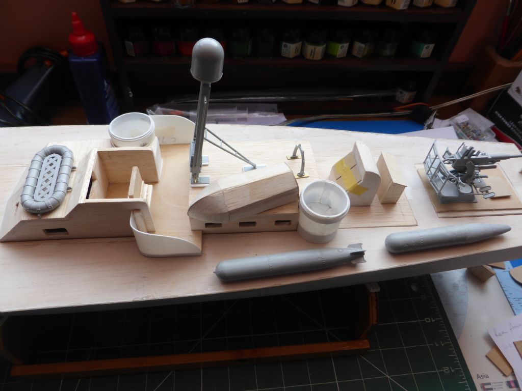

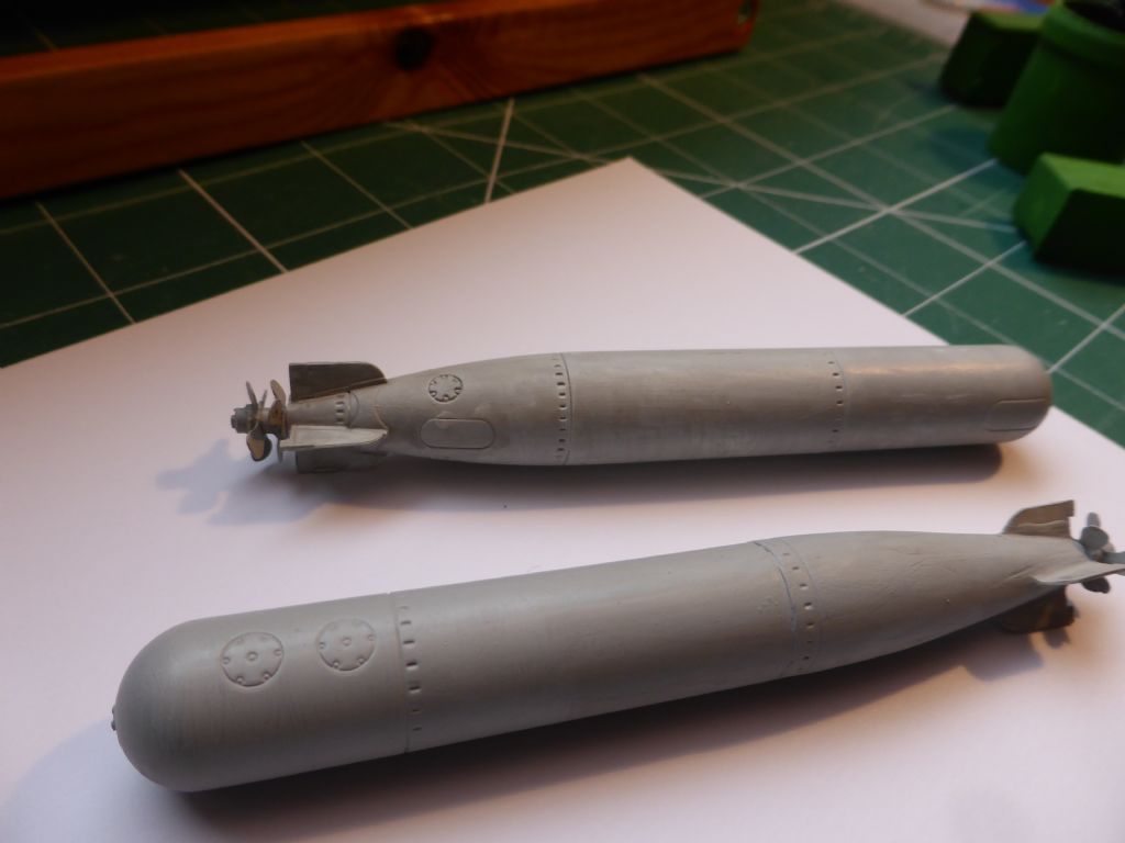

        A few more pictures of the present progress. For a change I have made up the guns from the conversion kit and altered a torpedo, so I have 2 about the same size. The mast should fold if I can get it right. Just thinking about having a try at making the twin guns for the tubs next.

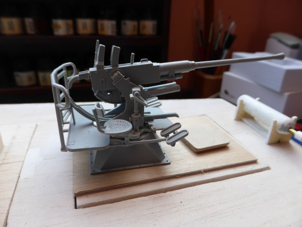

          Is that seat on the Bofors facing the right way? Looks back-to-front to me…

                Whoops! At least I got them both wrong! That's a job for tomorrow!

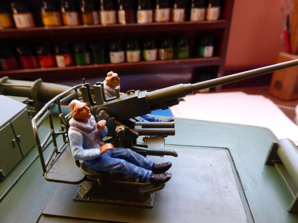

                      Seats on Bofors now the correct way. Just started making props for the torpedoes as the ones in the conversion kit I found impossible to use. Must decide then whether to make 2 more torpedoes or use the depth charges that came with the kit.

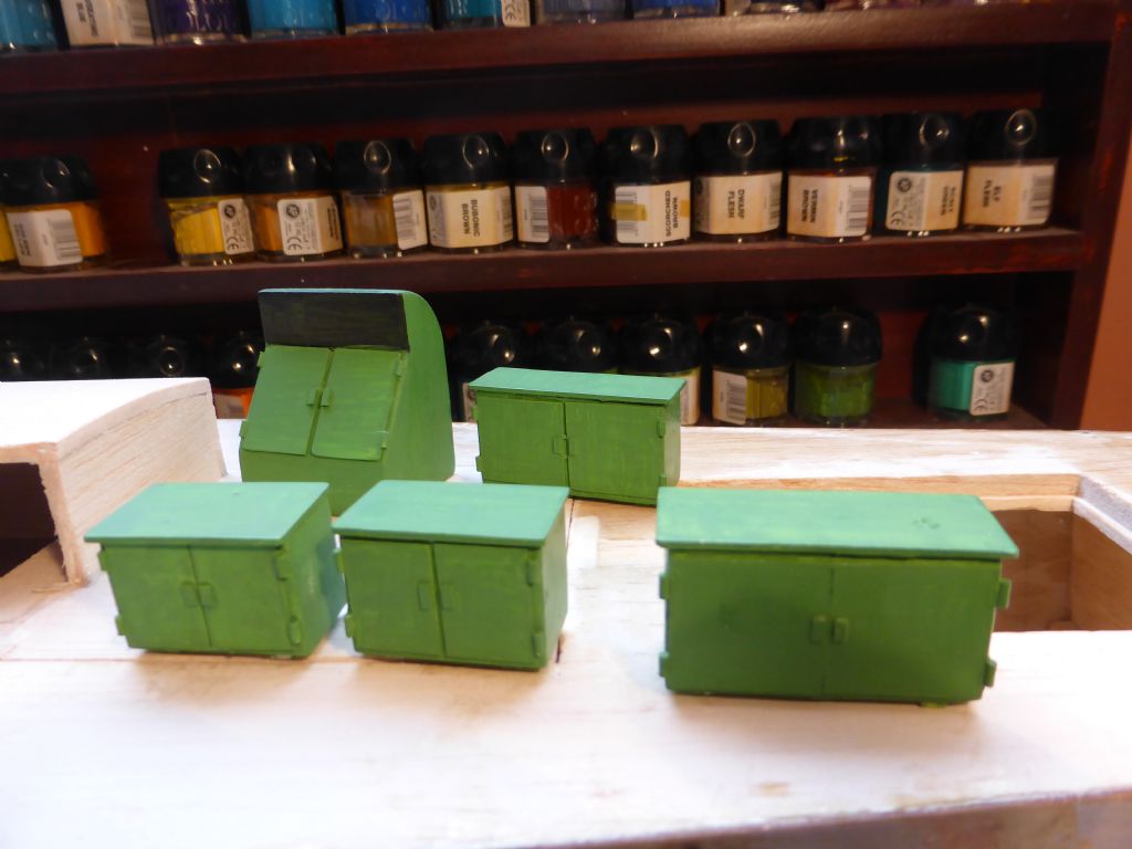

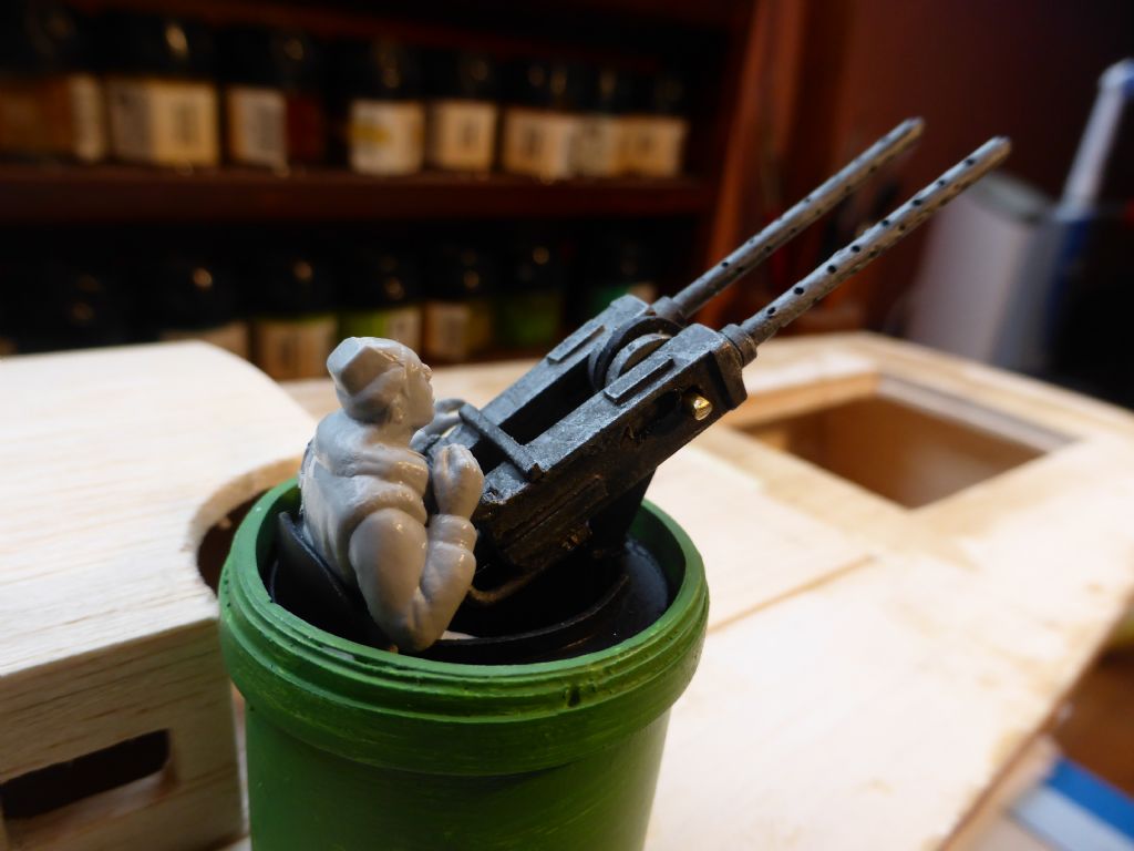

                        A little more progress. Had a go at the twin machine guns, some lockers and 2 torpedoes. The hull has been partly sealed, the deck and the inside still to seal.
                        Tim

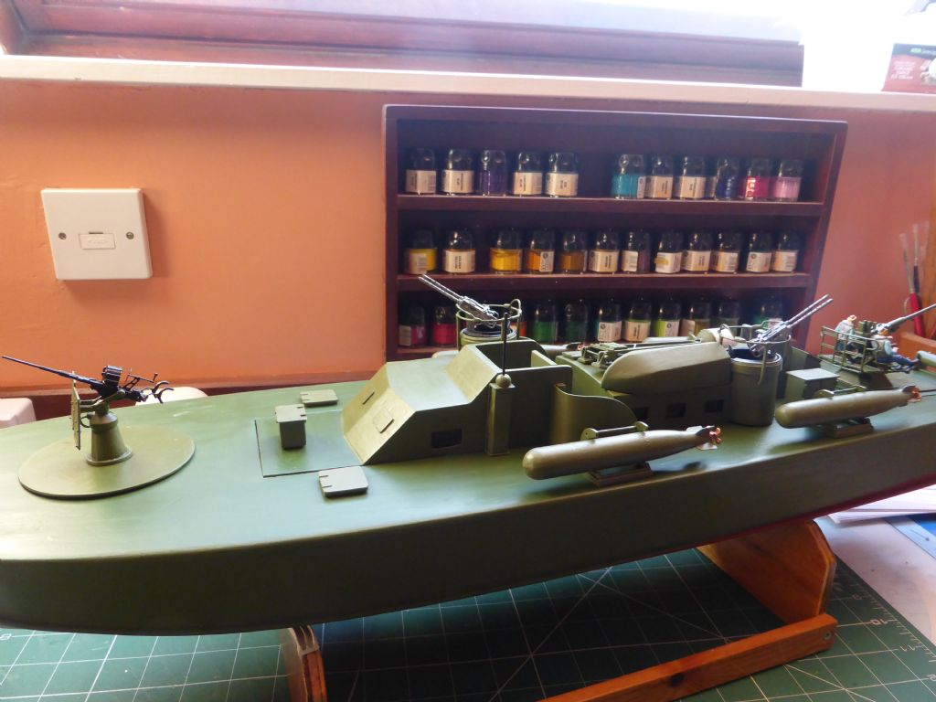

                              A little more progress since August. Need to start the Camo pattern next and fix some of the lockers etc to the deck.

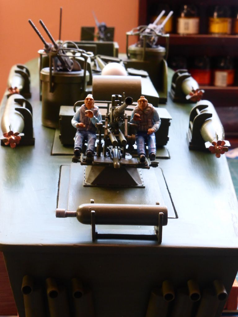

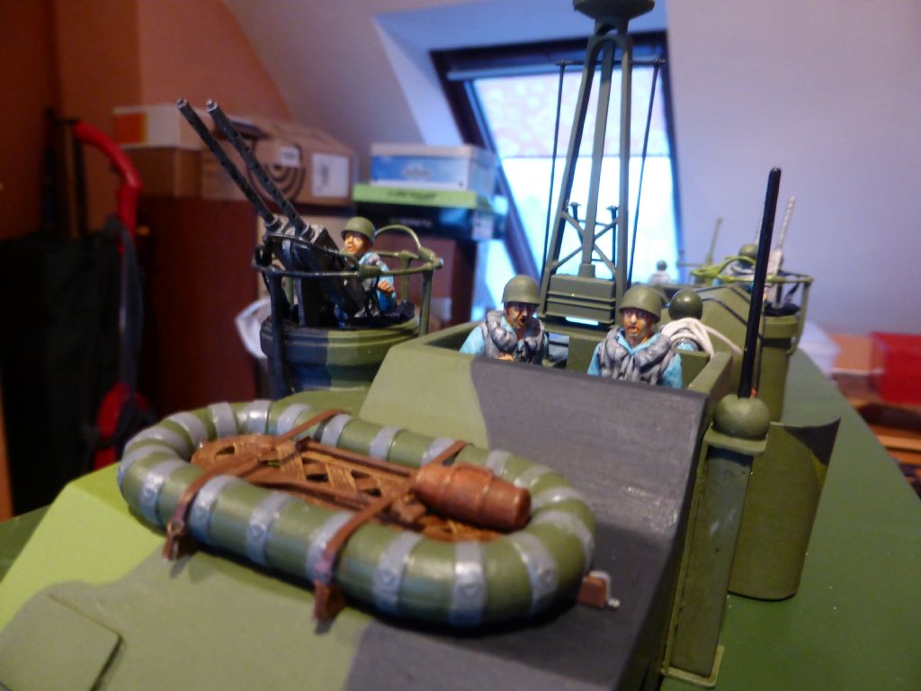

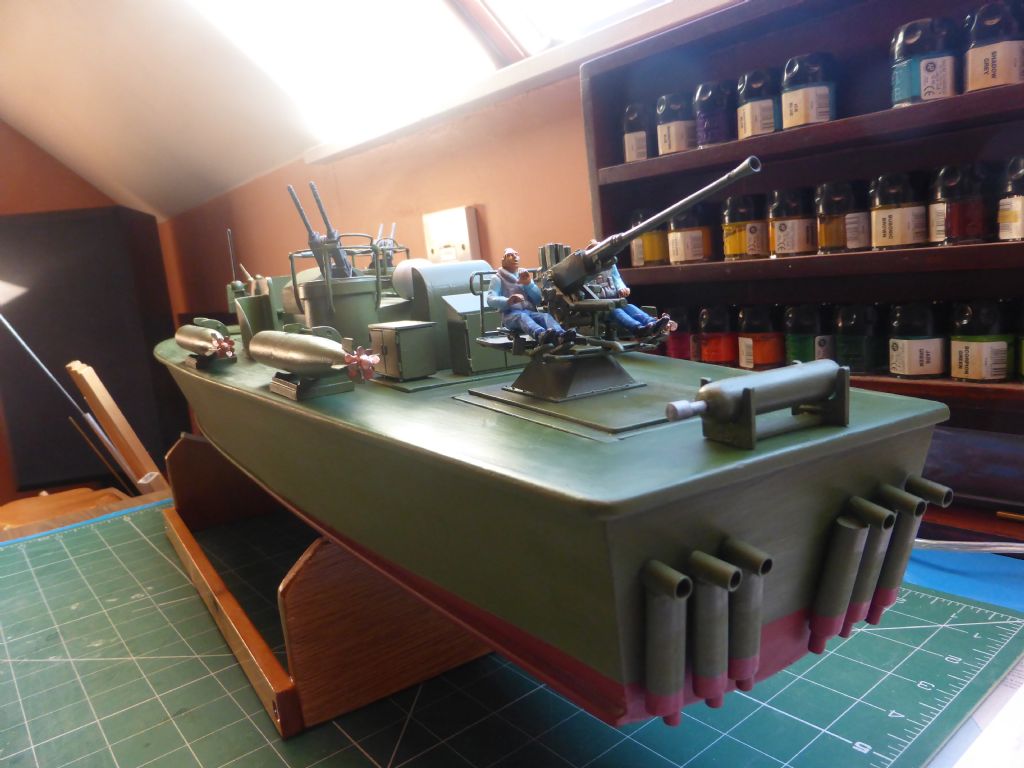

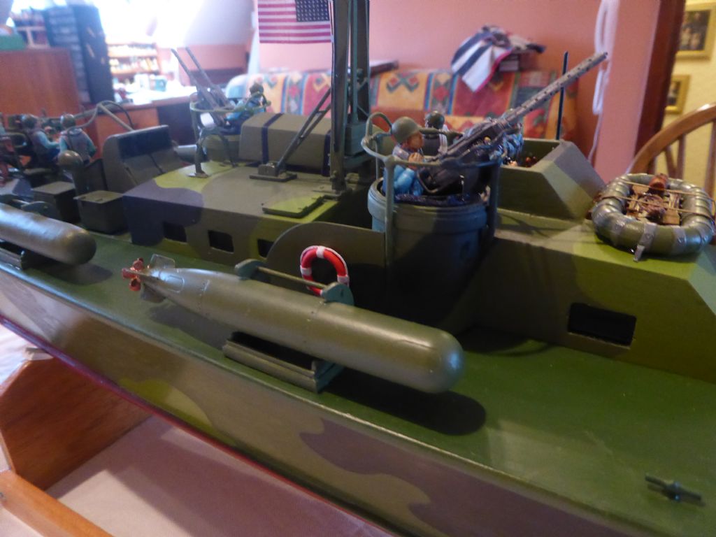

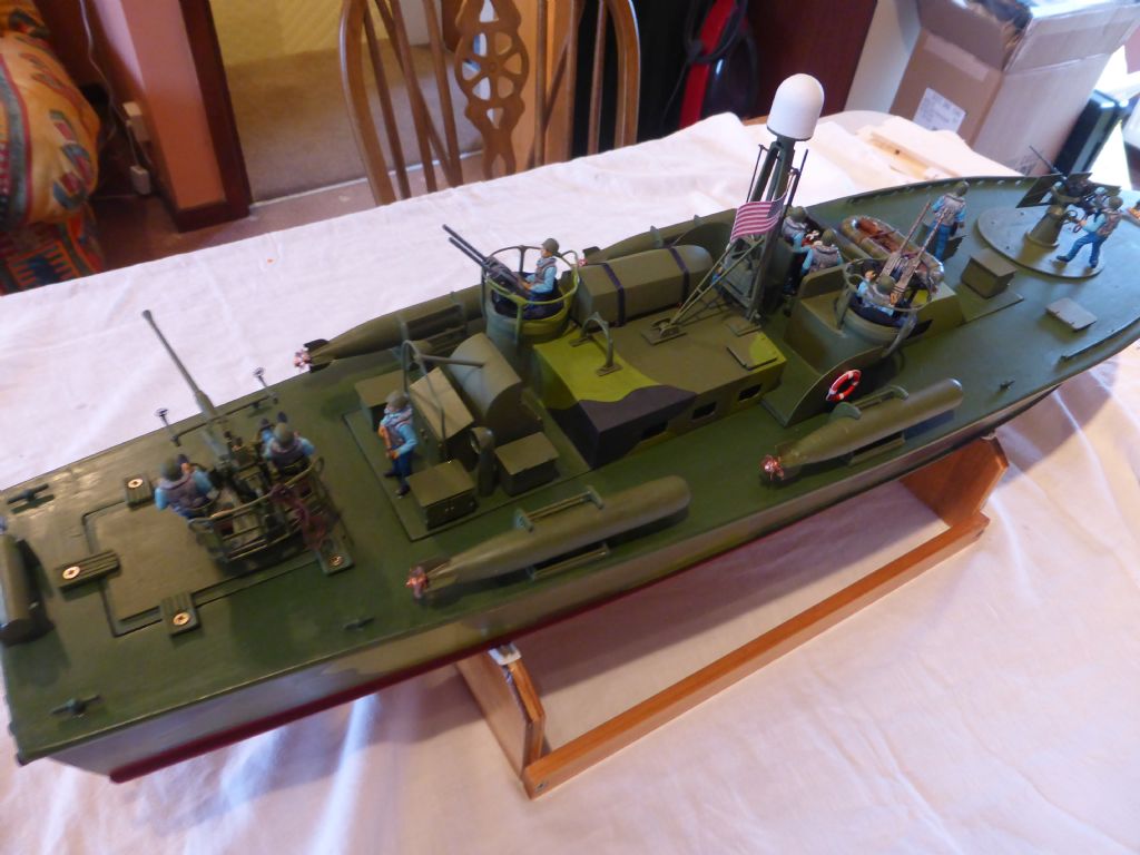

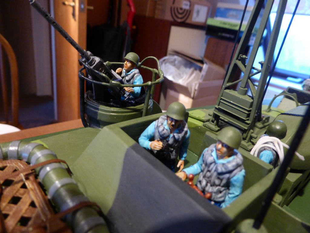

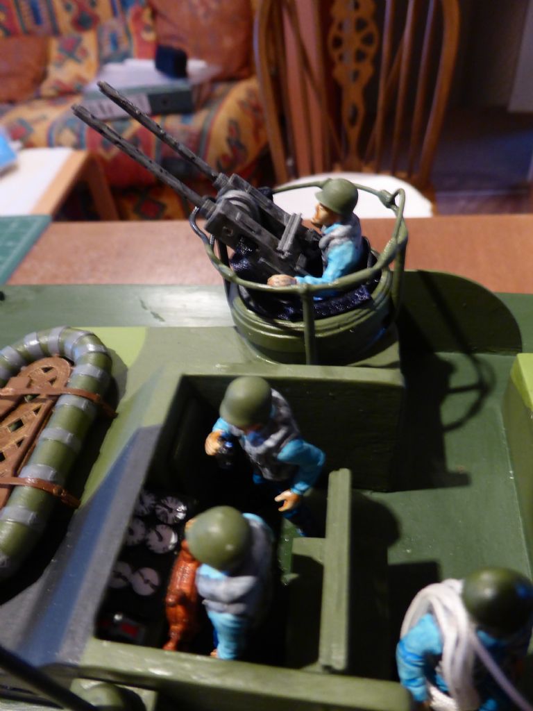

                                    I have used 2 Italeri kits, one for the crew (all those years painting Warhammer figures helped with them) and one for detailing. Fore and aft gun, radar and life raft. The torpedoes are one from the kit, one altered from the kit and 2 from scratch. Twin machine guns are from scratch, the ammunition belts made from ribbon. Making a few deck cleats next and adding torpedoes. Nearly there.
                                    Tim

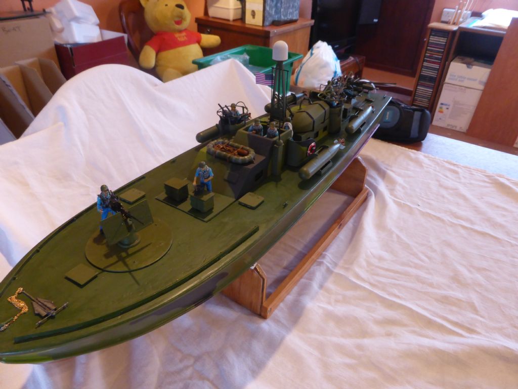

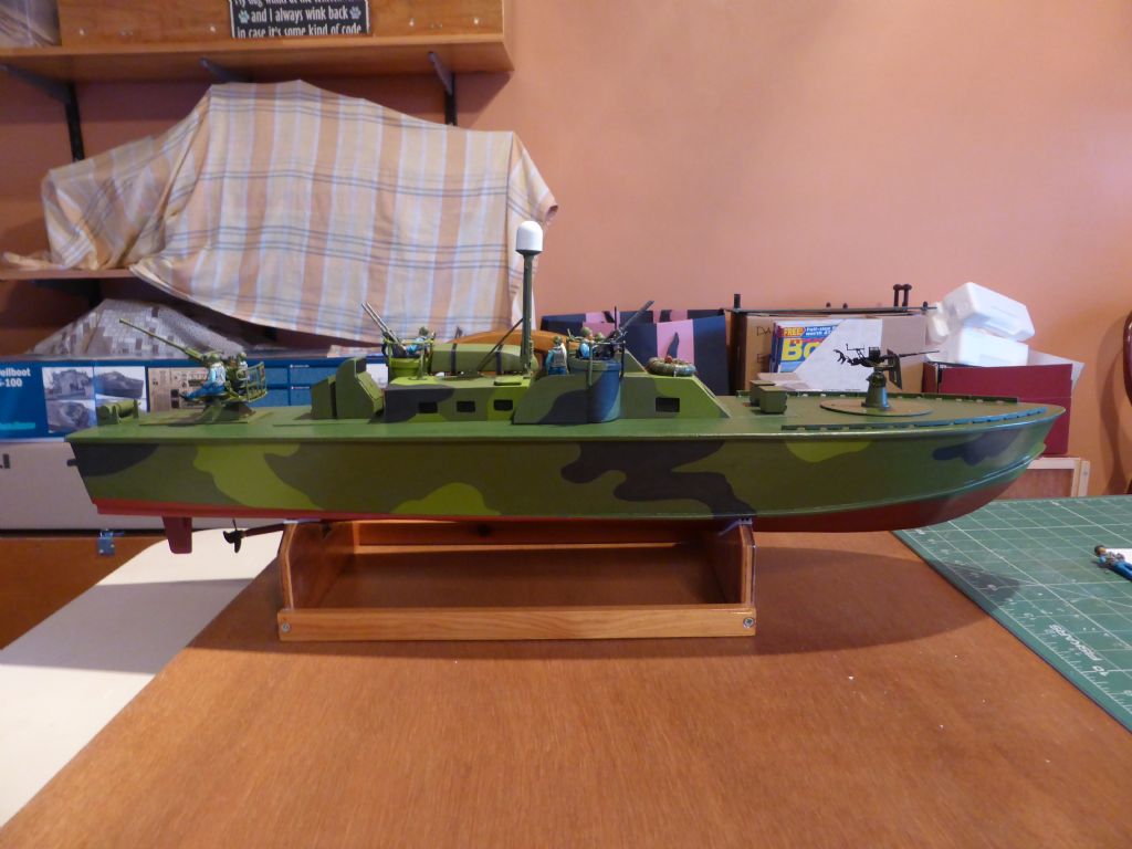

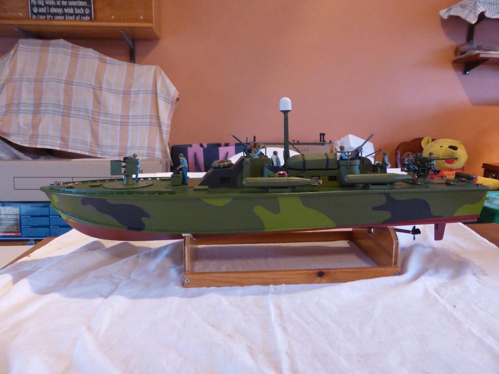

                                      PT Boat is now finished(?).
                                      Motor Leopard 2826/17 and 30 A ESC installed. RX is Corona 40mhx synthesized one bound to a Futaba 6EX.
                                      Just need some nice weather totry it on the water.
                                      Tim
