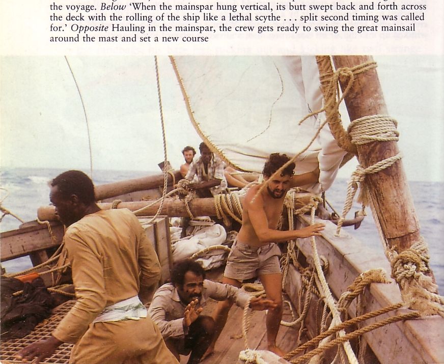

          Here is the photo from Tim Severin’s exciting book “The Sinbad Voyage” (see previous entry) reproduced here by kind permission of the author. It shows the excitement at deck level as a Dhow goes about (wears ship). Below I have quoted directly from Tim’s book (also with permission) as he says it far better than I could. I was very excited to find this description, as one of my design problems is how to set up my model dhow so that under radio control it can wear ship effectively.
          From pp142-143 “The Sinbad Voyage” by Tim Severin 1982 ISBN 0 09150560 7
           Sometimes the wind changed direction with the passage of a squall so that Sohar began to run in dangerously towards the coast. Then I rang the brass bell which summoned all hands on deck. Up they came, rubbing the sleep from their eyes, and stumbling to their regular posi­tions. `Khai-or! Wear ship!’ The manoeuvre of wearing ship meant shifting the mainsail with its huge mainspar from one side of the mast to the other by swinging the whole mass of sail and timber, more than a ton of it, around the foreside of the mast. If the ropes and canvas got in a tangle which checked the smooth swing of the mainspar, the sail would be ripped to shreds, or we could snap the mainspar. It was a difficult and dangerous operation by day, and at night it required real care. Every man had his allotted position on deck so that he knew exactly where to lay his hands on the right rope in the dark, and when to dodge safely out of the way of the lethal sweep of the butt of the mainspar as it swung across the ship. When everyone was in their right place, the helmsman turned Sohar to run downwind. The foredeck crew dragged in the lower end of the diagonal mainspar so that its peak rose vertical, and it hung above the deck like an enormous lance, dangling from the masthead sheaves, the tip fully 8o feet above the deck.
          Next, Saleh’s madcap figure scrambled around the outside of the ship, skipping along the top of the rail, round the foredeck, and back down the opposite side of the vessel. He carried the heavy rope which controlled the mainsail, and which had to be transferred from one side of the ship to the other. As soon as this rope was in position and made secure, the helmsman began to swing Sohar on her new course. A quick, probing flash of a powerful torch beam aloft checked that the ropes and rigging were not tangled, and the maindeck crew cautiously began to ease out the ropes controlling the angle of the mainspar so that it began to tilt back to a diagonal, this time on the opposite side of the mainmast. When the spar had reached its correct angle, half the crew quickly laid hold of the mainsheet and hauled in so that the sail set correctly. The remainder moved about the deck, resetting the rig­ging, tightening up and making fast ropes, wearing round the smaller mizzen sail, rehoisting the jib, and finally the job was done. It usually took half an hour of hard work before the off-duty watch could turn in below to catch up on their sleep . . . until the next time that the fickle wind changed direction, and the anxious voice of the watchleader called softly to me . . . ‘Captain . . . wear ship?’
