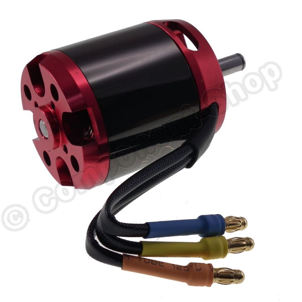

          After taking advice from my good friend DM I have decided to fit brushless motors to Charlie.
          LC3542-5T 1080KV Leopard Outrunner Brushless Motor.

            Has the suggested motor got any provenance, Paul?
            I`ve got all the info regarding the Ellie and SloMo motors, if you are interested

              I know very little about the motor or ESC but I will be doing some research into brushless to bring myself into the 20th century.
              If DM rates them ……..that's good enough for me.

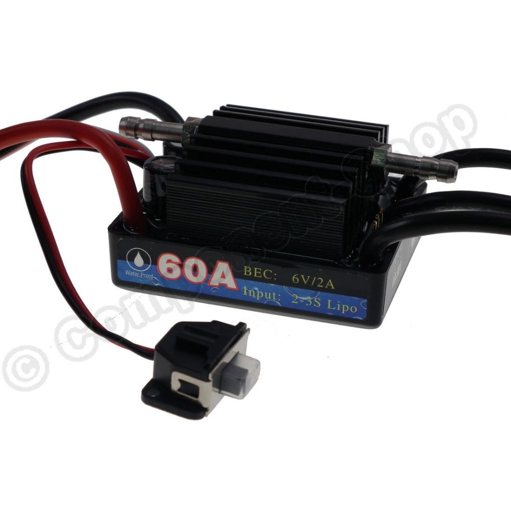

                I've actually slightly modified my "best guess"! I think that perhaps the 960kv 9T version might be more suitable because it will enable better slow-speed control (having more turns) while still being more than powerful enough – especially running on 3S and in tandem with another one. The 60A ESC suggested will be OK for this motor, too.
                The quality of these Leopard motors is astonishing; they are almost works of art. It's also heartening to see a decent heat-sink and sensible-sized cable on a speed controller. Some of the other so-called high-current affairs leave me baffled e.g. no heat-sink and 16AWG cable for a 120A ESC. Neither the motor nor the ESC are cheap but they are coming from a very well-established UK suppliers (Component Shop), so there will be no problem with after-sales service or warranty issues.
