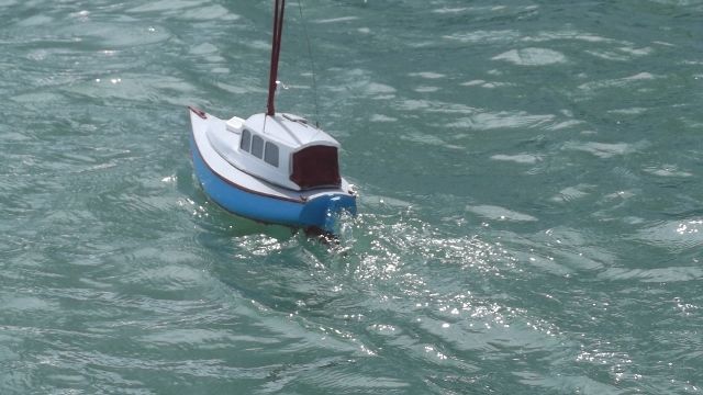

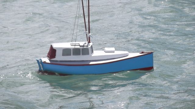

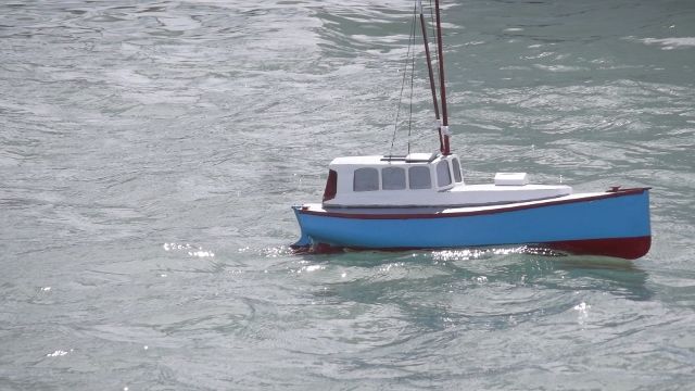

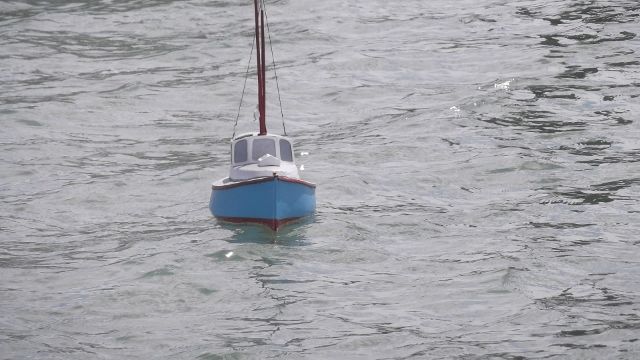

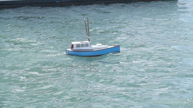

            Well, here we go.
            Yay!

              Hello Amy jane,
              That looks very, very nice indeed — congratulations on a succesful build! The large scale makes her look quite at home in the water, too!
              Are you happy with how she runs and handles?
              /Mattias

                Hi Mattias, Thanks for the kind words.
                She's very simple compared to your fine model, but yes, I'm quite pleased with her! The speed is quite scale like as you can see from the wave pattern in the bottom photo (she has no throttle, so the motor is just on or off) and she steers well.
                I had to play with the prop size quite a bit, was over proped, so ended up with a 35mm two blade. She is running on 7 cells. (I don't have an amp meter, but my feeling is she is pulling about 10 or a little more amps). I need to make up some more battery packs. Sadly the only nicads I can get around here are AA's, so I'll have to double them up to get a decent run time.

                #56181
                  AmyJ. good work. Great photos, lovely colour sea and the sky blue boat looks very pretty.
                  A more unusual shape than normally aired on the forum, and an unusual build to be sure.
                  Super.
                  Next one please.

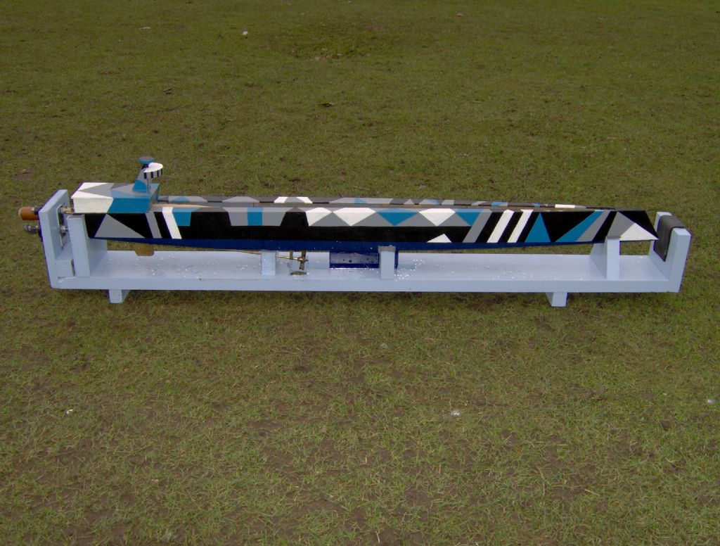

                        Below. 20m of best glycerin lubricated flight rubber, 50mm 5-blade prop.
                        ashleyboat2#2

                              AmyJ. You have it on the nose. tractor prop so the gears could be as far back as poss, and so maximising rubber length. All rubber motors really need to be UP geared. I think about 5;1 on mine . The torque on that much rubber has to be felt to be believed. With no gearing the thing would shoot off like a dragster for 10 feet and then run out of steam. About 120 yards I reconed is about the run i got from it. IOt comfortably outpaced several boats on its debut! (for a bit, anyway)
                              The stand has winding gear built in, so you just dock the boat, make sure the drive engages (dogs) and wind the handle 8 or so times (2.5;1 gearing ….I cant remember properly now, I should have to consult the magazine that had the boat featured (my first feature, oddly enouigh)
                              4mm ply hull, draught aboutr 20mm. Small keel to counter tourque. What rubber band boats also need is some sort of govenor, would make a big difference to performance.

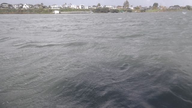

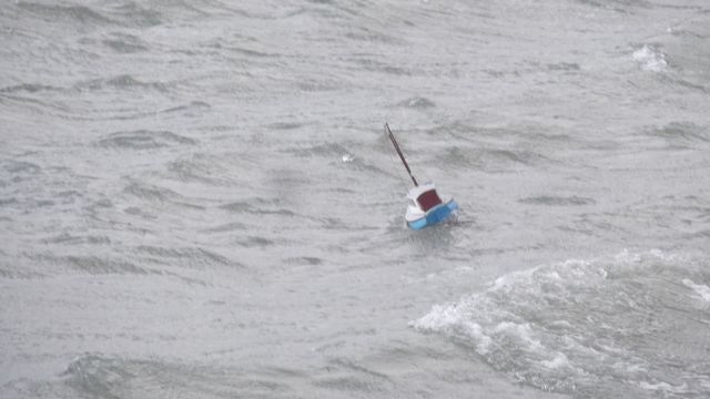

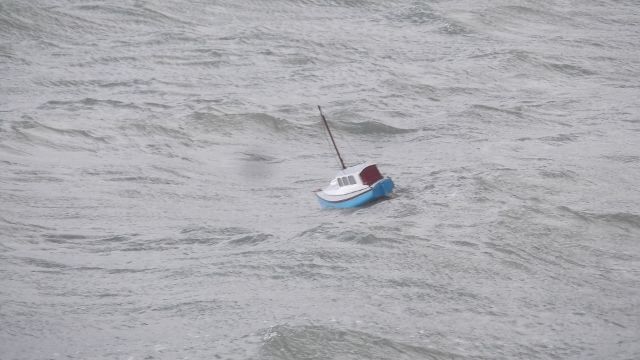

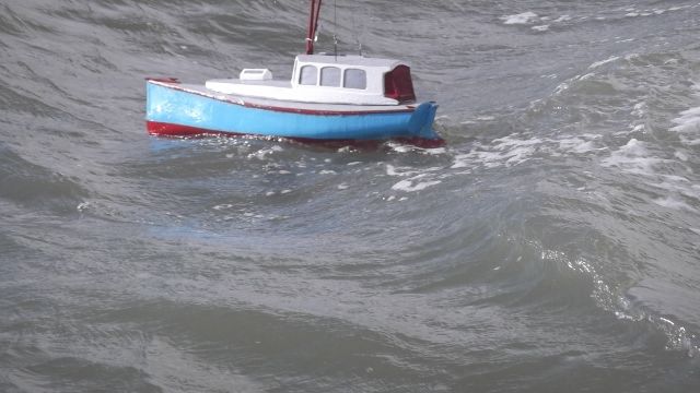

                                          Hi all
                                          Just thought I'd post a couple of pics of Cassie out playing in a bit of a chop. Not as rough as I wanted, but she was having a grand old time.
                                          No fuss at all…

                                            Brave little ship
                                            But she`s not making much headway?
                                            #60141
                                            Amy jane September
                                              @amyjaneseptember49770
                                              A bit deceptive, Bob. She's getting along well, but in a following sea the waves are overtaking the boat!
                                              #60142
                                                I really do admire your nautical knowledge, Amy
                                                A very good answer
                                                Like a loco with the wind behind it?
