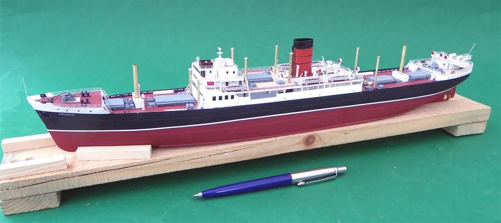

          @bobwilson59101
          It is now ready for masting and rigging. Quite a lot of fine detail has been added since the last image.
          #60487
            Looking lovelier than ever!
            The quality of build is fantastic and so precise
            Well done, Bob

              #60570
                @bobwilson59101
                The Arabia is now complete!

                #60575
                  Another lovely job Bob. The funnel position does look a bit odd though. The design and positioning of the funnel always has a huge influence on the overall harmony of a ship design. The old French Pasteur and the Cunard's Caronia both had very large funnels but the former looked grotesque and the latter very elegant. I also thought the designers got the design right with Shaw Savill's innovative engines aft Southern Cross but her near sister Northern Star just didn't seem to gel in quite the same way and was in fact the less successful of the two operationally.
                  With Canadian Pacific it was a bit of a three bears situation. The Empress of Asia had slightly too thin funnels, the Empress of Britain's were too fat but the Empress of Japan was near perfect.
                  #60577
                    @bobwilson59101
                    Thanks Colin, I would agree with you on most of the funnels mentioned, and the Pasteur was the worst of the lot!
                    Arabia's funnel looks well-placed to me, but I am thinking about it from a personal point of view. I always liked sailing in ship with the central gap, sometimes with a hatch in it. It provided a sheltered place to hang around on warm, but windy afternoons with an unrestricted view on both sides.
                    The Arabia took a total of 81 hours, 42 minutes to build. That included the display case and carrying case!

                      #60862
                        @bobwilson59101
                        This one has proceeded in pretty much the same way as most of my other models! Lots of views, but really very little interest shown by ship modellers in general. On completion, I put it on my website at 1335BST on the 28th. It sold at about 1600BST the same day!smiley After making a stout external packing case, that took a few days, I sent it off to Belgium at 1030BST yesterday (13th) and it arrived safe and sound at about 1400BST today!
                        That is very good going! I don't think I will ever understand why ship model builders are not very keen on making this type of ship, but collectors love them!
