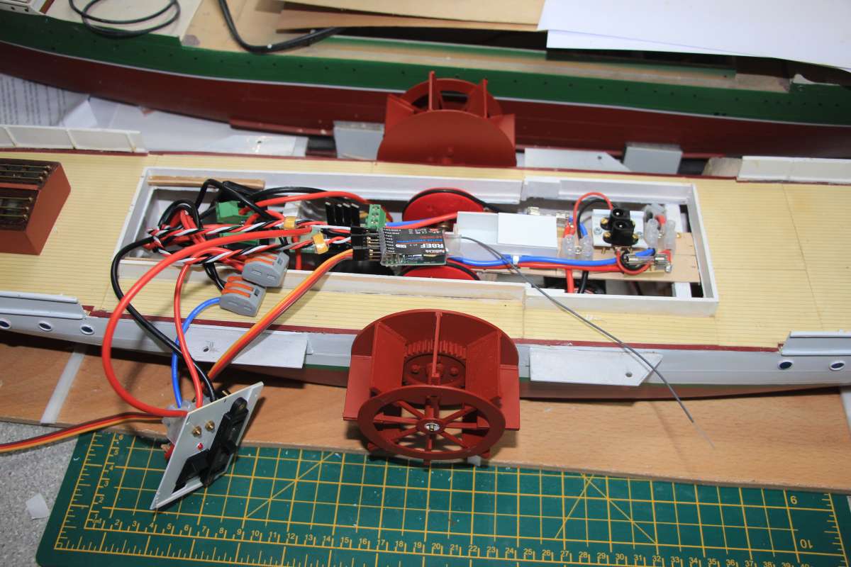

            With my NiMH powered boats I usually leave the battery in the boat and  bring out a charging socket which can be concealed under a deck hatch or fitting.There is no need to fast charge them so they don’t get hot.
            Often the battery is buried within the hull and on my paddler I brought the charging ports up to deck level where they can be easily accessed with the deck off. (see black sockets in photo).
            The LiPo batteries for my Fairey power boats are kept in a fire retardant pouch inside a tin box though!
            IMG_3857

              My goodness! That’s busy, to say the least!
              Two questions:
              • What are the little grey and orange things that look as though they are jointing wires? Never seen anything like them.
              • How are you switching the batteries from supplying  power to the motors/ESCs to accepting charge from the sockets?
              Nick

                Nick,
                The orange and grey things are WAGO connectors. It is now possible to get smaller ones, the 221 size which includes inline connectors. Google WAGO connectors and have a look at this link:
                https://www.wago.com/gb/electrical-interconnections/discover-installation-terminal-blocks-and-connectors/221
                You can buy them on Amazon and elsewhere. They are very handy. Better than chocolate block screw connectors. Search on WAGO 221 connector. There are other makes but WAGO are the best.
                As far as fitting charging points is concerned I always fit an isolating switch to the positive battery supply so that everything inside the boat can be switched off. The positive charging socket lead is taken directly from the battery terminal connection before the isolating switch and the negative charging lead is taken from the negative battery terminal connection. This does mean that the charging socket is always ‘live’ to the battery of course. (it can be useful in measuring the battery voltage if the battery is buried in the depth of the  boat).
                Obviously you won’t want to connect the charger when the main boat circuit is live so an alternative option is to make the main switch a single pole double throw (SPDT) switch so that the connection is either to the charging socket or to the boat system but not both at once. Explained here:
                https://www.nextpcb.com/blog/spdt-switch
                Hope this helps,
