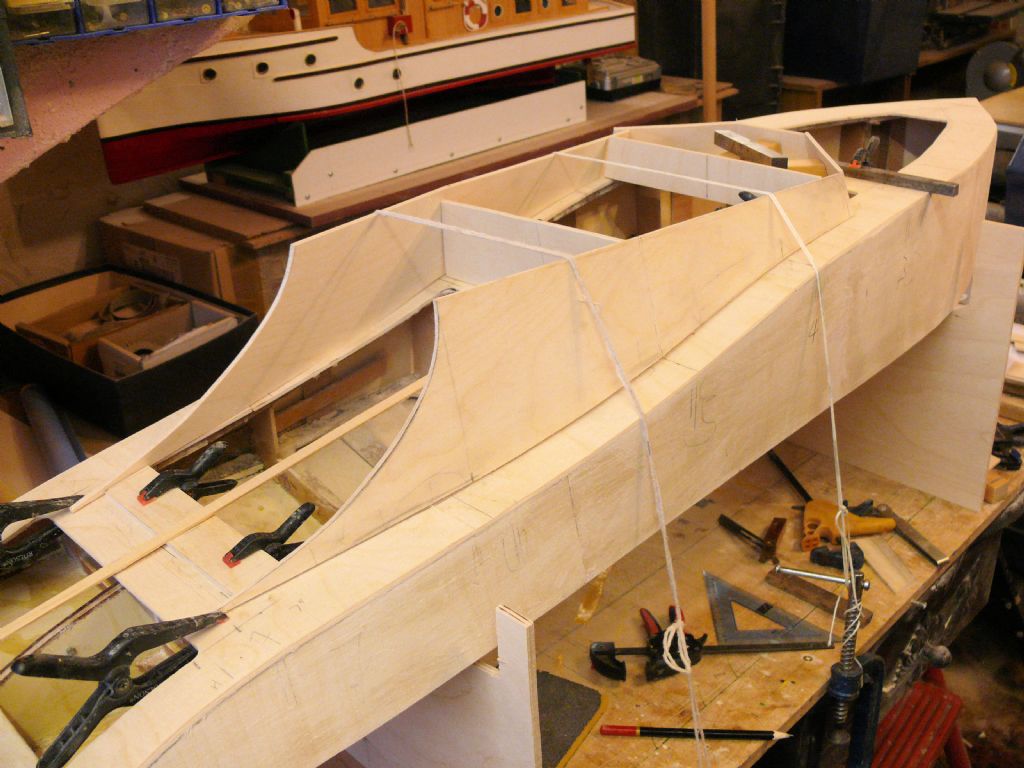

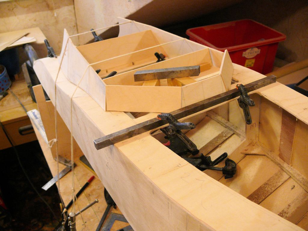

          Working on the superstructure and have just roughed out the side walls and front windows
          For Paul`s benefit
          I think it`s looking quite good at this early stage?

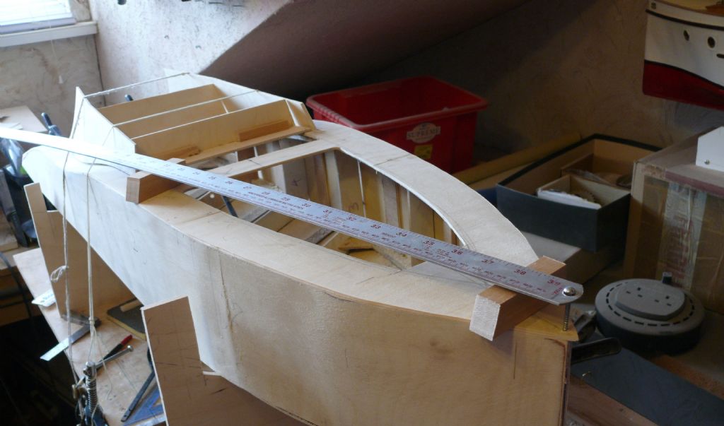

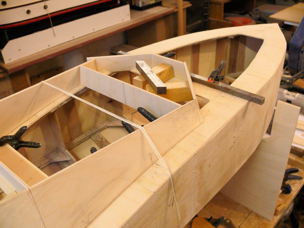

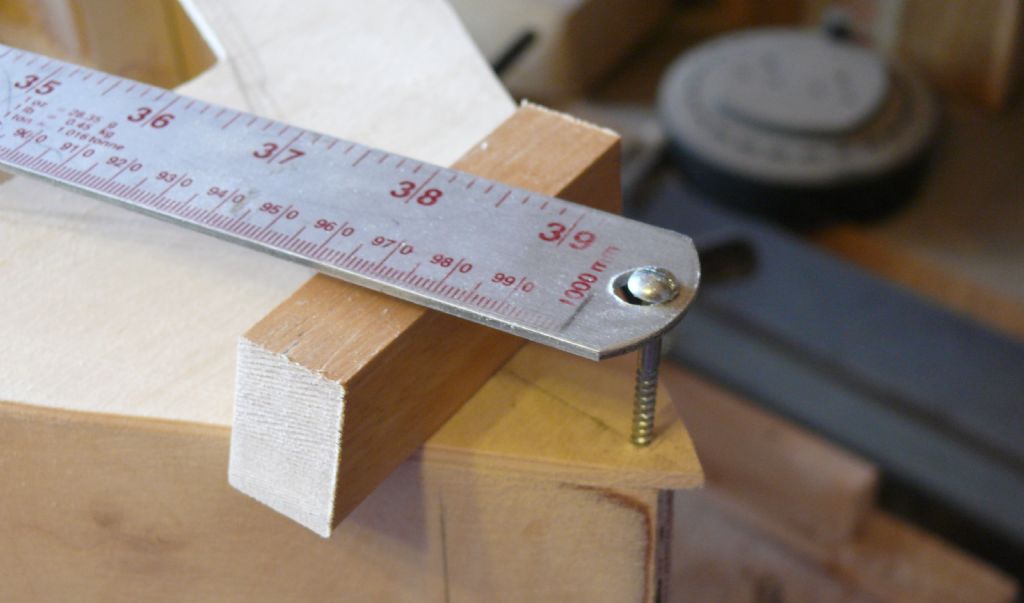

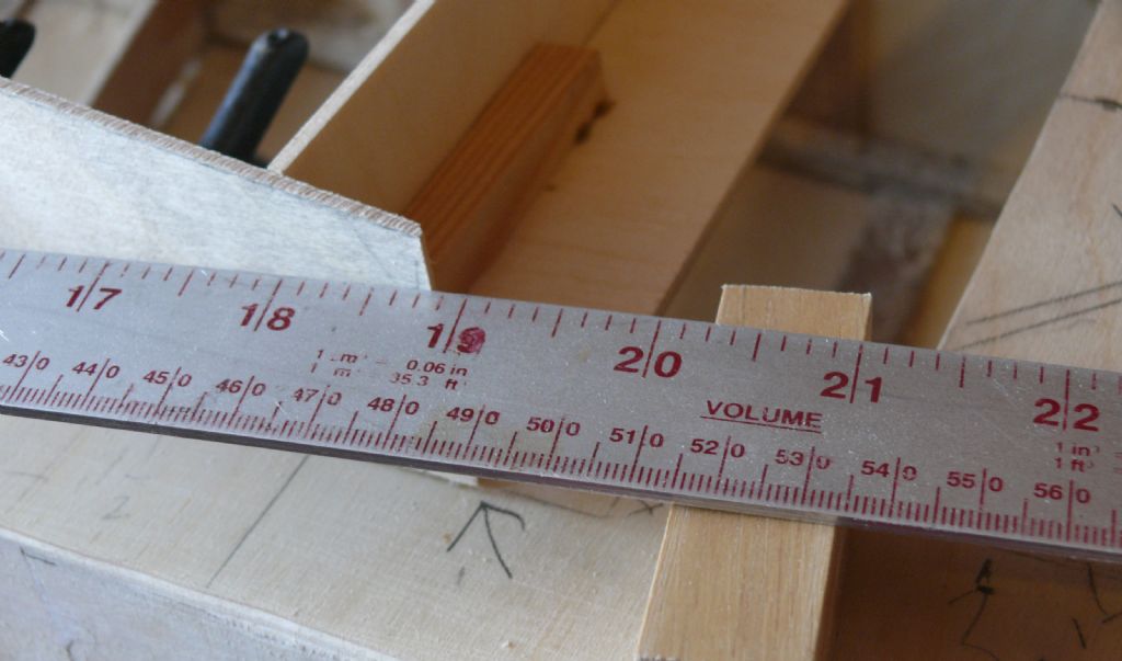

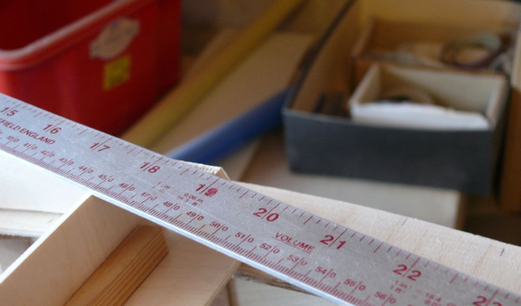

                  Now then, because there are no straight , square or easy reference points on the hull.
                  I came up with a cunning plan! I fitted a woodscrew up front, to act as a datum reference
                  Then drilled out the one metre rule to slip over the screw head and then checked the salient points for symmetry
                  Low and behold they weren`t that far off!
                  #89747
                    That's a clever idea Bob.
                    #89750
                      Thank you, Colin, I'm rather pleased that I've sorted it out
                      I hate guessing and hoping for the best

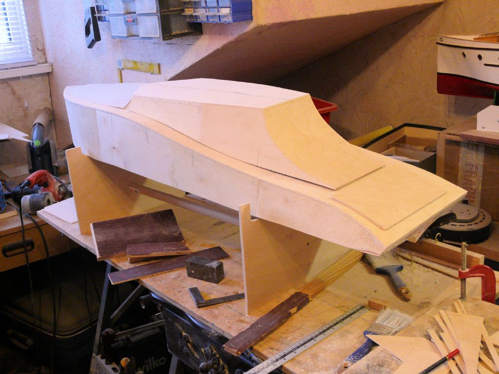

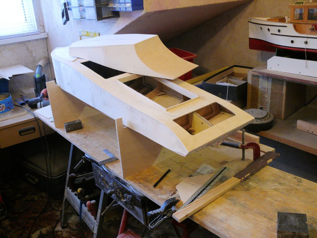

                        Latest progress development
                        The Top Section was a bit of a struggle, but it has turned out quite nice
                        Like it, Paul?

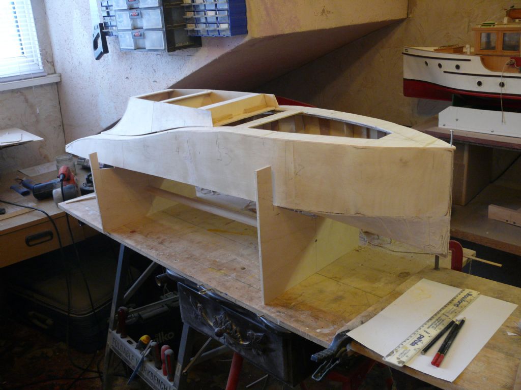

                            Working on the decking and super structure at the moment and tidying things up

                            #89866
                              More progress on the covers and hatches etc
                              It feels a bit heavy now?
