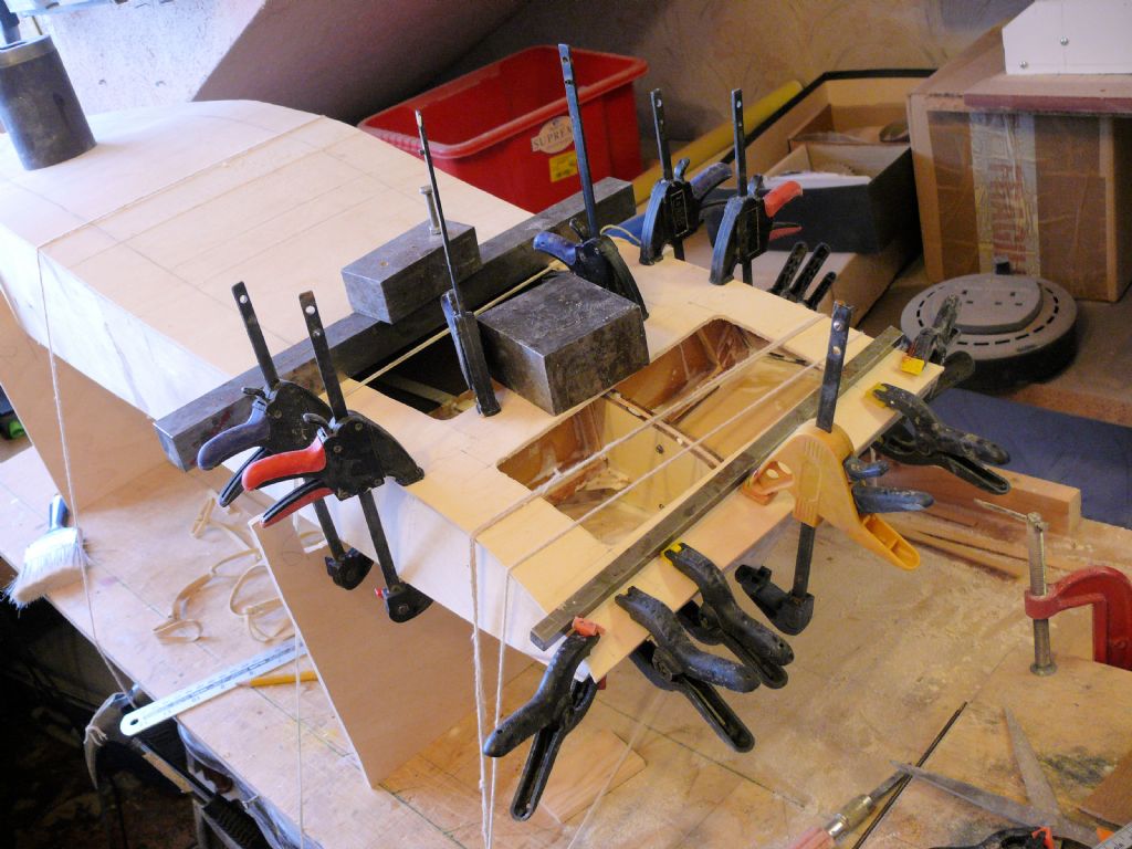

                      Progress p[cture
                      Finally made a start on the decking, will be nice to hide all that Hardboard stuff

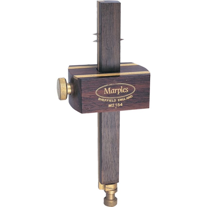

                        Here is another chance for a master class as you could explain to Kevin what that strange looking wooden tool is for.
                        Is that a pencil that you have in it?
                        I doubt that 1 in 50 people young people could even guess at what it is.
                        #89618
                          Do you know, Paul, I put that strange device on for your benefit!
                          i know you take delight in spotting the tools of yesteryear……Like my Spokeshave etc
                          I used it for marking the width of the decking around the deck edge
                          Well done my mate for bringing the forum down on a level keel!
                          #89621
                            Back to an age when tools were an investment and lasted a life time.
                            For example to buy this one today would cost £67 but it is a beautifully made piece of equipment.
                            How many forum members under 40 can tell us what it is?

                              I`ve got my hand up, Sir……..It`s for marking out Mortice and Tenon joints
                              The Marking gauge on my boat photo was purchased about 1949
                              You ask a teenager to demo it…….Most have no idea

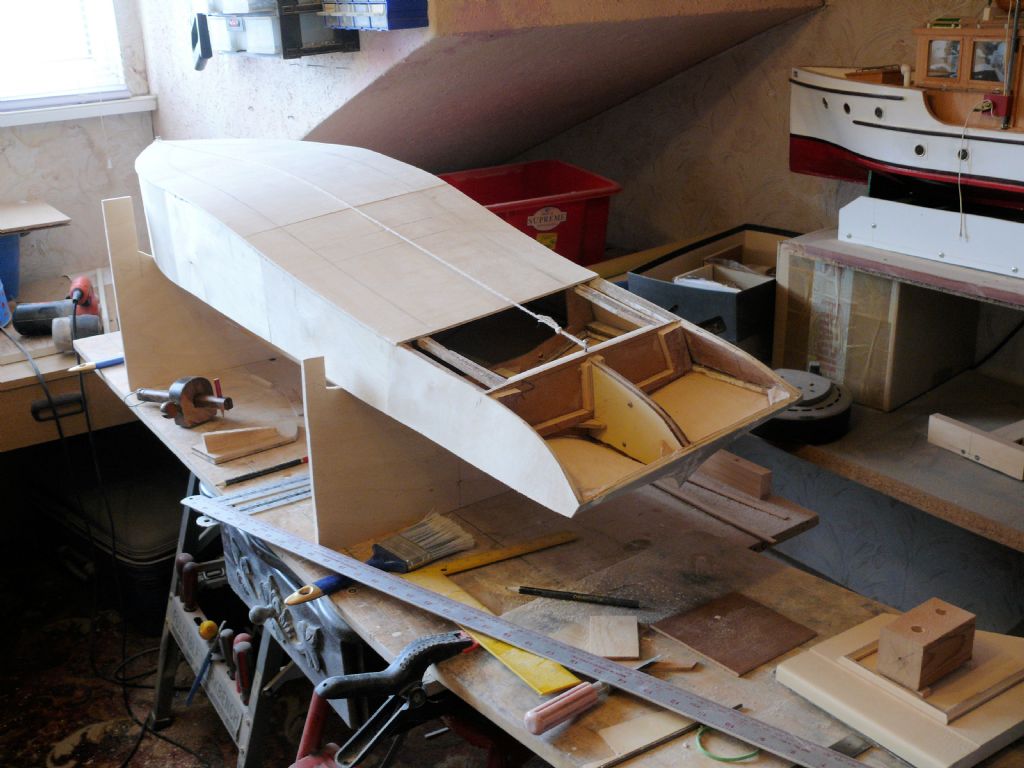

                                    Progress picture
                                    Working on the stern section now and is working out OK
                                    On the original Brutus, the Rudder mech was in the rear compartment, which only allowed for very short rudder shafts and water ingress was a problem
                                    I`m thinking of fitting normal rudders in the next compartment and moving the props up too

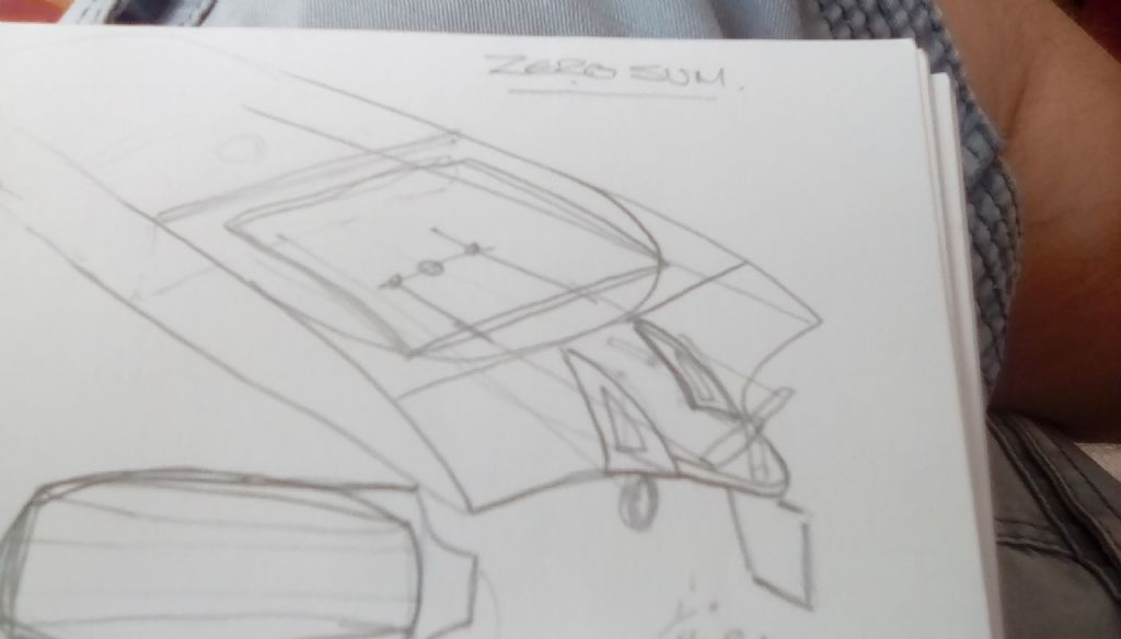

                                      Hi Bob,
                                      Why not put the rudder behind the boat ??
                                      Here is a concept from my sketch book, no issue with the water getting in, as it's mounted on an external platform and you can have the prop or props nearer the stern 😀img_20200702_112057.jpg
                                      Could be closed loop or push rods or chain drive your favourite!!

                                        Hi Ray
                                        That`s not a bad idea and could look good too
                                        Will bear it in mind, my mate……..Thanks a lot
                                        May be too far from the props……Could fit the props pointing in reverse?

                                          Bob I honestly don't know how the performance dynamics will be effected by moving the props and rudders so much further forward.
                                          As you will remember a lot of time was invested in designing the hull around the motors/props/batteries/rudders in their current positions which equated to a very finely calculated centre of gravity, moving everything forward will significantly change this critical point and it is very possible that the model will become nose heavy and 'dig in' as opposed to gliding over the water.
                                          Extra ballast would re-trim the boat but the extra weight will only compound the problem as the hull would sit to low in the water
                                          I'm sorry to say that I don't think that it is a good idea however this is your build and you are free to do whatever you want, I might be wrong about how the change will effect the boat but if you want to try then I am happy to re-do the calcs but this will take a couple of days.
                                          Rays idea has certain advantages but from the original design perspective it would ruin the hydrodynamics of the stern by introducing a surface piercing element in an area intended for smooth water.
                                          Another soloution to your problem would be to fit azipods with full 360deg rotation, this would have the advantage of lowering the C of G without moving it further forward.

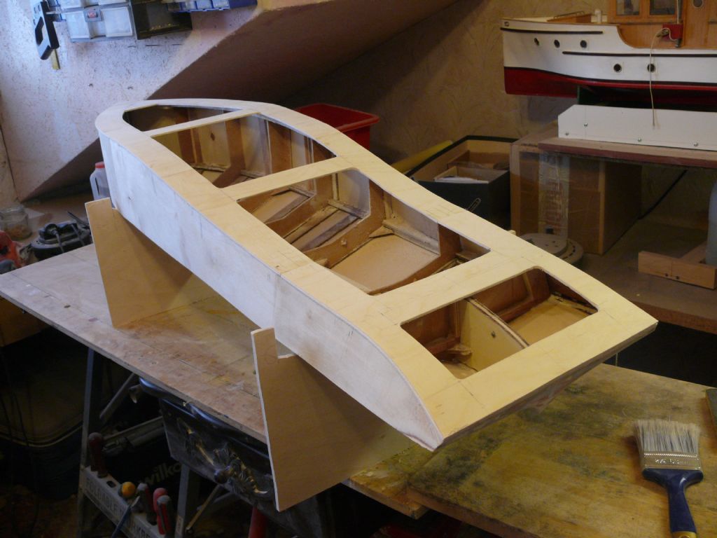

                                                Rapid progress today
                                                Opened the decking for access to the motors and control gear etc
