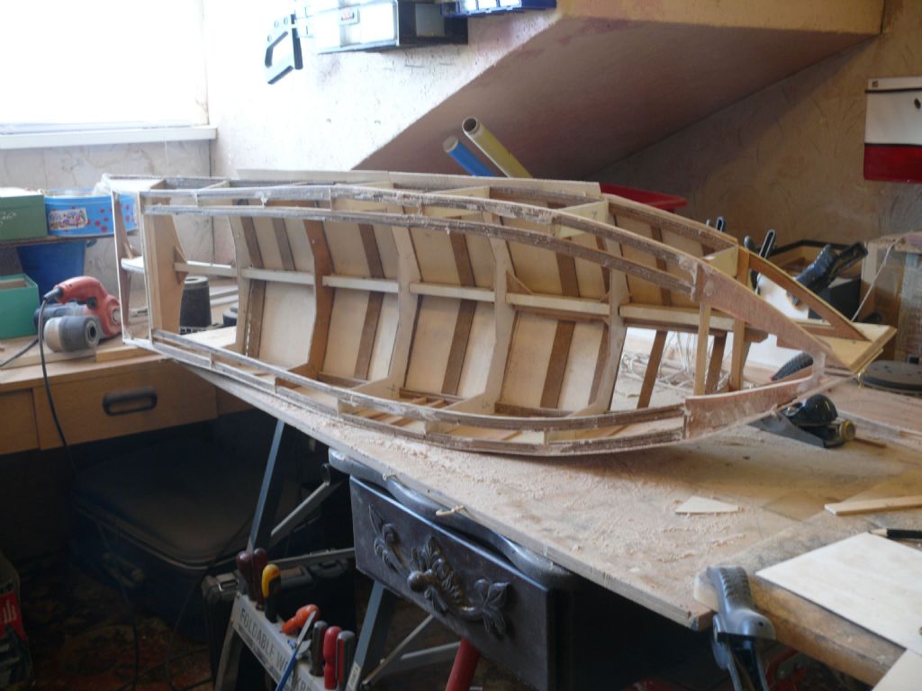

      Added a few more hull supports for the 1 mm ply covering…..or 1.5 mm……..To be decided shortly
      So it`s full steam ahead now

        Hello Captain Bob
        You have built a very strong and rigid frame, ideal for straight running and perfect for a pair of high speed motors.
        I am looking forward to seeing this on the water.

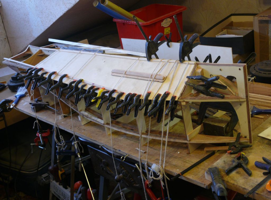

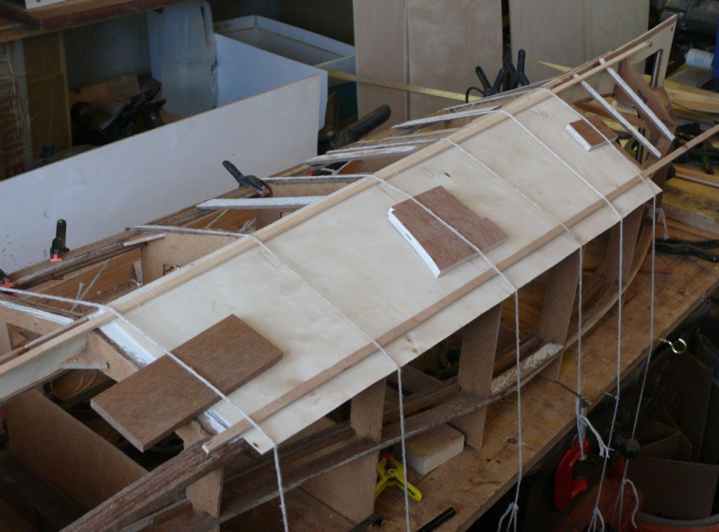

              Made a start on the hull skinning and….So far so good
              Going cross grain has proved to be the perfect choice
              #89237

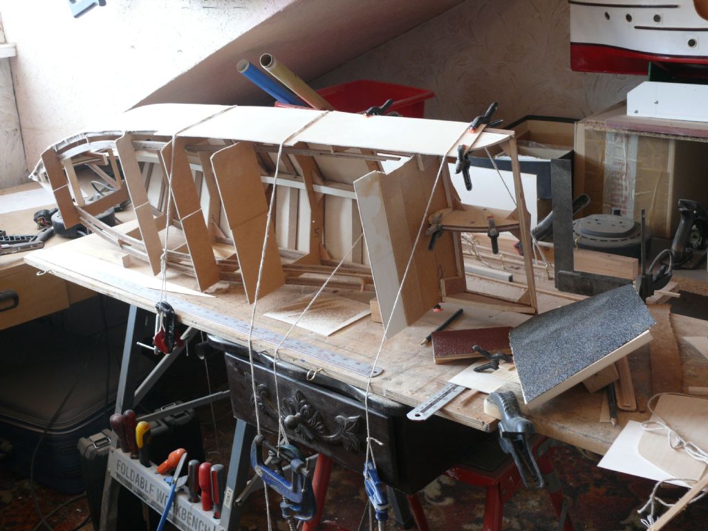

                Making good progress
                #89251
                  Looks like a Boy Scouts tent now Bob…

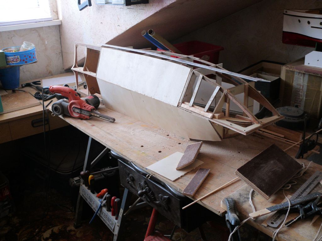

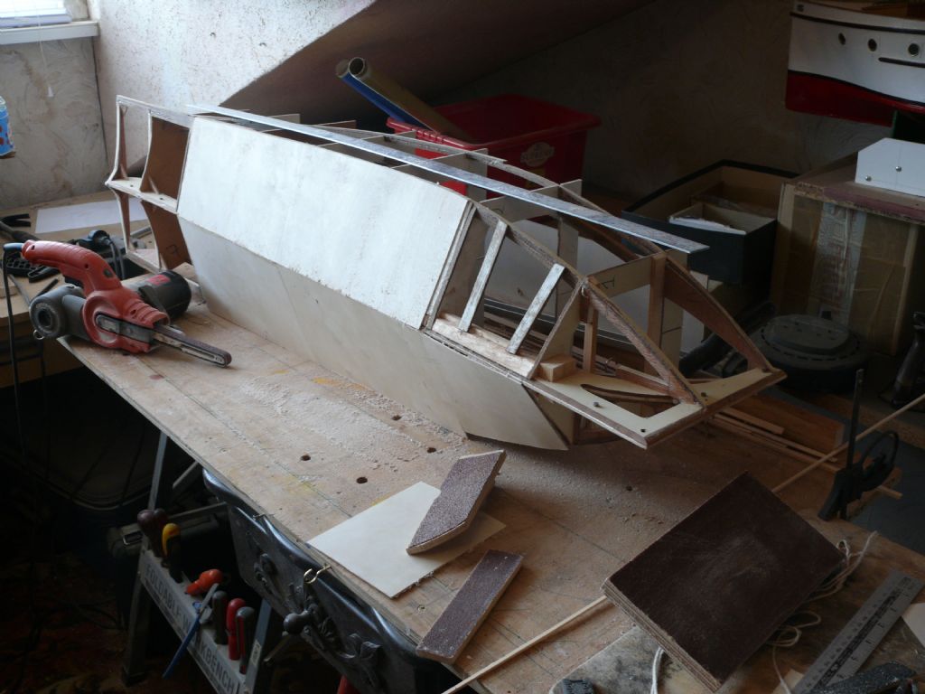

                            Back to the real world
                            Was pleased to see that all is well with the hull sheeting
                            Note the Power Belt Sander, a very handy machine but, can run amok at times!

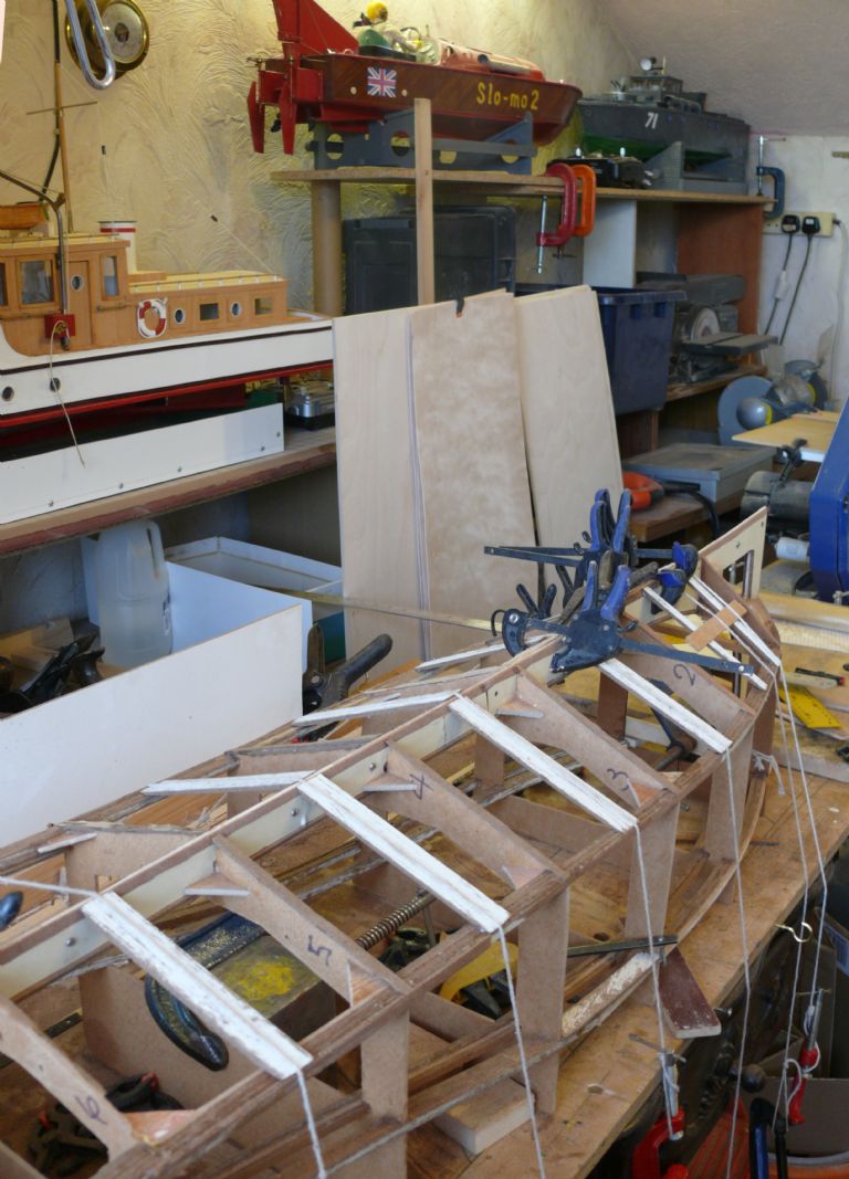

                              #89278
                                Hi there Paul
                                When hull skinning is being carried out, I need every single one and then some!
                                I like the string and weight idea these days, and is nice to use
                                There are two stringers,on the inside of the hatch, they don`t seem to have an end notch in former 7?
                                Only hope you know what I`m on about?
                                #89284
                                  Hello Bob
                                  Yes I do know what you are talking about,.
                                  From memory F7 is intended as a solid bulkhead and that the stringers connect to a horizontal section fixed across the bow side of F7, but there is no reason why a couple of notches cant be created in F7 to accommodate the stringers.
                                  #89287
                                    Thanks Paul
                                    I`ll try and cut two notches
                                    Thanks

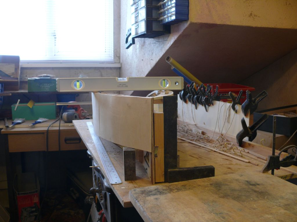

                                    #89323
                                      Progress pictures showing the hull frame being sheeted over with 1.5 mm Birch Ply
                                      There is a subtle twist shape towards the stern and checking for a smooth transition is quite tricky, but we are getting there now
                                      #89324
                                        Hi Bob,
                                        Are you going to plank the stern fore & aft to achieve that concave shape ?? The bow is where I'd use block and carve a nice flare from the chine to the keel/stem 😄
                                        #89325
                                          Hi Ray, the sheet can handle the flare
                                          But the bows will need planking vertically

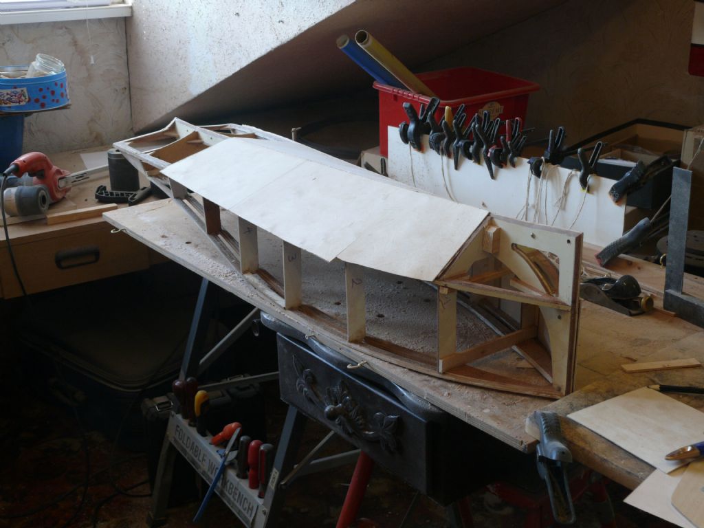

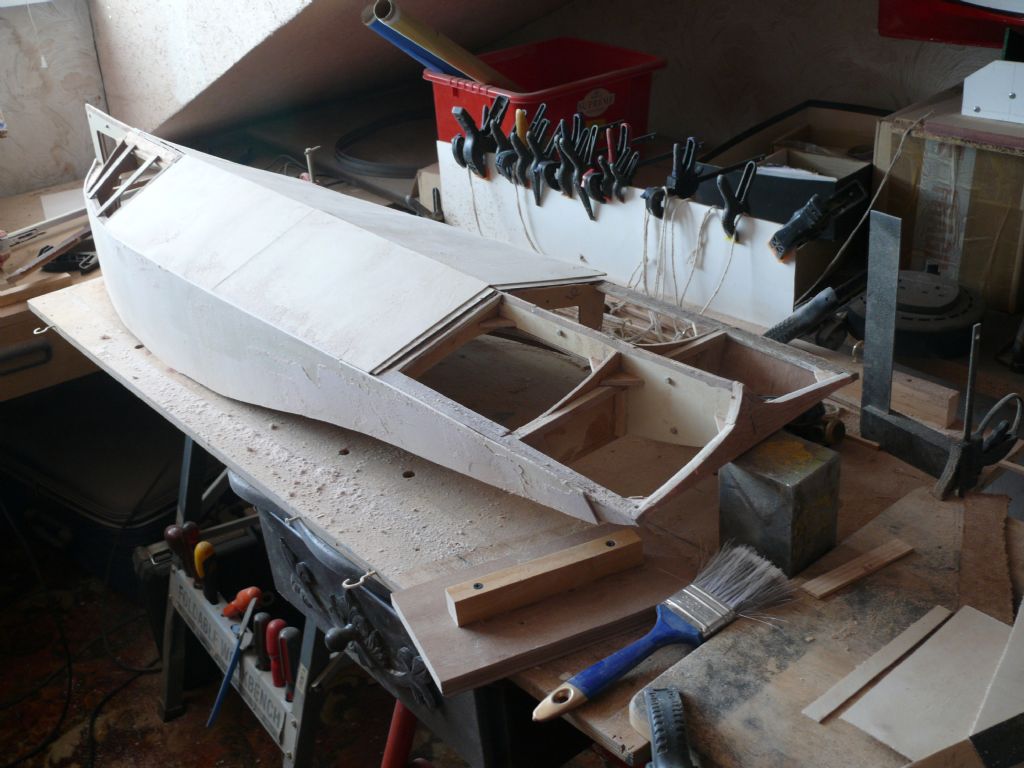

                                            A few photos of latest state of play……
                                            Apologies for slight photo mix up

                                                #89366
                                                  Captain Bob
                                                  A very professional looking build and as usual your photos are first rate.
                                                  It might help watchers (remember Kevin) if you could tell them what type of glue you are using and if you are using any mechanical fixings such as pins or screws.
                                                  #89368
                                                    Thank you, Paul
                                                    For Kevin`s benefit, I used Hardboard for the formers and multi hardboard strips for the stringers, mainly because I had no proper wood in stock. It has done the job well enough using a quality strong glue, Evostik Exterior Glue, that sets like concrete after 24 hours.
                                                    At the moment I`m lining up the structure on the bench and checking for squareness and twist etc and grinding down the lumps and bumps and high spots, before finishing the hull sheeting. The bench is a little small though
