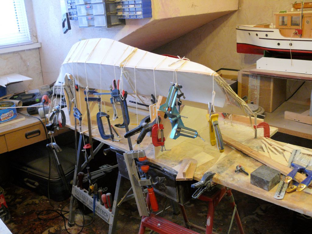

                        Fitting the hull rubbing strips using the weighted string idea, which is ideal for working on large model hulls
                        The trick is to have plenty of strong string and plenty of weighty things to dangle on same

                            Bob. I like the string idea, it’s much better than using tape which I find tends to pull or lose tension. With the string you have good tension all round.
                            Did the original look like it needed spray rails? I must say that having the rubbing strip become a spray rail is an ingenious idea.

                              I`m pleased you like the string idea, Ash, I quite enjoy using them myself
                              I`ve got them all hung up on nails on the wall
                              The problem at times is finding enough weighty bits

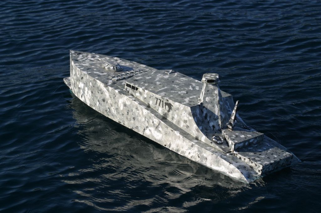

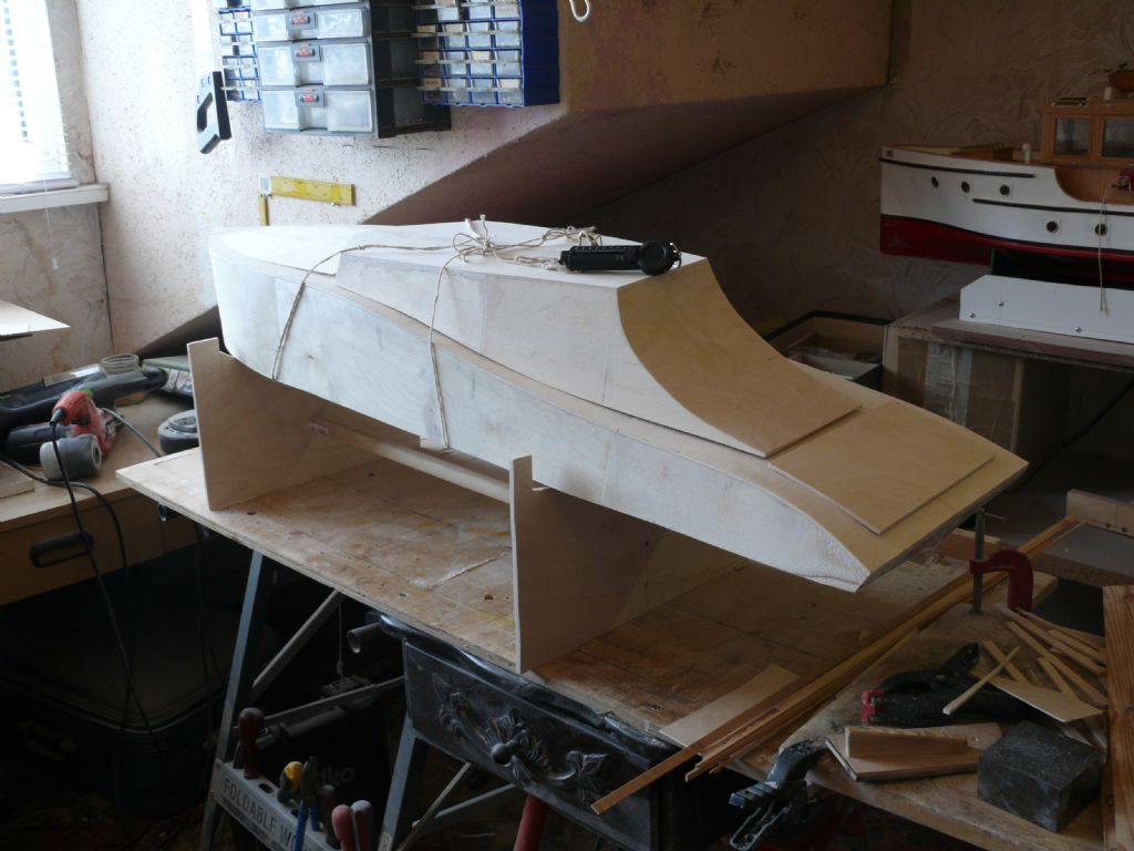

                                    Yes wings would be a novelty but my rusty slide rule informs me that to provide any lift each wing would need to be 150mm long and 100mm from leading to trailing edge and you would need some very serious motors to reach 'flying' speed.
                                    Oddly enough your imagination isn't far off the mark.
                                    You might find the following pictures interesting, MK1 had two bow mounted torpedo tubes mounted within the small wing fitted just above the waterline, although it didn't provide any lift this fixture also doubled up as a very effective spray deflector.

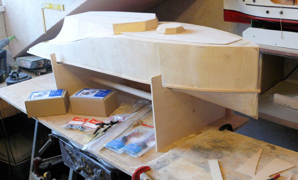

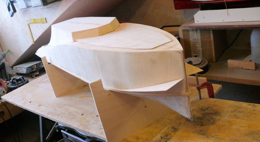

                                      For Kevin`s information this is a lash up of what I was suggesting
                                      A pair of small wings mounted at the front to deflect the spray and possibly provide some lift and perhaps look very pretty and a hint of Sci Fi?
                                      Afterthought for the Prof…….If there is enough water spray, then the wings may make a difference?

                                        I don't like pouring cold water on your ideas as its not the way that friends act especially as you have such an amazing imagination, I had envisaged wings looking like a USA submarine dive planes being fitted midway on MK2s bow.
                                        The mockup that you have done is very similar to what I did on MK1 so it goes to prove that great minds do think alike, I actually prefer your version as it does look very futuristic.

                                            Bob, as Paul says, the deflectors you have mocked up look just like those fitted to the mk1 and from the photo seem to be working as they should.

                                                Bob, see the last pictures Paul posted. The boat was fitted with torpedo tubes and deflectors that doubled as a front spray rail. Almost exactly the same as you propose.
