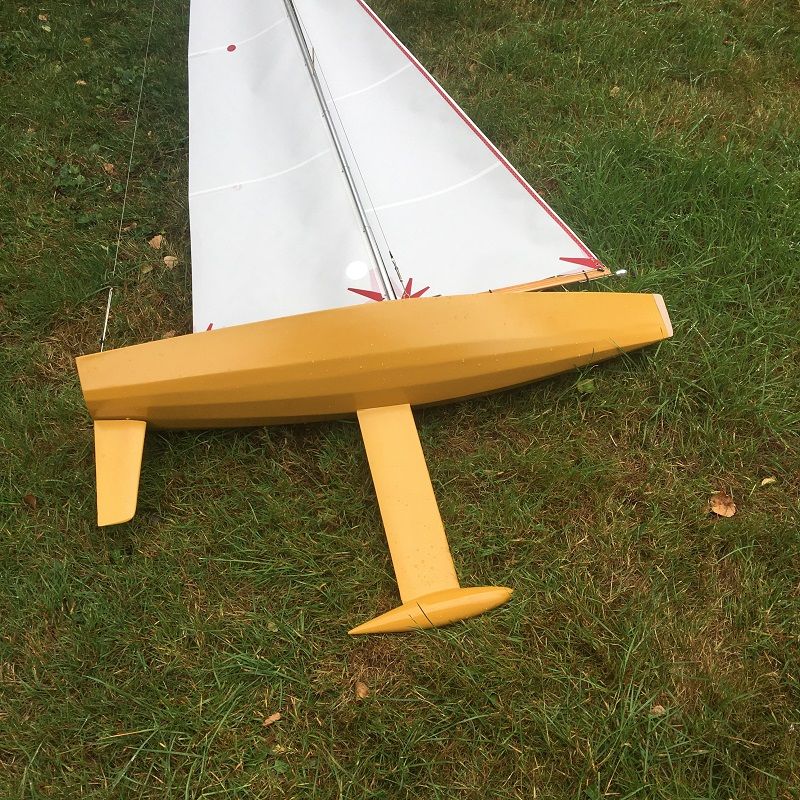

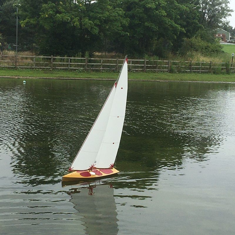

      Hi. All, just a couple of pictures of Boxkite, ready to get her bottom wet for the first time tomorrow if it's fine.
      Her multi chine hull.
      Regards.
      Eddie.

          Hi Eddie,
          She looks like a speed machine 😀 and will be good practice for the barge racing if we manage to get a race in this year ??

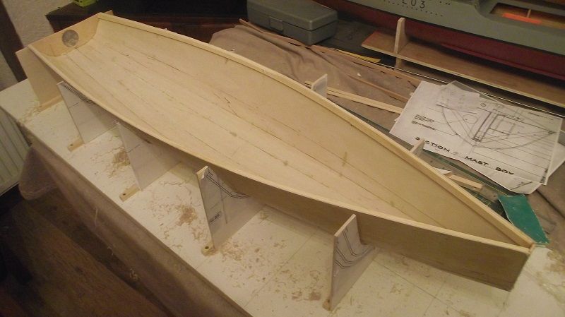

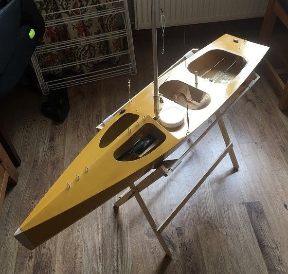

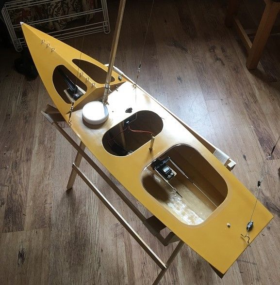

                Hi.Tim, some pictures of the internals as requested.
                The hull before any top work done, it was resin coated and a layer of 25 gram glass added, inside and outside.
                I used a lever arm servo rather than the winch drum type shown on the drawings.
                The steering sevo is suspended from two beams across the top of the hull at the gunwales, the fin box and mast box are the only conection between the deck and keel.
                Regards.
                Eddie.

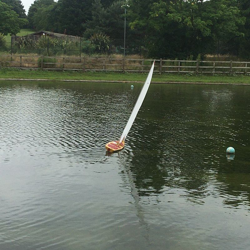

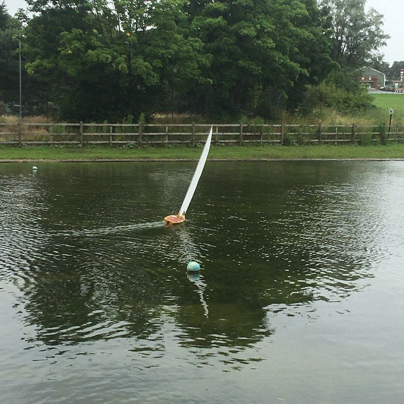

                  Had a good first time sailing with Boxkite, a bit damp at times with light winds, 0 >.5mph. very promising but the skipper needs to improvefrown
                  I took the patch off the transome to check for water, the inside was bone dry, so another bonuslaugh.
                  Regards.
                  Eddie.

                    That must have been hugely satisfying Eddie. Congratulations.
                    Tim R

                      Looks very nice on the water Eddie. Tried to give ratings on album but couldn't get it to work. Anyway, it's 5*****s from me. Inspires me to get a move on with the building.
                      George
