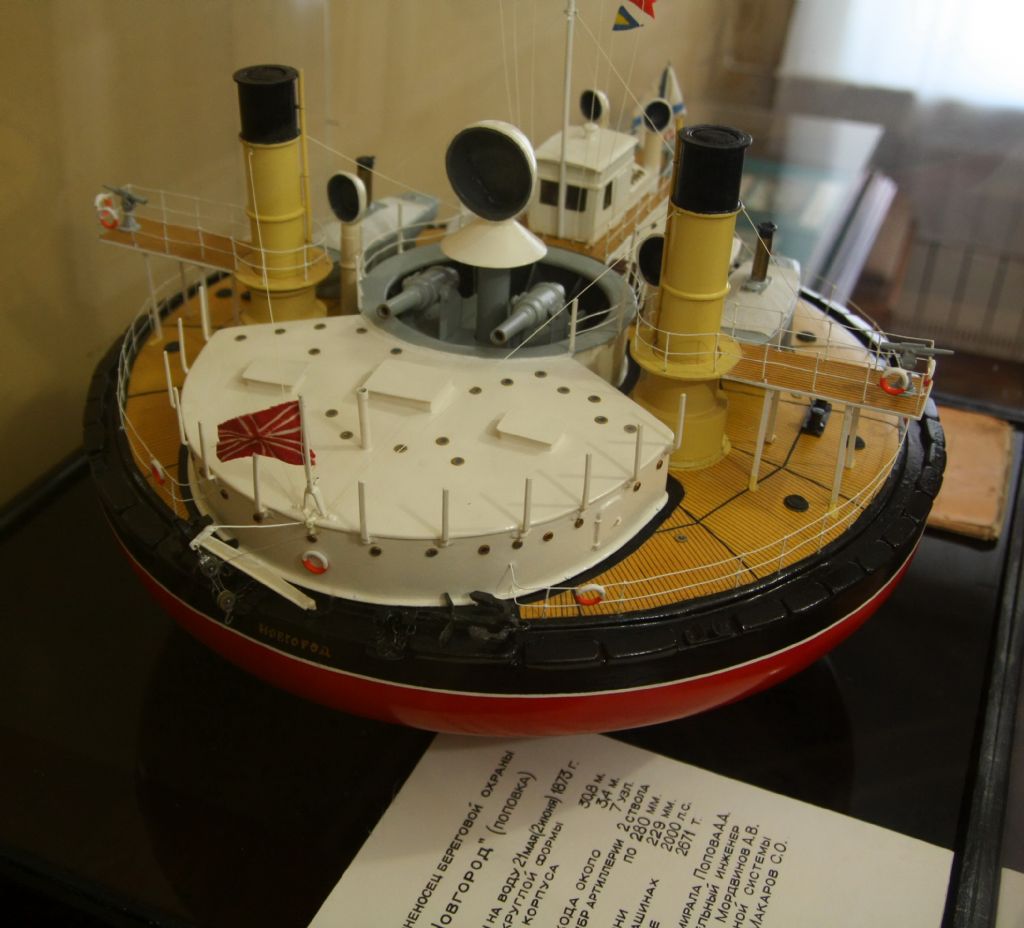

                #90207
                John W E
                  @johnwe
                  russian_monitor_novgorod_(scale_model).jpghi there
                  yes, deck planking in general does run fore and aft on the majority of sailing craft etc., but , like everything else in this world – there are 1 or 2 exceptions. Funnily enough 2 exceptions that spring to mind are The Russian round warship and also I recall seeing a model – I believe it may have been in Newcastle upon Tyne museum of a turret ship which was built in Sunderland and I am sure if my memory serves me right – there was part of the deck planking that went across the ship between the holes in the model. To be 100% certain I will have to look to see if the model is still on display – I need to find some pics of the deck and hatches.

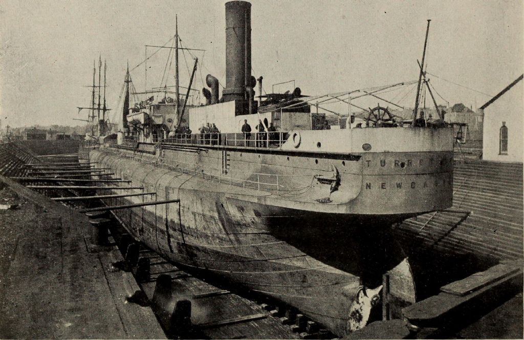

                  #90208
                  John W E
                    @johnwe
                    1920px-turret_age_(1893)_of_newcastle-upon-tyne_in_the_dry_dock_st._johns_newfoundland_in_1899_(1902)_(14793900823).jpg
                    #90209
                      Love the round Russian! It had six props or more..if memory serves.
                      My flying saucer steers quite well with its centre pump outlet and a big rudder. Wonder how the round Russian would steer with six props and…dontquote me….just the centre rudder??
                      #90212
                      gecon
                        @gecon
                        I bet Ashley will build a round Russian next week and make it plane going sideways. Or maybe just astern.

                        #90462
                        michael howarth 1
                          @michaelhowarth1
                          The round Russian is a beauty…..but what is the flag she is flying?
                          Mick
                          #90467
                            The one on what passes for the bow looks like the Imperial Russian Naval Jack.
