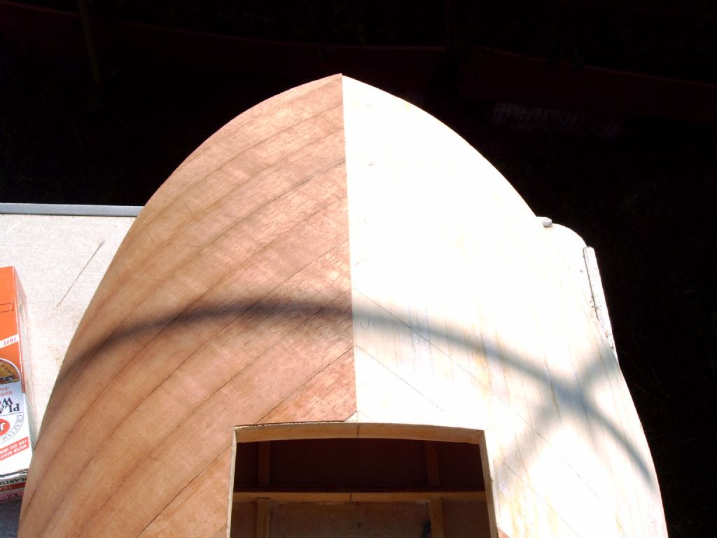

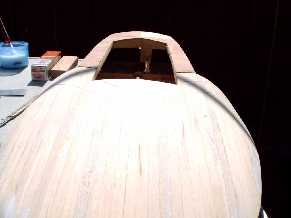

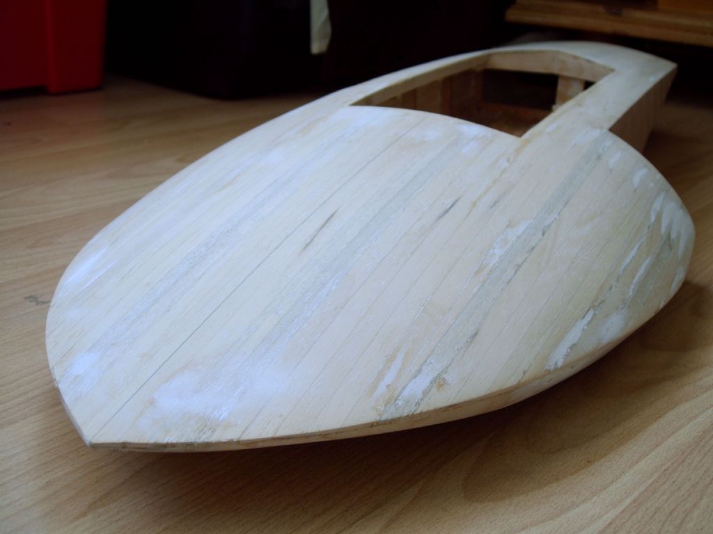

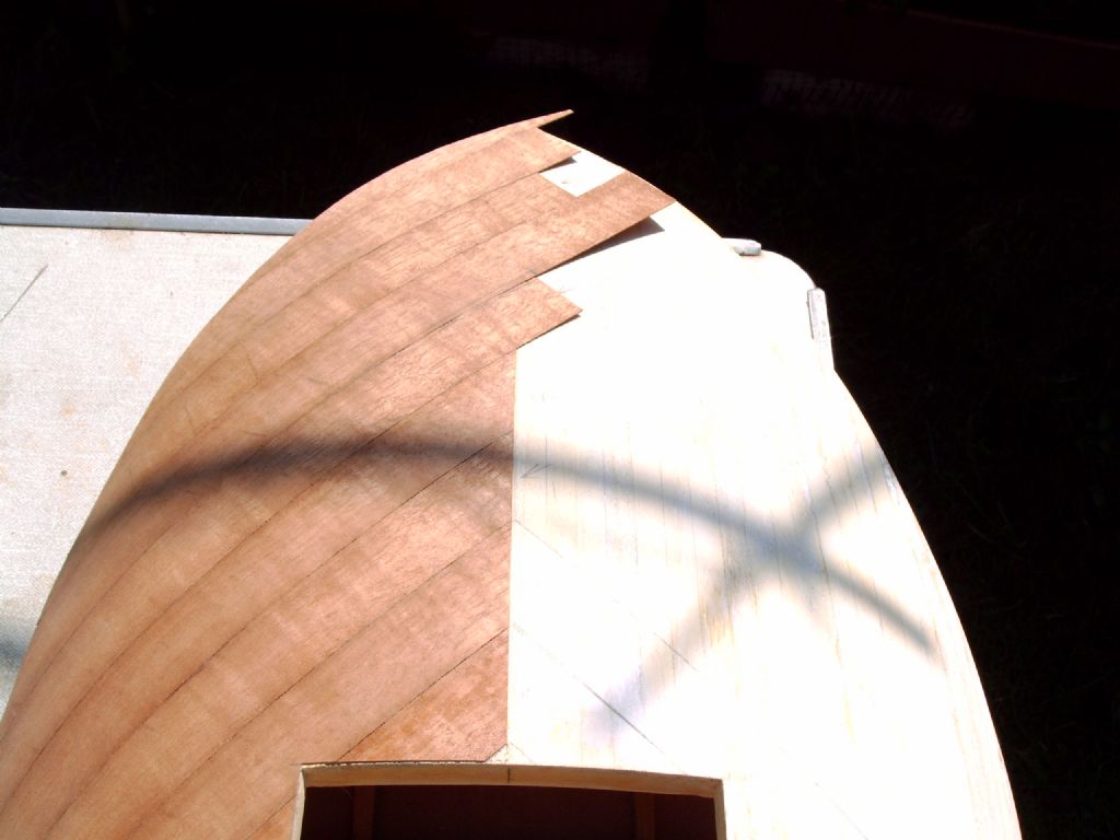

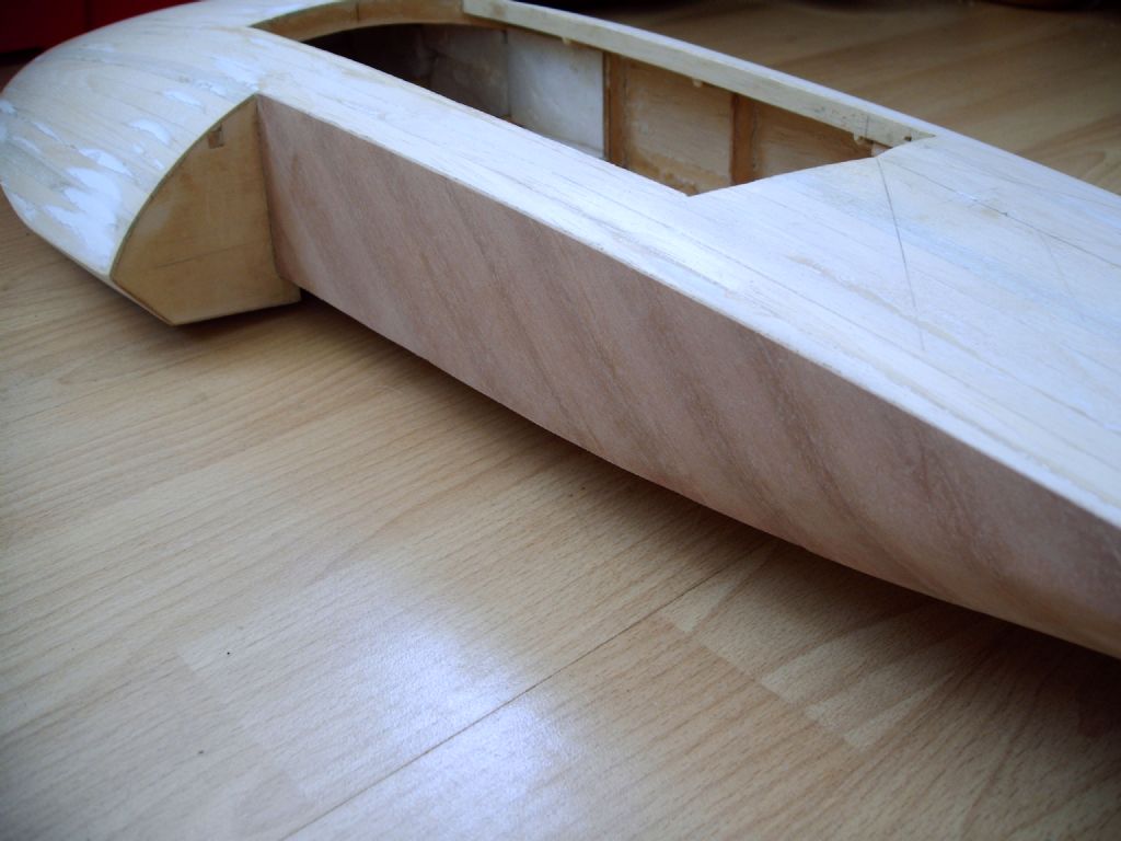

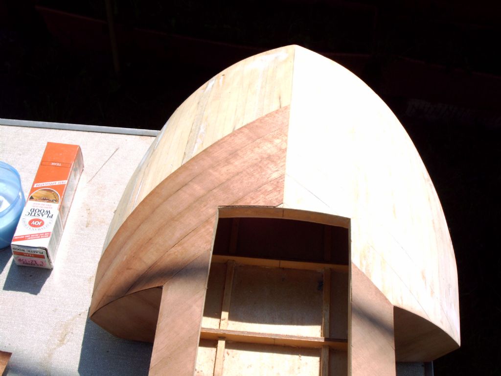

      Finally the last deck plank went on at 12 ish today!!
      That means that at 2 ish i got to trim and sand everything to shape as you see!
      Then the “aerobond” contact adhesive came out and some time later the 1st veneers are on and looking the business. Very Happy Very Happy Not as hard as I remember it in the end. although the tight bend at the back of the side walls was a challenge as  the compound curve across the bow will be!!
      the mantra is “be patient be calm work clean”
      Phil
      #26526
        Looking good,phil
        How did the new glue perform?
        #26527
        Phil Winks 1
          @philwinks1
          Like a dream Bob
           as long as one takes care to line each peice up a little slip is possible app 1/2mm to tighten joints
          then as soon as modest pressure is applied the idea of clamps vapourises.
          any excess simply rubs off the surface like that old rubber glue we used to use at school. Not that I got any on the veneer surface.
          Good scissors are an essential tool to cut the veneer with as a scalpel tends to split the back edge.
          Cutting as near to size a sposs. is also a good idea as is making all the background edges sharp prior to starting, small radii are near impossible to follow.
          Phil

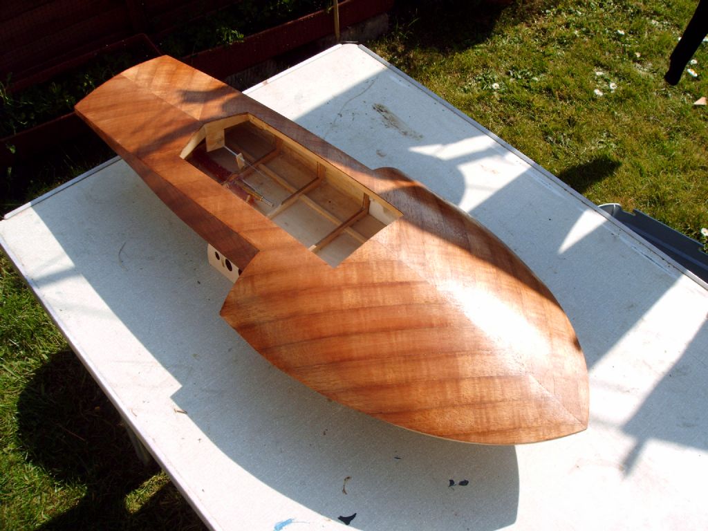

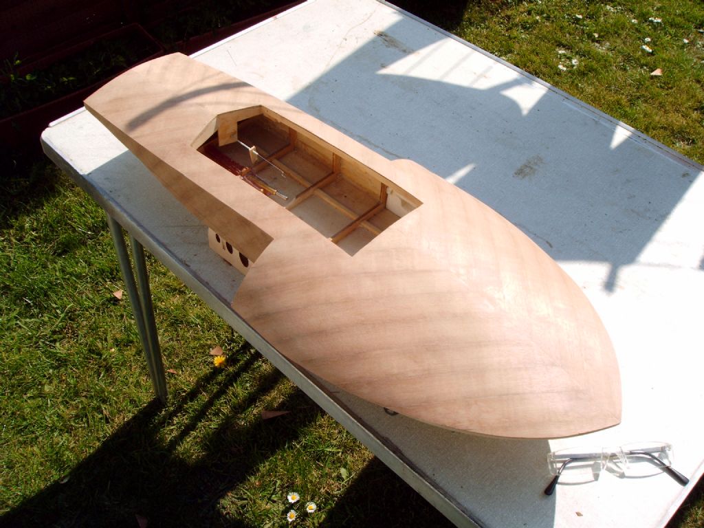

                    Had most of the day and glorious sunshine again so set up on the lawn and started veneering the deck at 9 ish this morning.
                    just look what no distractions does to the progress
                    And finally about 2 O’clock  my favourite bit of the whole process. the 1st coat of thinned yacht varnish to seal the veneer. Now we see the beauty of the wood.
                    Finally a little moan on close inspection of the veneers they are not of the quality I would’ve liked. varying thicknesses (not by much but enough) varying widths and poor edges. (not to well cut). Good job there are about 8 spare strips.
                    Phil
                    #26540
                      Hello Phil
                      My word!……….You`ve made rapid progress today!……………Looking very nice too!
                      Now then……..What does it weigh?
                      PS…Just got back from Betws-y-coed………You know it, no doubt?……Lovely day
                      #26541
                      Phil Winks 1
                        @philwinks1
                        Now there’s a question Bob ! All up including propshaft and rudder servo it’s 665g just motor,bty, esc and rx to add to that so somewhere in the 1.2kg region  unless I go for bigger bty’s then somewhere near 1.6kg hopefully that’ll be light enough and no shortage of get up and go. It’ll be interesting to see how much the paint/varnish adds to it’s weight.
                        Using that aerobond certainly made short work of the veneering and I do believe it’ll be the glue of choice for veneer in the future.
                        now to concentrate on a superb varnished finish eh

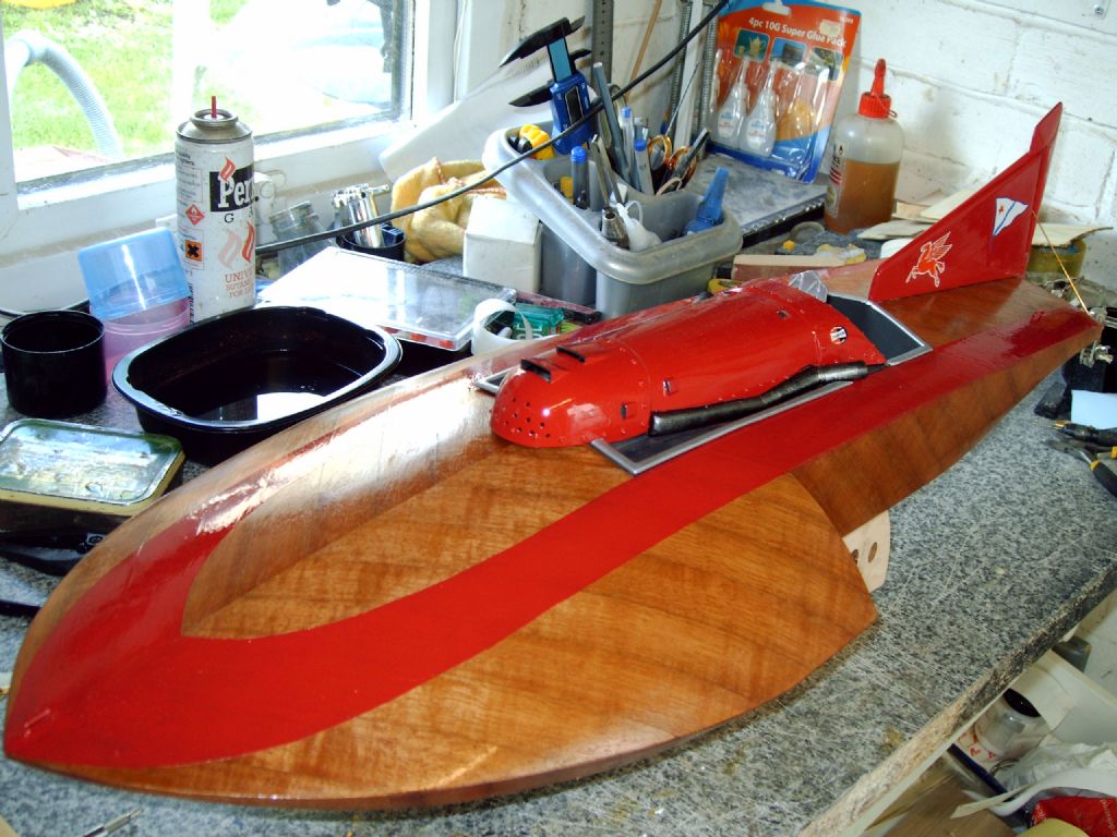

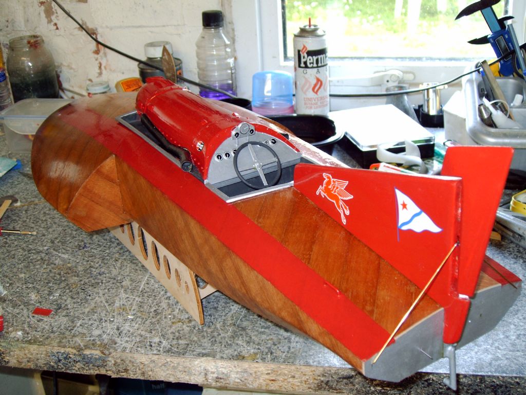

                              Not only is life looking good weight wise but the paint job is progressing steadily too
                              the fin is only dry fitted at this stage however it has a locating pin at the front and the stay wires are located into rececceses in the transome and have a central pin into the spine of the fin and it’s very solid
                              Phil
                              #26567
                                It`s looking very nice indeed!………And it`s a lovely red too!
                                Well done, Phil
                                #26569
                                Phil Winks 1
                                  @philwinks1
                                  Thanks for that Bob the red is actually Humbrol No 19 gloss.
                                  The photo doesn’t show the level of shine on the fin unfortunately, the reflection of stern grab handle’s can be clearly seen at the right angle.
                                   I think it may take me a while to get the same level of shine on the deck!
                                  1st though I intend to get the running surfaces painted the same as the transome and the ali coloured gunwhale trims fitted, then varnish the lot, as that yacht varnish I have is very clear indeed, and it should give it a pretty durable covering.
                                  Phil

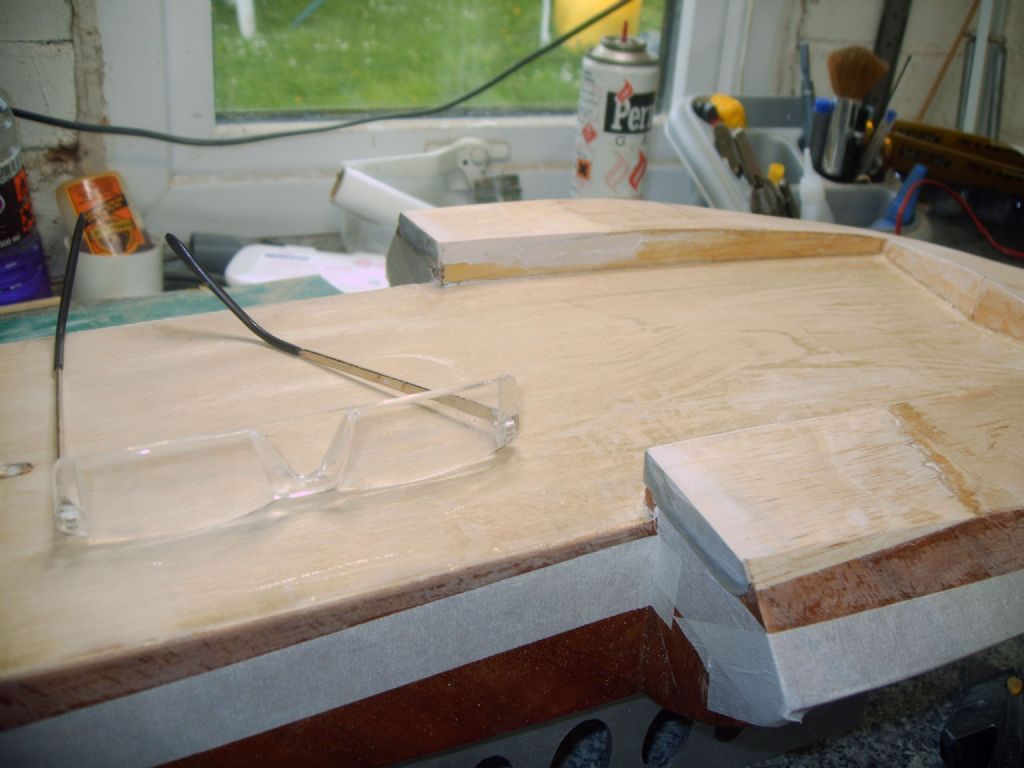

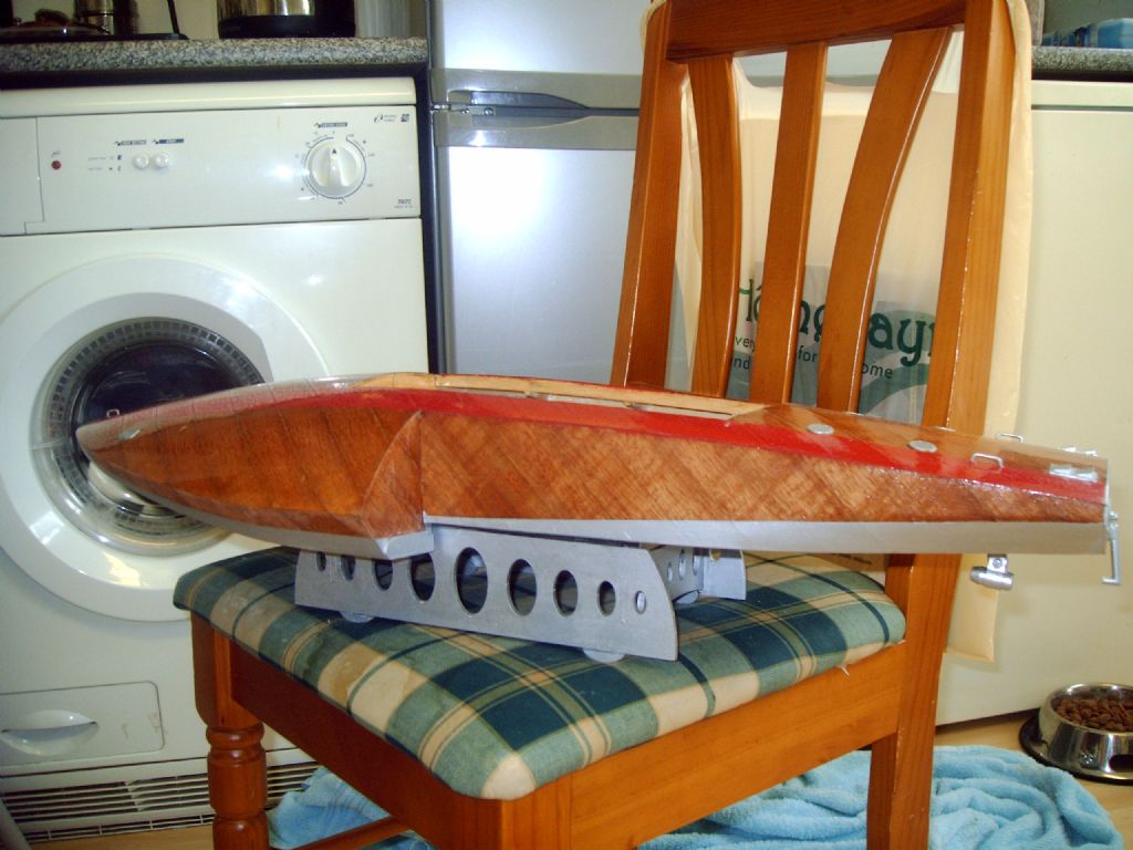

                                          Well I got some time on her at last and the incidence angle of the sponson ride pad/aftplane needed addressing.
                                          Simply sorted with a little balsa sheet
                                          after this I got the ride surfaces painted a nice silver/ali colour and now I can get on with the varnishing of the deck. this will prob take a couple of weeks as its one coat every 24hrs at most and I expect to need app 12 coats.
                                          So here goes with the 1200 wet/dry and the yacht varnish
